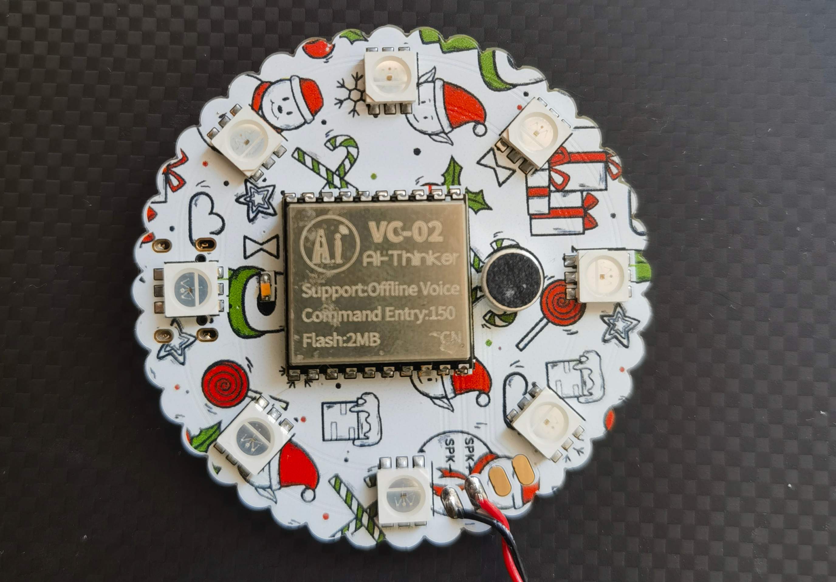

Reference Project: VC-02 Offline Voice Desk Lamp Controller
Usage Notes: Although this module is easy to use, allows for customizable entries, and does not require special tools for burning, please note! Initial firmware burning via serial port (USB) has a very high probability of bricking the device (infinite reboots), and there is only one solution---purchase an Ai-Thinker JTAJ programmer (as of the time of open source, according to feedback from group members, older chips still have this bug).
Project Introduction:
This project uses the Ai-Thinker VC-02 voice module, supports burning custom reply words, can edit "foolish and amused" entries, and control IO port operations. Module Features:
Supports Chinese and English bilingual control;
supports AEC echo cancellation and steady-state noise reduction
; supports wake-word self-learning without firmware compilation;
overall recognition rate reaches over 98%
; stable and easy-to-use cloud platform.
Project Functions:
This project uses an offline voice solution to implement existing control functions
; supports on/off colored light functions
; colored LED ring light;
fun Q&A; customizable
pin configuration.
Project Images
参考设计图片
