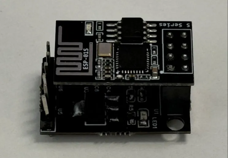

ESP-01s-MOS Switch Board
Date: July 10, 2024.

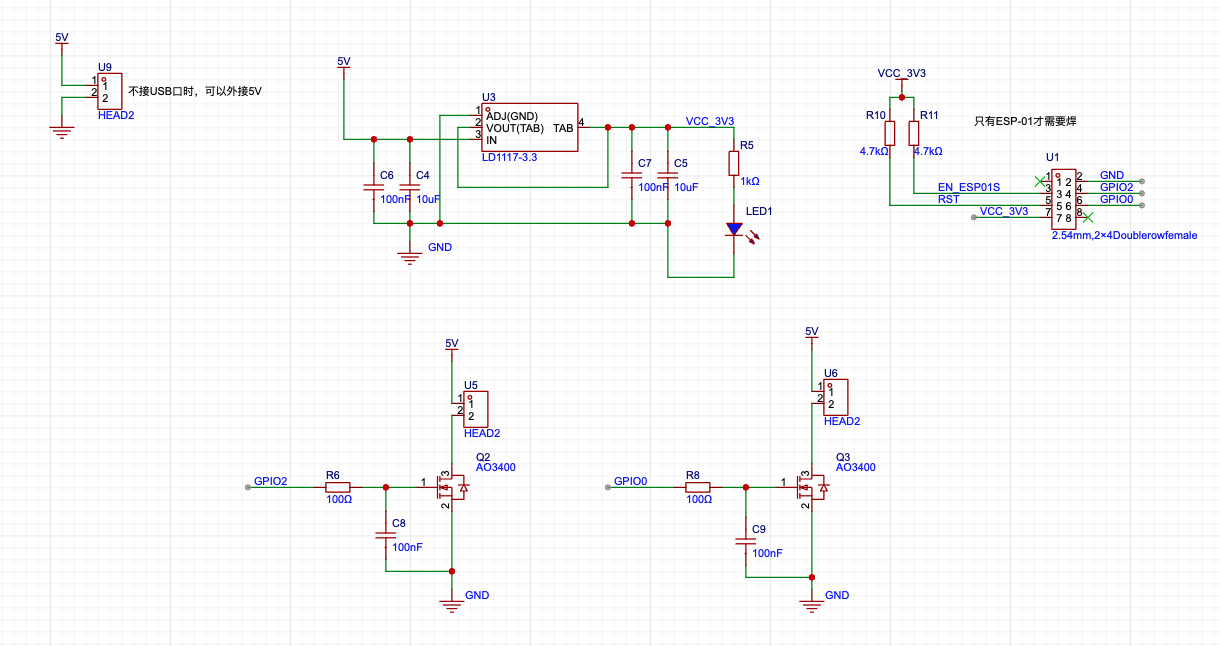

This MOS switch board is very simple; it only requires a 5V power supply to control the switch.
The output can be directly connected to a motor or LED light. The control

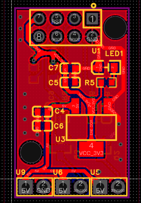

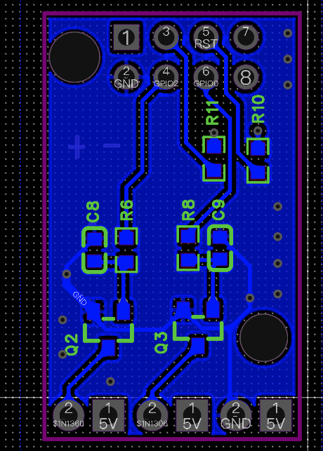

schematic is shown on the ESP-01s board. (
PCB
top and
bottom sides
are shown
