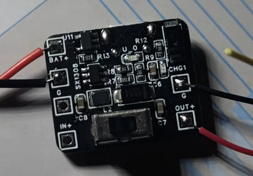

The output voltage can be adjusted by replacing the feedback resistor. It's only suitable for low-current devices due to its relatively low power.
The charging interface was previously a microUSB for convenience, but it can be changed as needed.
I used it on a Fuchs i6 remote control. The only drawback is the lack of over-discharge protection; the battery needs its own protection board to prevent over-discharge.
