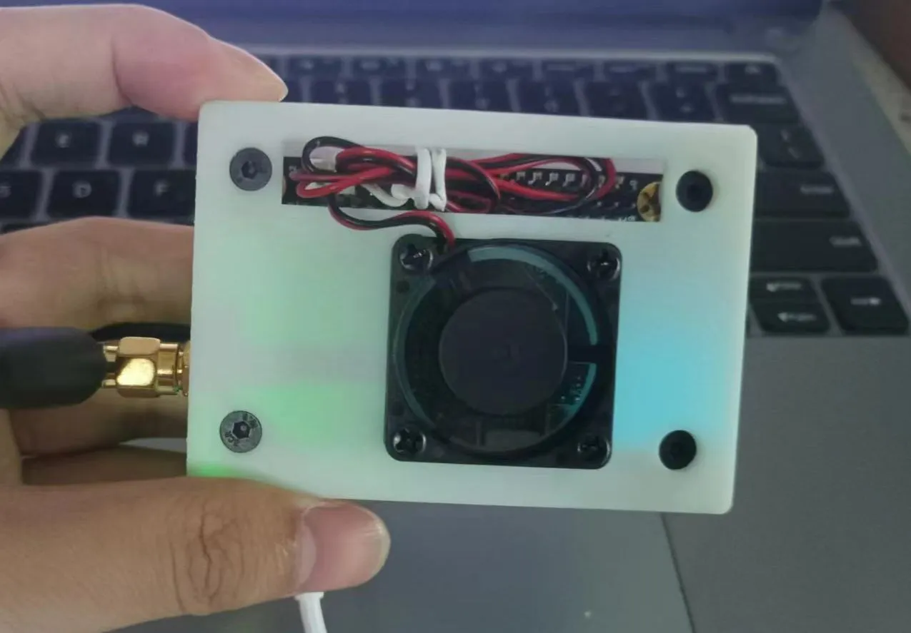

Among the many Taishanpai shells available, the only one missing is the Taishanpai active cooling shell design. Therefore, a simple shell with an attached active cooling fan was designed, and mounting holes for an external antenna are provided. Although somewhat rudimentary (no patterns), it's sufficient and prioritizes practicality. This is the Licheng EDA version; I will also create a SolidWorks 2022 version later, which is currently being printed. Once its reliability is verified, it will be open-sourced.
Physical Demonstration: Top View
, Rear
View,
Bottom View
, Right View
, Front View
, Left View
, 3D Shell Model
, EDA Internal Pattern
, External Fan Outline (30x30x7.5) .
Demo Video:
The demo video can be downloaded and previewed in the attachment.

To accommodate antenna installation, the height of the top shell of this Taishanpai shell has been increased by 12mm, bringing the total shell height to 24mm. 9000R white sanding - coarse sanding plus 5 shipping and printing costs total 14.3 yuan (excluding the following consumables).
Screws: M3 8mm (casing mounting)
, M3 12mm (small fan mounting)
, M3 nuts
, M3 studs (casing mounting)
, 3cm 5V small fan,
IPEX 1st generation
antenna consumables detailed introduction.
