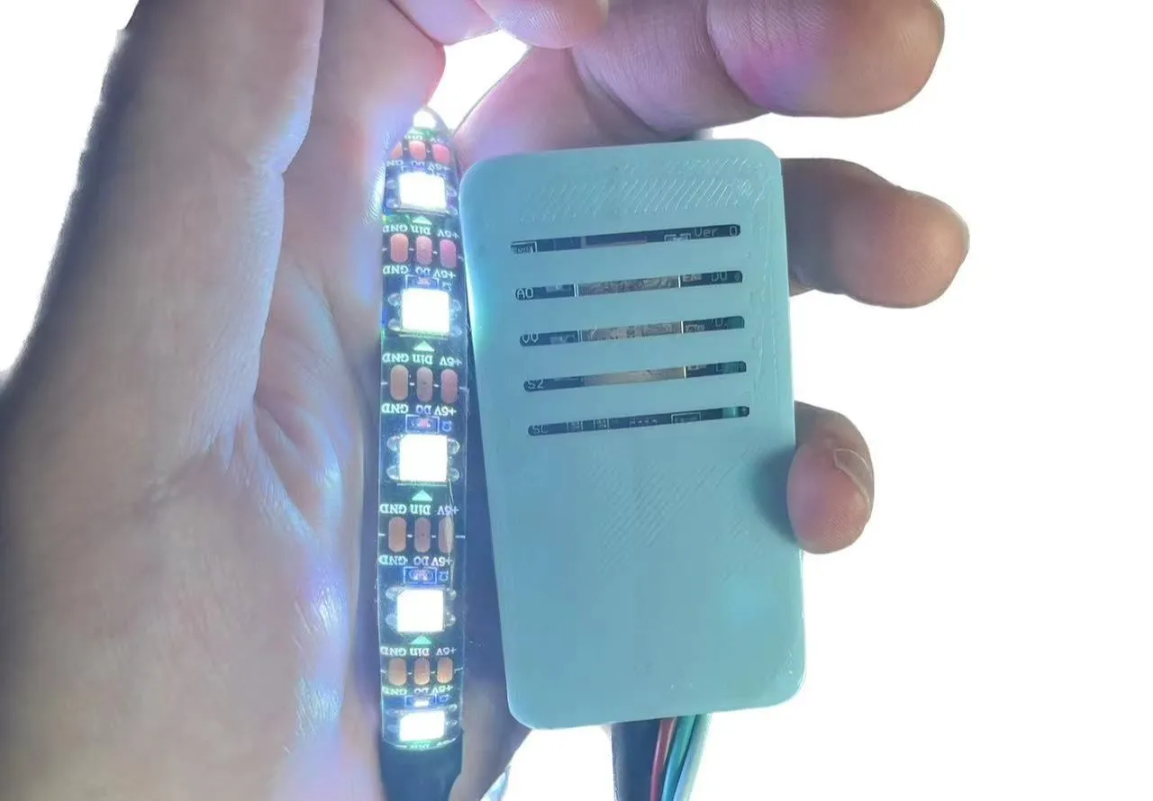

Xiao Ai ambient light strip

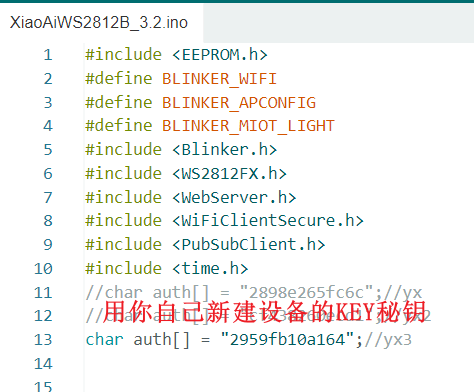

Open the XiaoAiWS2812B_3.0.ino project using the Arduino IDE, select NodeMCU 1.0 for programming, and modify the key as needed.
See the attached manual for details!
