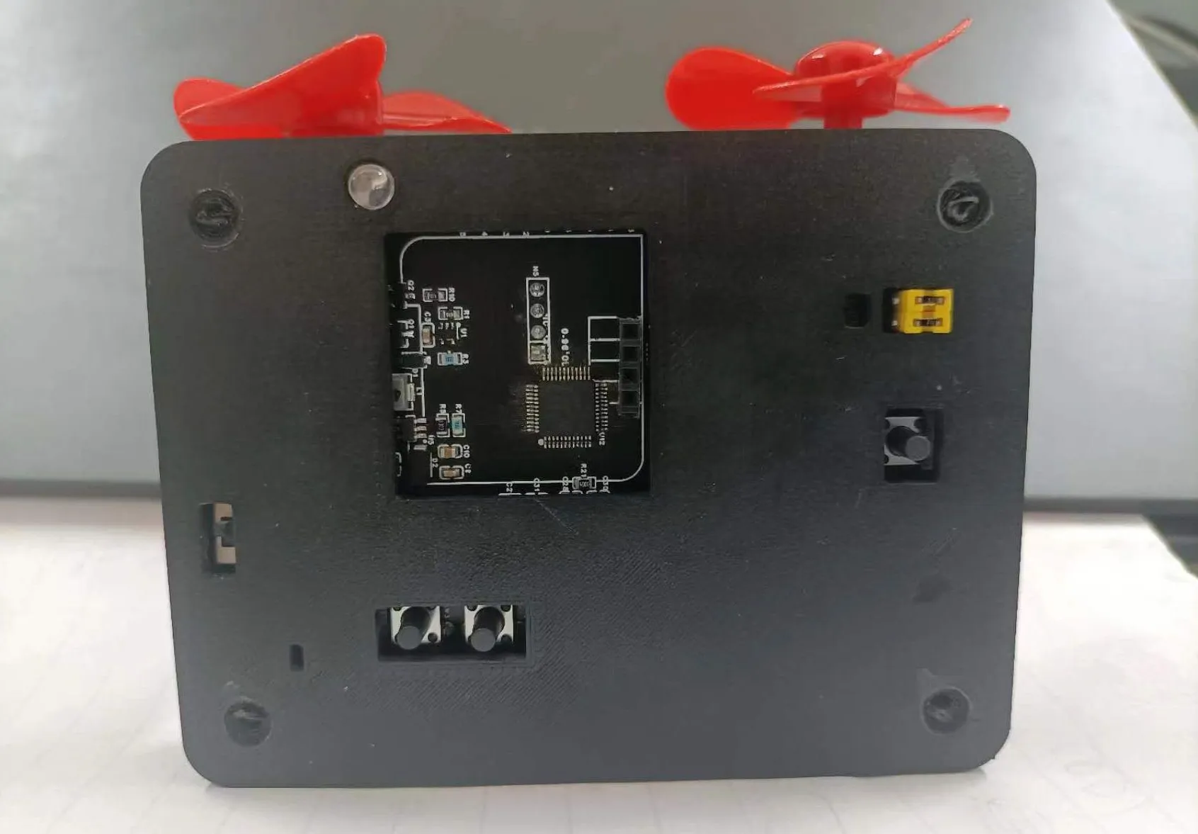

A powerful mini fan based on an STM32 dual-drive speed-adjustable DC motor.

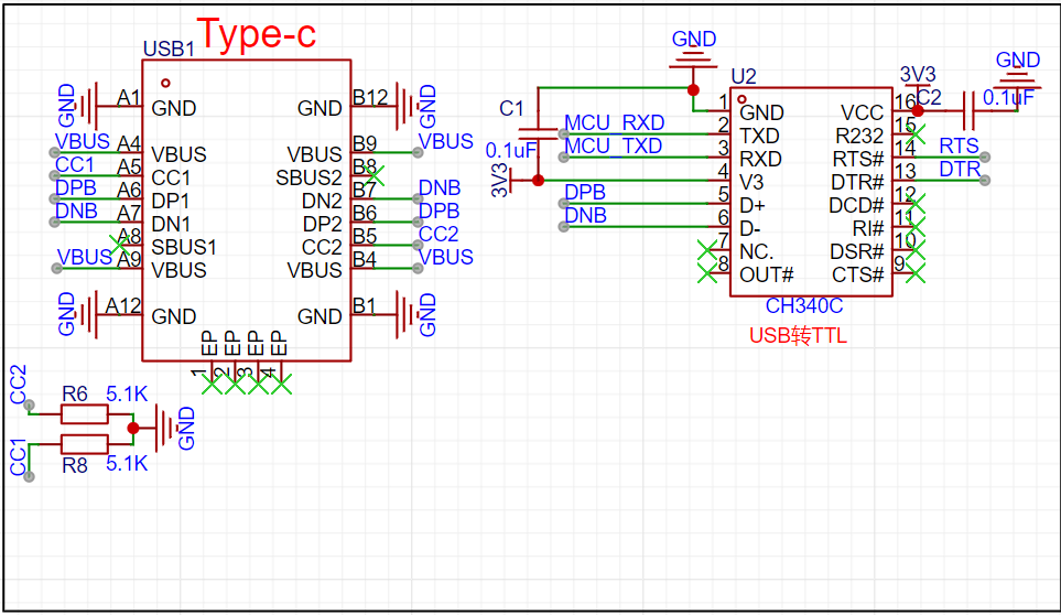

1. 16-Pin Type-C Circuit:
This Type-C circuit can power the entire circuit via VBUS and also perform serial communication for program downloading.

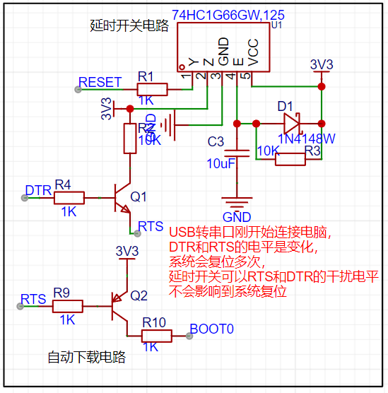

2. Automatic Download Circuit:
I added a delay switch circuit to the automatic download circuit. When the USB-to-serial adapter is first connected to the computer, the DTR and RTS levels change, causing the system to reset multiple times. The delay switch prevents interference levels in RTS and DTR from affecting the system reset.

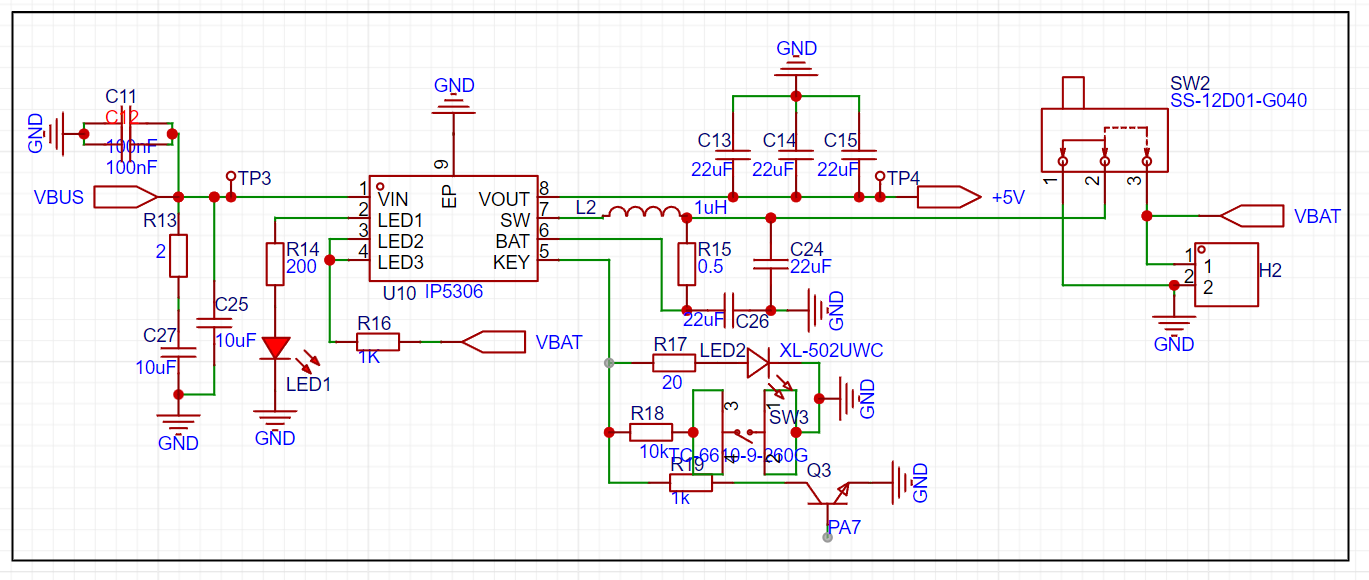

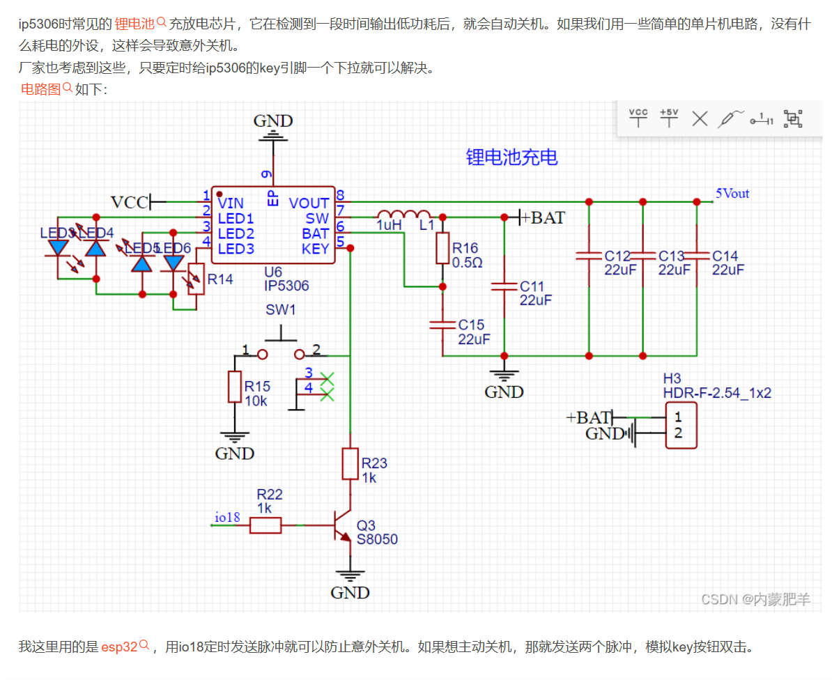

3. IP5306 Power Bank Circuit
: The IP5306 requires very few external components, effectively reducing the overall solution size and BOM cost. The IP5306 only needs one inductor to achieve buck and boost functions, supporting low-cost inductors and capacitors. The IP5306's synchronous boost system provides a maximum output current of 2.4A with a conversion efficiency of up to 92%. Under no-load conditions, it automatically enters sleep mode, with the quiescent current dropping to 100uA. Considering the potential sleep issue of the IP5306, I referenced a design from an online blogger and added a GPIO port to continuously wake up the chip, preventing it from going into sleep mode. Reference blog link: Preventing IP5306 from automatically shutting down in low power consumption_IP5306 output stops after 30 seconds - CSDN blog

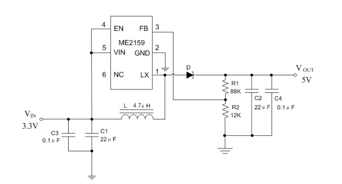

The peripheral circuit of the original chip manual for the ME2159 DC/DC boost circuit is as follows.
The inductor selection for this circuit must be a power inductor, and the package is preferably 0603. The chip has a precision feedback reference voltage of 0.6V, a reference voltage accuracy of ±2%, an adjustable output of up to 12V, and an internal fixed PWM frequency of 650KHz. It is important to note that the adjustable output voltage is calculated using the resistance values ​​of R1 and R2. The output voltage formula is as follows:

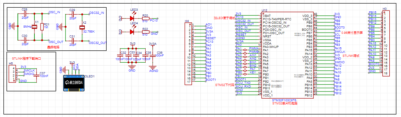

Buck circuit 6. Microcontroller circuit

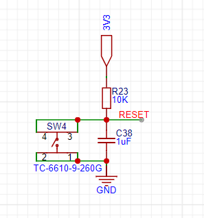

7. Reset circuit
