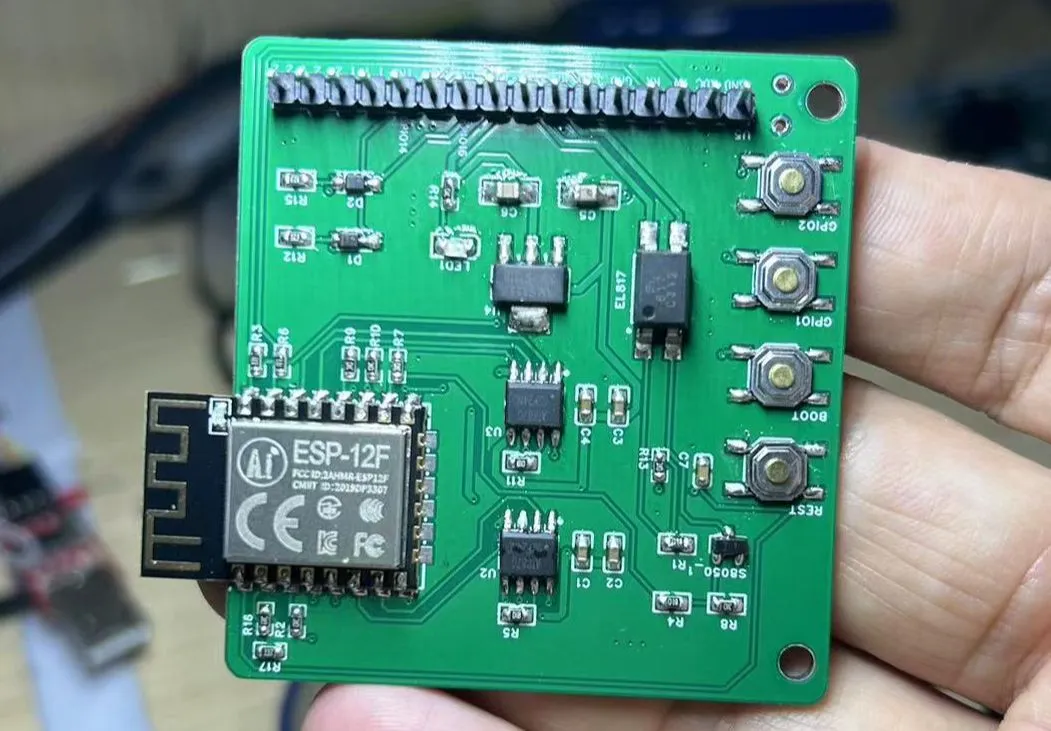

The board, installed at the bedroom window, controls two motors and has one infrared path for turning on the air conditioner and other infrared devices (or for remotely powering on a computer; the unsoldered component in the diagram is an optocoupler, which can be used to power on the computer).
Application scenarios: 1. Opening curtains via a mobile app (smart speaker); 2. Opening windows via a mobile app (smart speaker); 3. Turning on/off the air conditioner via a mobile app (smart speaker).
2. Controlling a magnetic water switch for automatic watering of plants; 2. Controlling a magnetic water switch for automatic water filling of a dishwasher (modification of a manually filled dishwasher).
3. One optocoupler for remotely turning on/off a computer.
The board has been verified and works normally. Some interface designs are not ideal and will be improved later. The following code implements opening and closing the curtains and specifying their position; other functions are under development. The curtain software development has also been tested. It can be directly installed and used with any roller blind using the following curtain structure after printing the outer casing.
Currently, this code implements opening and closing the curtains and specifying their position. It has been used for half a month and functions normally. The server uses Baffa Cloud (https://cloud.bemfa.com/).

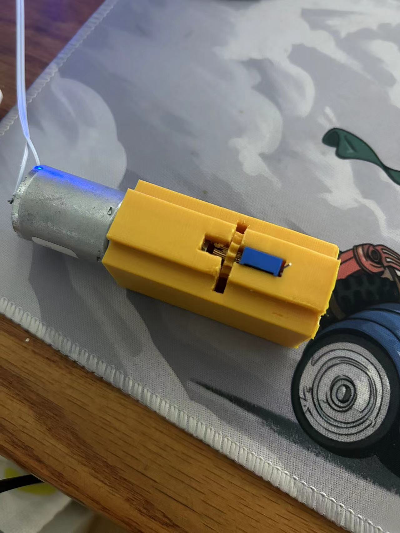

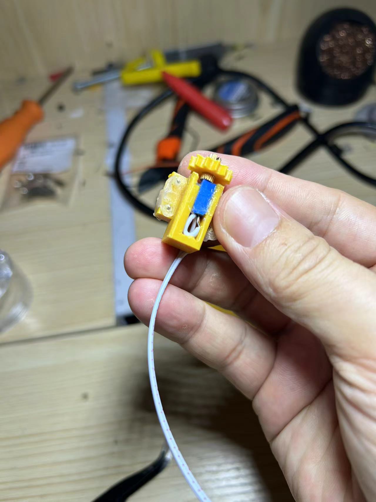

The power supply uses a 6V-12V input, depending on the motor's operating voltage. I used a 12 RPM motor; see the image below for details on purchasing one online. If you have a spare router power supply, you can use that. Because the AMS1117 manual states a maximum input of 18V, a 12V input can cause significant overheating if the microcontroller is in network configuration mode.
A copper wire can be soldered to the head to improve heat dissipation. This solution has been used for over half a month, with three curtains installed, and has not experienced any crashes, so it should be considered stable.

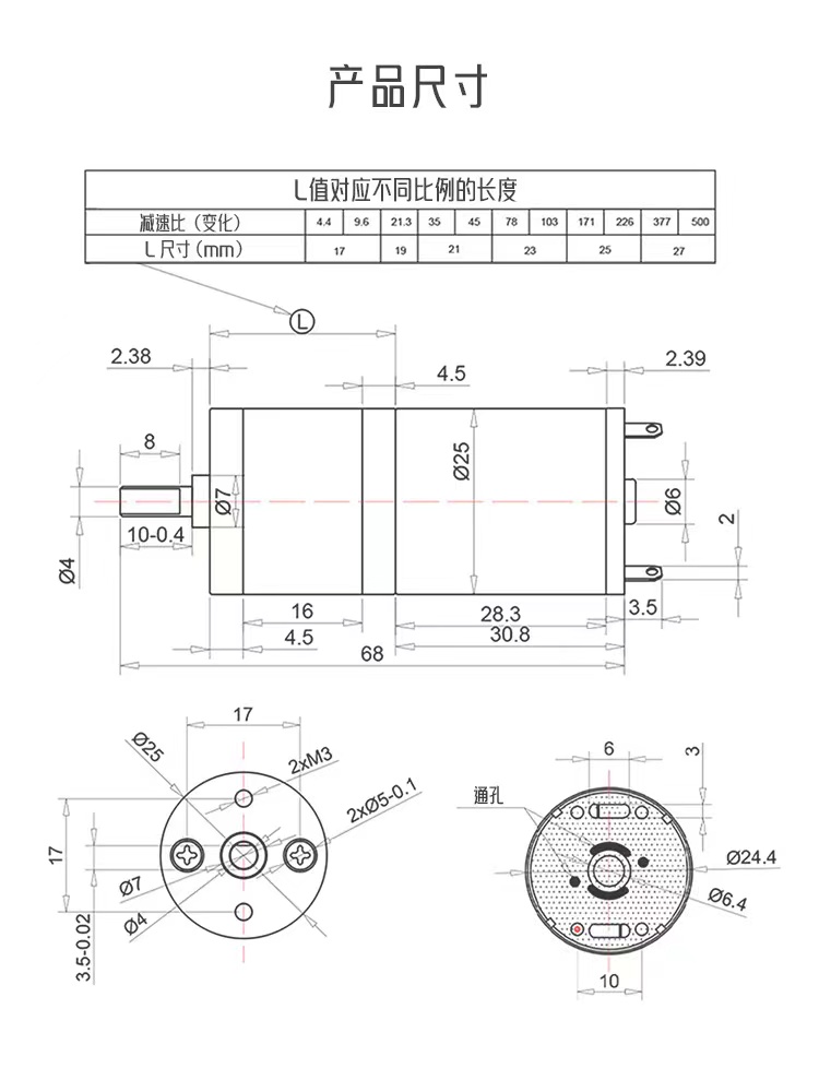

The motor dimensions are shown in the image below.

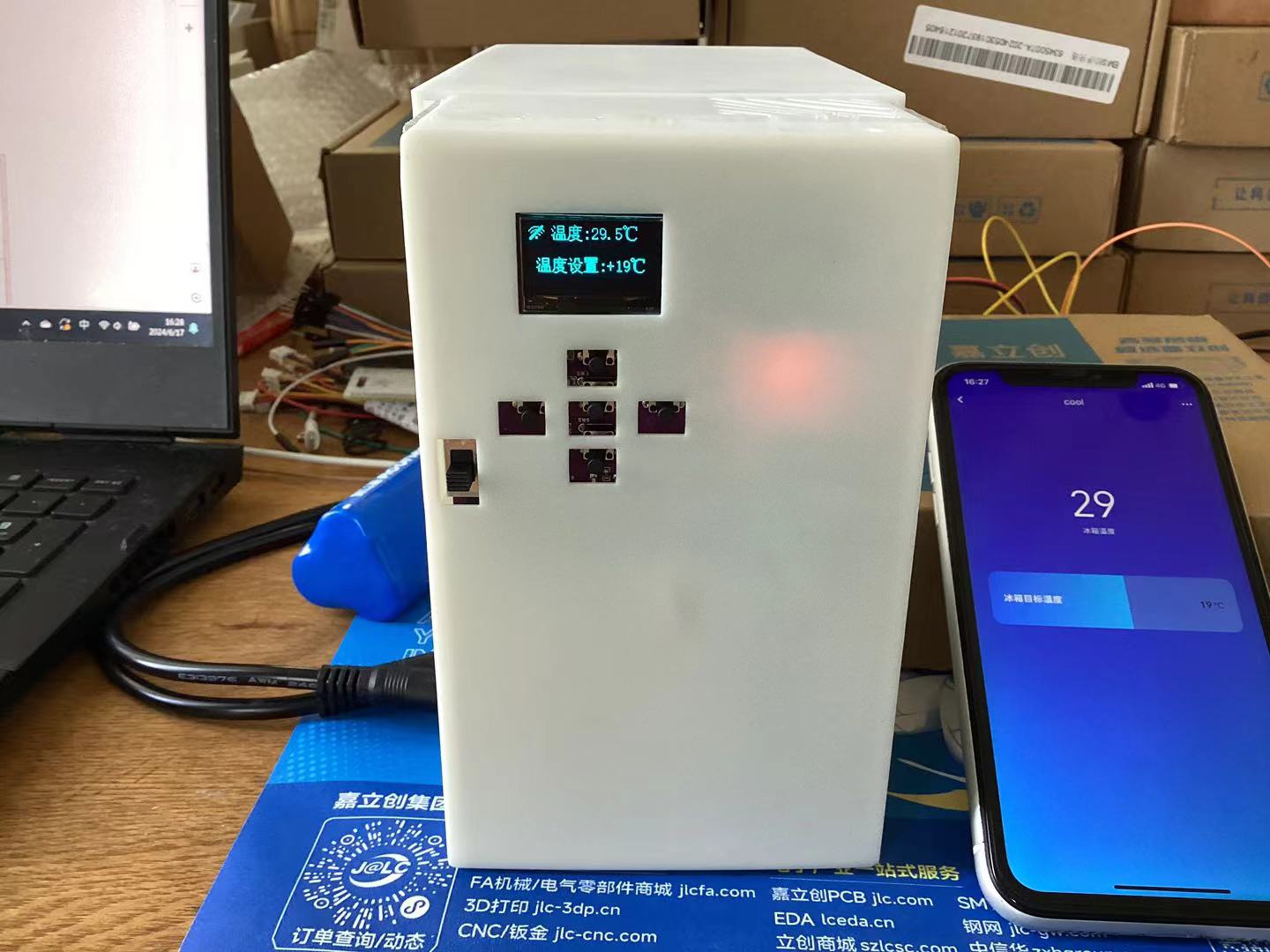

Smart Mini Refrigerator
Using an STM32 as the main controller, along with an IoT Wi-Fi module, a DS18B20 temperature sensor, and the duty cycle of the STM32's output PWM, the operating status of the MOSFET and the cooling chip can be controlled remotely to achieve temperature control of the mini-fridge.
  Summer is here again, and if you want to enjoy an ice-cold cola anytime while you're out, a portable mini-fridge can make all the difference.
System Design
: Main Controller: STM32 Microcontroller. The
         STM32 microcontroller serves as the main controller, responsible for the logic control and data processing of the entire system.
IoT Module: Wi-Fi.
         The ESP8266 Wi-Fi module enables remote communication, allowing users to control the mini-fridge remotely via their mobile phones.
Temperature Sensor: DS18B20
         . The DS18B20 is a digital temperature sensor that communicates via a dedicated bus and can accurately measure ambient temperature.
PWM Control of the Cooler
         : The STM32's PWM output controls the MOSFET, thereby controlling the operating state of the cooler (such as a Peltier chip). By adjusting the PWM duty cycle, the cooling capacity of the cooler can be precisely controlled.
Hardware
Power Supply: 18650 Lithium Battery
          . The 18650 lithium battery provides portable power for the mini-fridge control system.

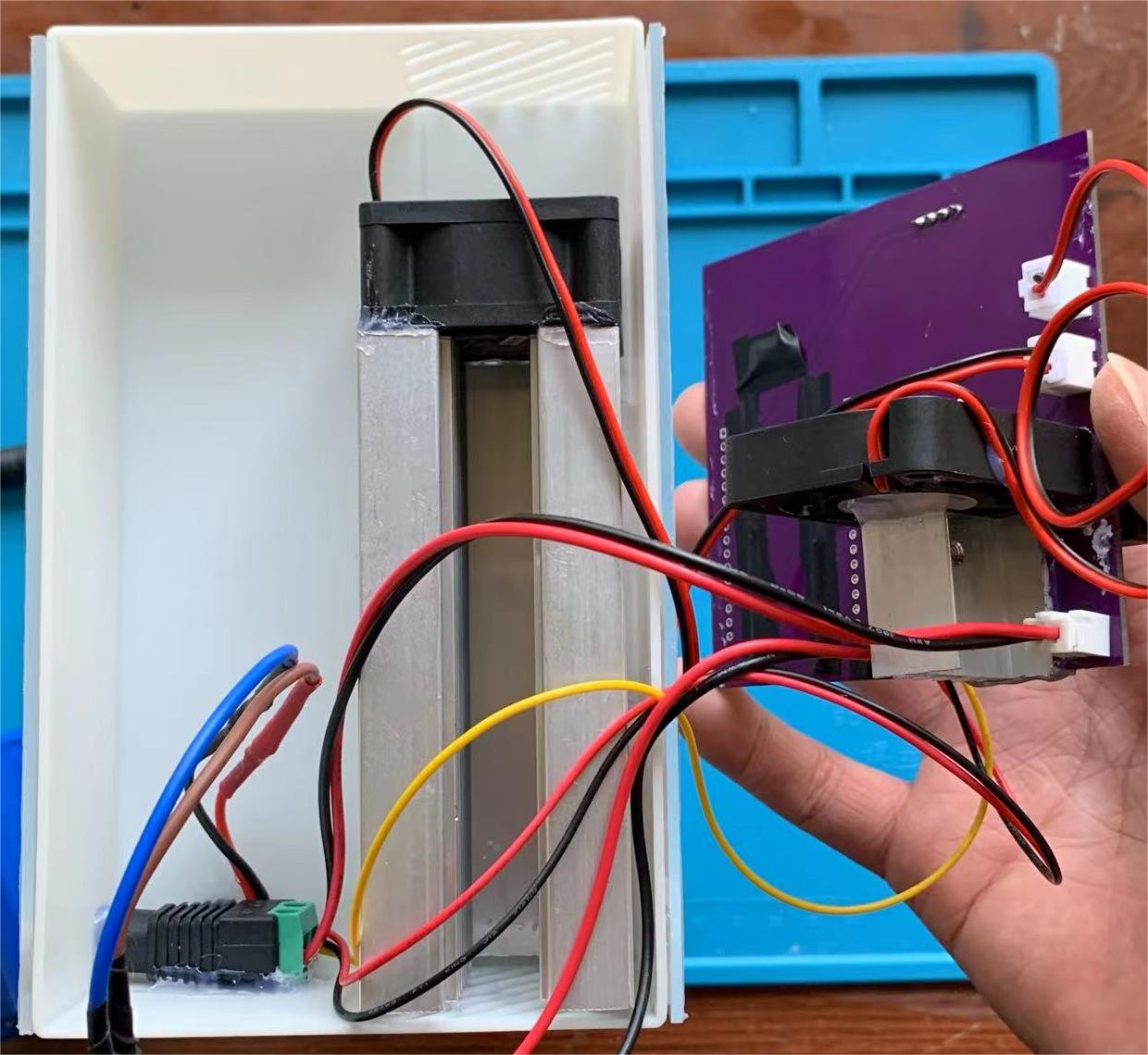

The remaining components
          use hot melt adhesive, acrylic sheets, 2.54*2p and 3p terminals, a 1.5cm high 6*6 high button, a
          4*4*10cm heatsink and a 4*4*4 cooling fin for the 5V cooling chip, two 4*4cm 5V small fans for cooling the step-down chip, and a 1.5*2.5*3cm heatsink for cooling the chip.
The actual steps are shown in
the internal picture; proper heat dissipation is crucial.

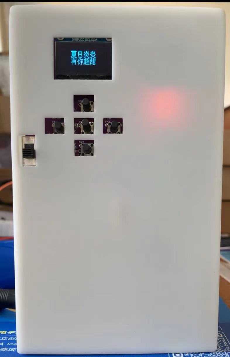

      2. This is the power-on screen.

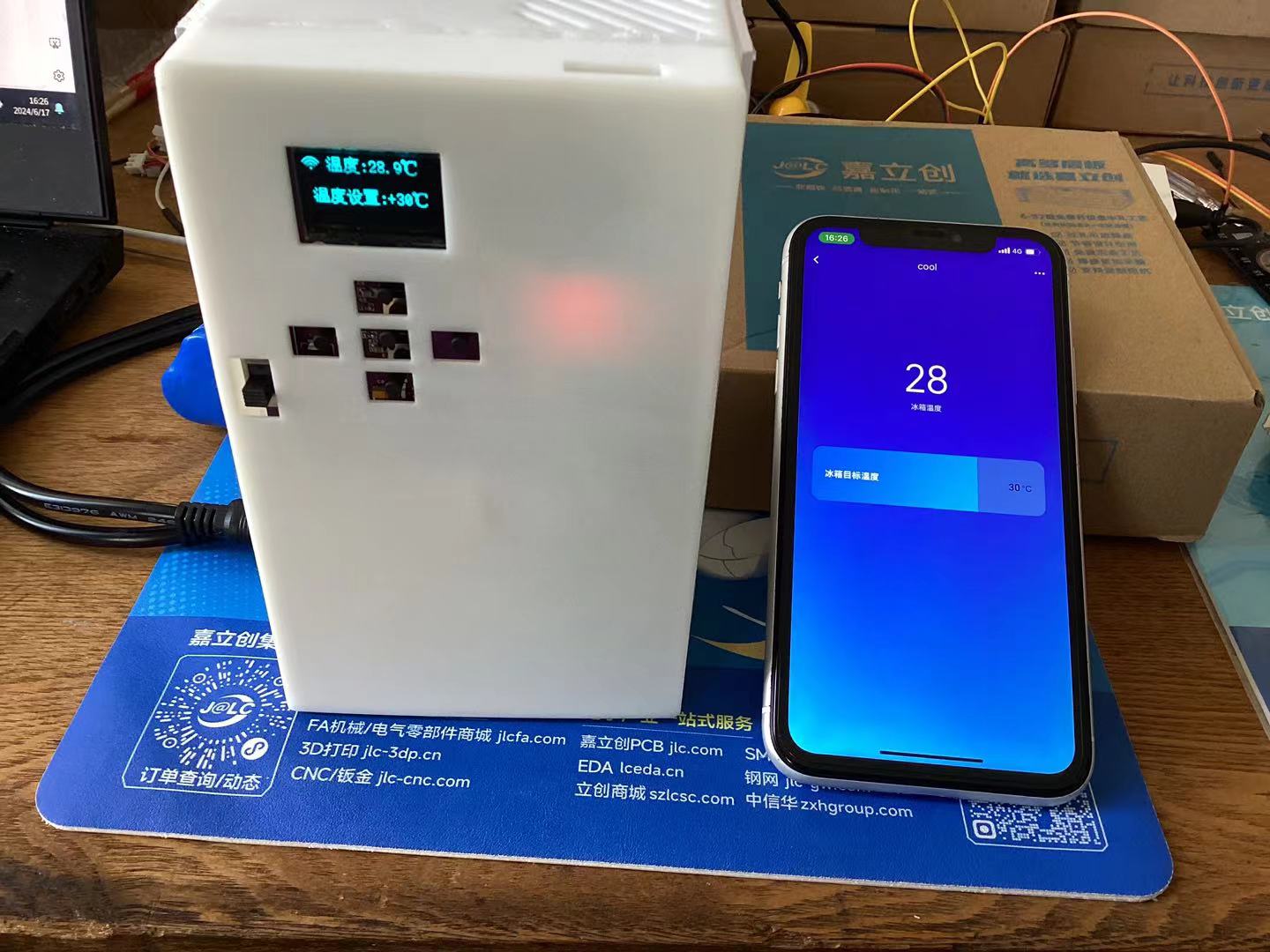

      3. When powered on, a Wi-Fi icon appears in the upper right corner, indicating a network connection. The target temperature can be set via buttons or a mobile phone. The phone also displays the current refrigerator temperature. When the refrigerator temperature is higher than the target temperature, the STM32 controls the PWM output to control the PMOS transistor, enabling the cooling chip to work. When the temperature is lower than the target temperature, the cooling chip stops working.
     4. When the Wi-Fi icon in the upper right corner shows a "/", it means no device is connected to the Alibaba Cloud platform, and the target temperature cannot be controlled via the mobile app. In this case, the target temperature can only be set via a button. Similarly, the STM32 controls the PMOS transistor to operate the cooling chip by controlling the PWM output.

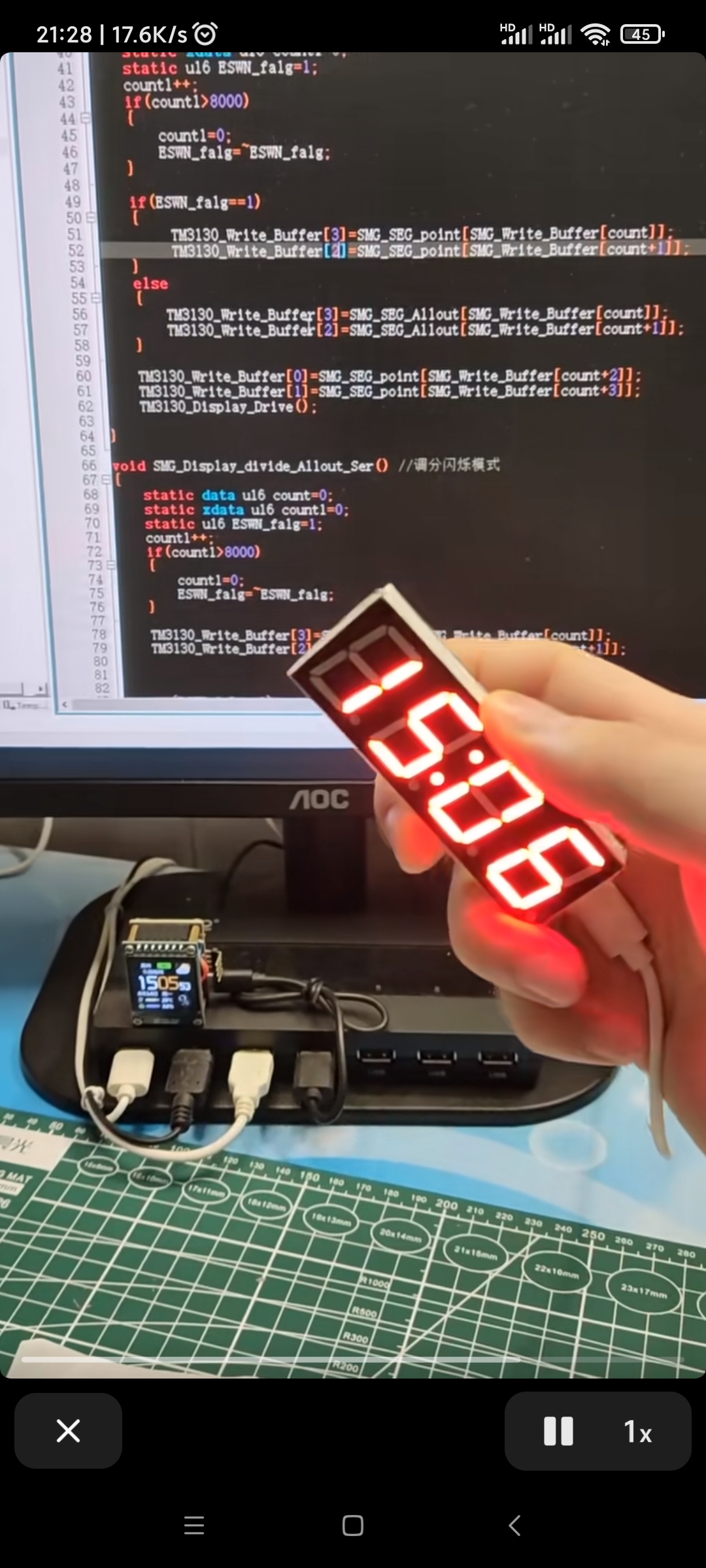

0.8-inch TM3130 Desktop Electronic Clock and Thermometer
0.4-inch desktop electronic clock and thermometer
//The source code and PCB layout for the above projects are publicly available. Search "Qiqi Loves Microcontrollers" on the "LCSC Open Source Hardware Platform".// Microcontroller model: STC8G1K08 1. When programming, be sure to select built-in IRC=30MHz. 2. Set the reset pin to the IO port. 3. Uncheck the option to erase the user EEPROM area when downloading the user program.
/*No technical support provided, just sharing for fun. This is an open-source blogger's work; it is for use only
and not for commercial purposes. Questions can be discussed in the comments section below. Designer of this solution: Qiqi Douyin: The Cutest Qiqi in the Universe Kuaishou ID: Qiqi Loves Microcontrollers Bilibili: Qiqi Loves Microcontrollers QQ: 1715755109 (For custom microcontroller programs and PCB designs, add as a friend and note your purpose; paid design, serious inquiries only). QQ Group: 499067314 (Welcome all microcontroller enthusiasts to join the group; group files are available for free download.)

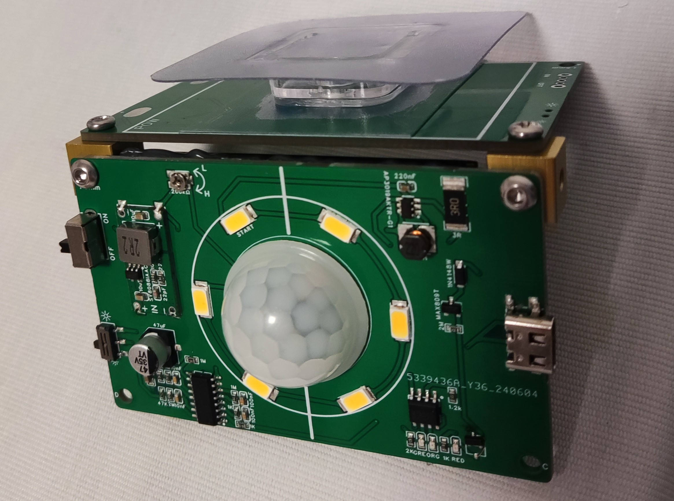

Summary: This project utilizes a D204S infrared sensor head, controlled by a BISS0001 main controller, to turn six 5730 LEDs on and off, achieving a human body detection lighting function.
Reference project: https://oshwhub.com/wzw666/chong-dian-gan-ying-xiao-ye-deng
Project overview

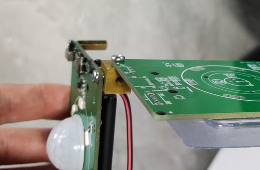

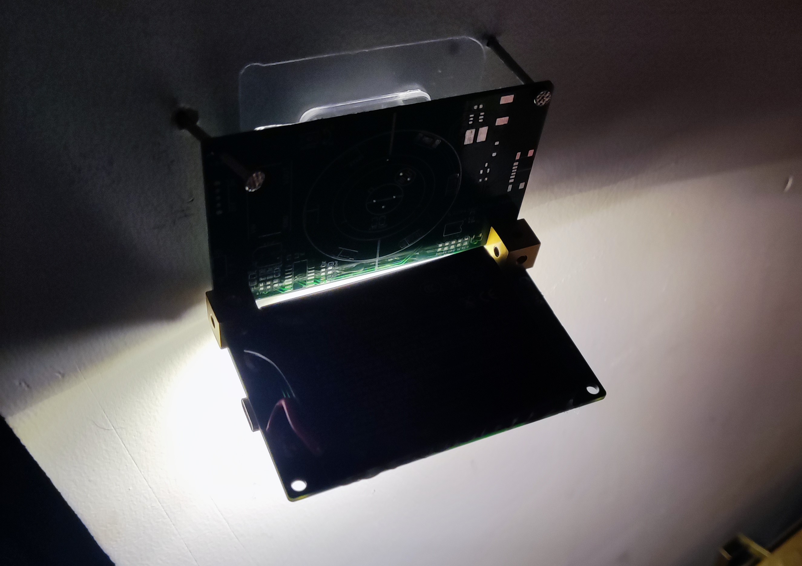

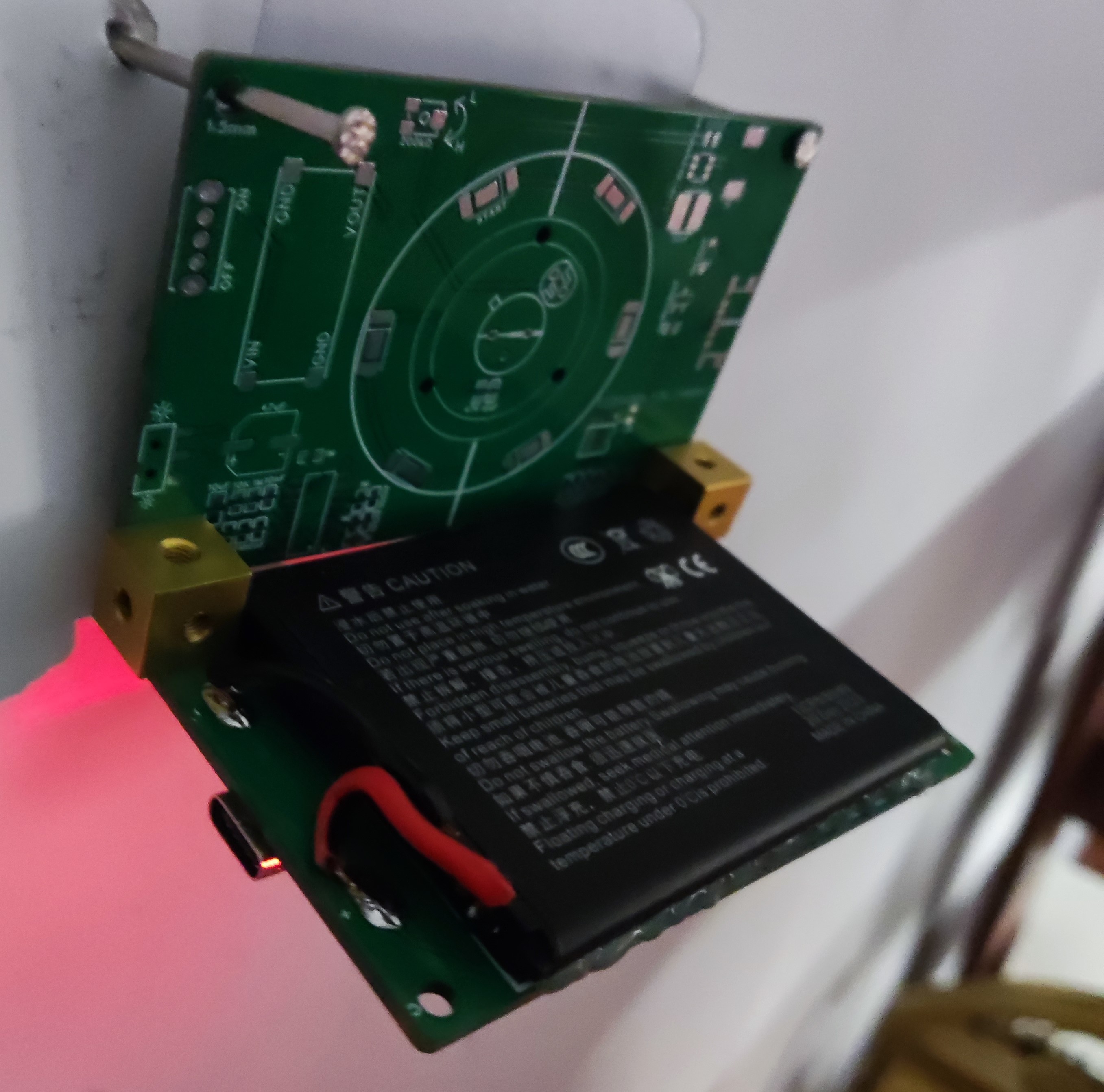

and appearance illustration. A combination of square nuts allows for 90-degree wall mounting. The red light indicates low battery . The square nut usage
illustration shows that a copper pillar can be used to elevate the back when 90-degree wall mounting is not required. Battery Precautions (Important): Use polymer batteries, with dimensions less than 63 * 50 mm. I cannot provide a purchase link; these were found elsewhere. Polymer batteries within this size range can be used. (Important) The power supply uses a SY8088AAC switching power supply chip, which is stacked on this board and cannot be purchased elsewhere!! (You can draw your own or use a voltage regulator chip). Do not directly connect a lithium battery to the main controller or infrared sensor. The unstable voltage of the lithium battery will definitely cause the infrared sensor to falsely trigger . The D204S is extremely easy to damage. Minimize soldering time. During soldering, it should be suspended 4mm away from the PCB; otherwise, it is easy to falsely trigger the low battery warning and the power will not disconnect when the main switch is turned off, causing a short circuit. The cost is around 10 RMB, plus the battery (I considered the battery as a find). The sensor and chip are relatively expensive . The LED color temperature can be adjusted. My mother likes white, but I prefer 4000k warm light. The hole size on the board is 1.5mm, and the radius is M3. Note this when purchasing (not important). The 4054 series can also be used for charging. I used it on a previous board; it charged at 3000mA overnight and the sky was already bright... (Not important) The large switch is the main power switch, and the small switch is for selecting the single-time light-on strategy; the headlight icon will remain constantly lit if triggered within n seconds (15 seconds in this solution); the small light icon will definitely turn off after n seconds, and the infrared probe signal will be read again after 1~2 seconds of signal stop. Materials not mentioned in the guide are available on Taobao and WeChat. Brand new PIR pyroelectric human infrared sensors D203S D203B D204S D204B D205B original ¥1.71; LED driver AP3019AKTR-G1; DIODES (US/Taiwan) SOT-23-6 silkscreen GAS brand new free shipping ¥0.5; Human body sensor BISS0001 UMW (Taiwanese semiconductor) SOP-16 universal infrared pyroelectric ¥0.5; M3M4/5/6/8 aluminum alloy six-sided three-way nut screw hole colored connecting block chassis shock-absorbing feet; DIY salvaged battery (reference link). 6. Strong waterproof bathroom adhesive multi-functional traceless snap-on clip for fixing power strips without drilling ¥4.5 TODO LIST Using nuts and nuts is just to avoid drawing the outer casing; I'll draw it when I have time... placeholder
