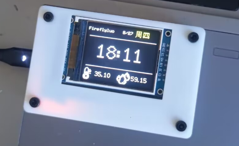

Multifunctional desktop clock based on ESP-WROOM-32

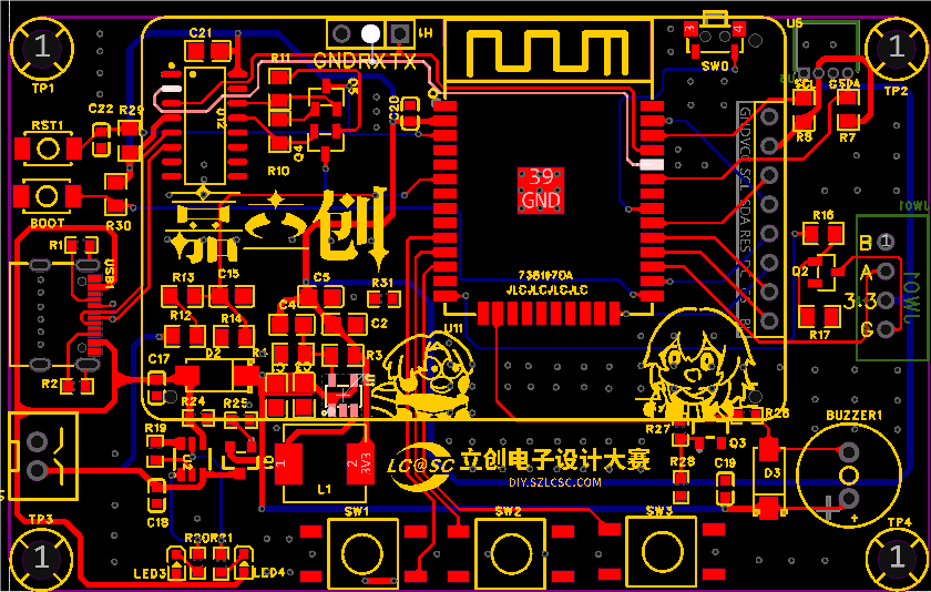

* 1. Project Function Introduction This project uses the ESP-WROOM-32 as the main control chip and a 1.8-inch TFT screen for display. The PCB size is 80mm*50mm. The power supply uses the SY8088, a DC/DC regulator capable of providing up to 1A of output current. Power charging and discharging management uses the TP4057. An interface for a JW01 gas detection module is reserved for future upgrades. * 2. Open Source License MIT License *3. Hardware Part Hardware Part: MCU main controller, temperature and humidity sensor, DCDC step-down, charge and discharge management, and 1.8-inch TFT display screen The effect produced tft.println(str); } WiFi and NTP const char *ssid = "your own WiFi"; //WiFi account const char *password = "your own WiFi password"; //WiFi password WiFiUDP ntpUDP; NTPClient timeClient(ntpUDP,"cn.pool.ntp.org"); //NTP server address void get_wifi() { // Connect to the network WiFi.begin(ssid, password); //Wait for WiFi connection while (WiFi.status() != WL_CONNECTED) { delay(500); Serial.print("."); } Serial.println(""); Serial.println("WiFi connected"); //Connection successful Serial.print("IP address: "); //Print IP address Serial.println(WiFi.localIP()); } timeClient.begin(); // Set the offset time (in seconds) to adjust the time zone, for example: // GMT +1 = 3600 // GMT +8 = 28800 timeClient.setTimeOffset(28800); SHT4x Temperature and Humidity Sensor // SHT40 Temperature and Humidity Sensor Configuration and Initialization Code #define SHT4X_SDA_PIN 21 #define SHT4X_SCL_PIN 22 Adafruit_SHT4x sht4 = Adafruit_SHT4x(); void SHT4x_Init() { Wire.begin(SHT4X_SDA_PIN, SHT4X_SCL_PIN); if (!sht4.begin()) { Serial.println("Couldn't find SHT4x");//Try initializing the SHT4x sensor. If it fails, print the error message and enter an infinite loop while (1) delay(1); } Serial.println("Found SHT4x sensor"); Serial.print("Serial number 0x"); Serial.println(sht4.readSerial(), HEX); sht4.setPrecision(SHT4X_HIGH_PRECISION);//Set the sensor precision switch (sht4.getPrecision()) { case SHT4X_HIGH_PRECISION: Serial.println("High precision"); break; case SHT4X_MED_PRECISION: Serial.println("Med precision"); break; case SHT4X_LOW_PRECISION: Serial.println("Low precision"); break; } sht4.setHeater(SHT4X_NO_HEATER);//Disable the sensor's heater function. switch (sht4.getHeater()) { case SHT4X_NO_HEATER: Serial.println("No heater"); break; case SHT4X_HIGH_HEATER_1S: Serial.println("High heat for 1 second"); break; case SHT4X_HIGH_HEATER_100MS: Serial.println("High heat for 0.1 second"); break; case SHT4X_MED_HEATER_1S: Serial.println("Medium heat for 1 second"); break; case SHT4X_MED_HEATER_100MS: Serial.println("Medium heat for 0.1 second"); break; case SHT4X_LOW_HEATER_1S: Serial.println("Low heat for 1 second"); break; case SHT4X_LOW_HEATER_100MS: Serial.println("Low heat for 0.1 second"); break; } }
