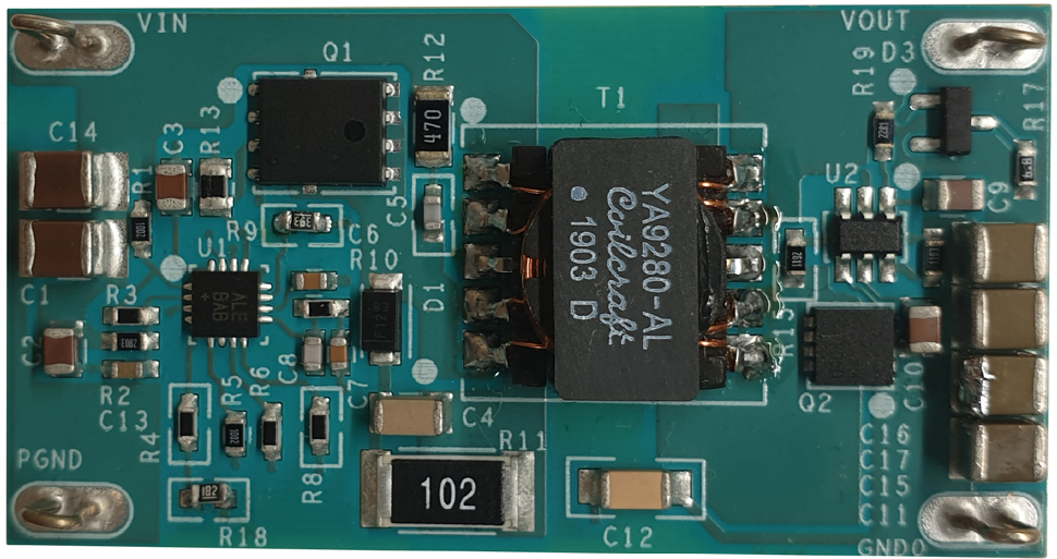

This board is not available for purchase.
Designed, Built, Tested
This document describes the hardware shown above. It provides a detailed systematic technical guide to designing an isolated no-opto flyback DC-DC converter using Maxim’s MAX17690 controller. The power supply has been built and tested.
