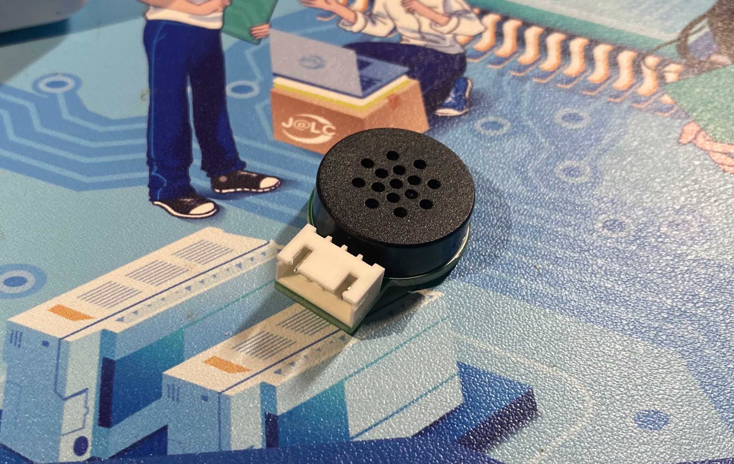

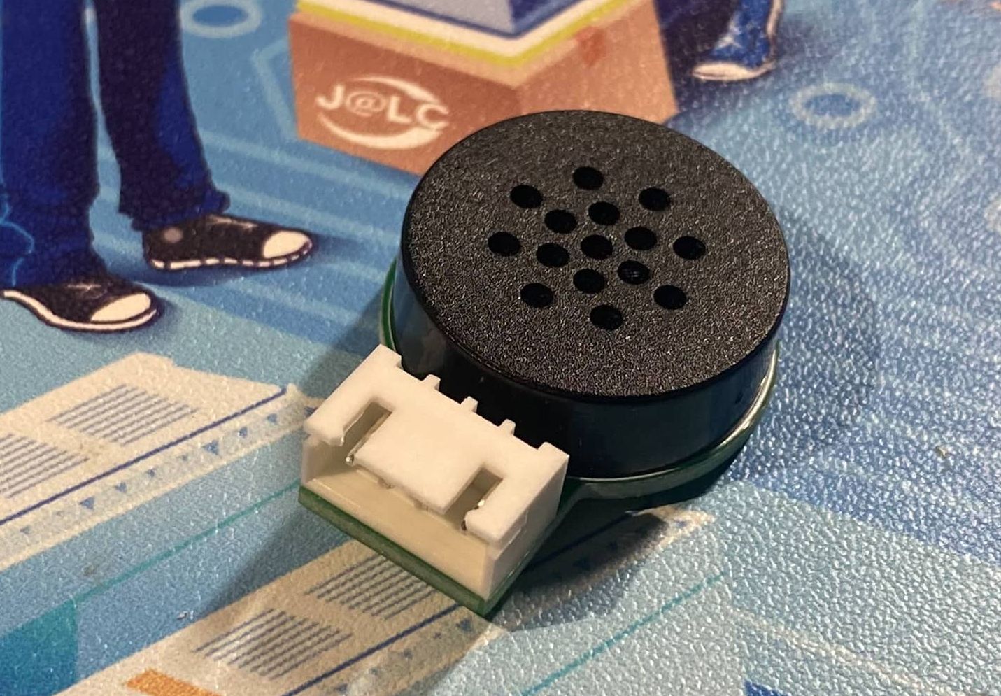

The user manual
only requires the XH2.54 cable to be inserted. Data transmission only requires connecting the DATA pin. If you need to detect the voice playback status, you can do so via the BUSY pin.
Physical Demonstration
Precautions
: 1. When soldering, please pay attention to the soldering order to ensure correct power supply and avoid burning out subsequent circuits! The soldering order should follow the principle of from shortest to smallest, and from inside to outside.
2. It is recommended to use the schematic parameters; the BOM table contains errors.
