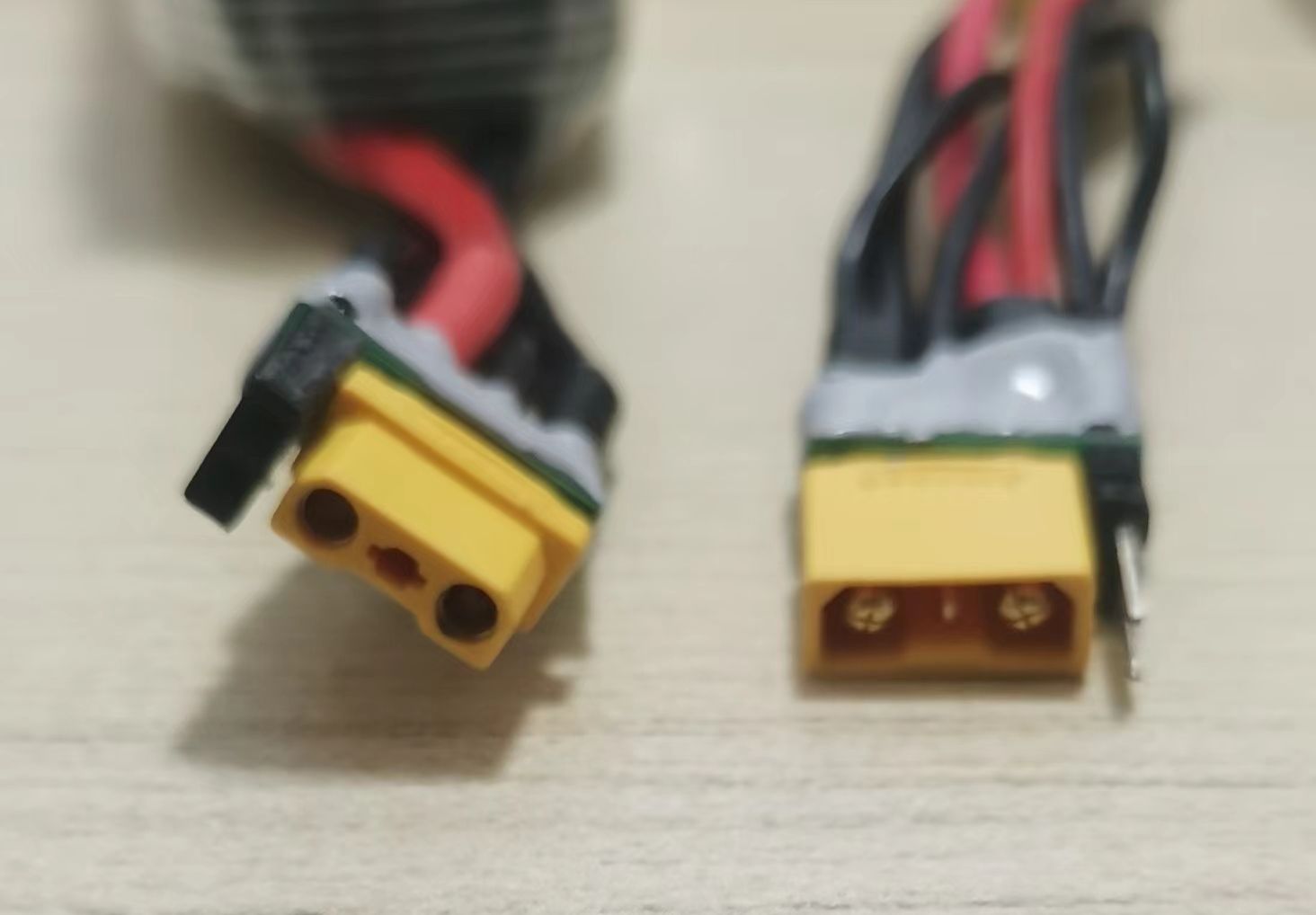

Improved 4S battery interface solution
1. Use 15mm 2.54mm long pin headers.
2. Use standard 2.54mm straight-through female headers.
3. Remember to glue the pin headers and female headers to the 301 connector with strong glue.
