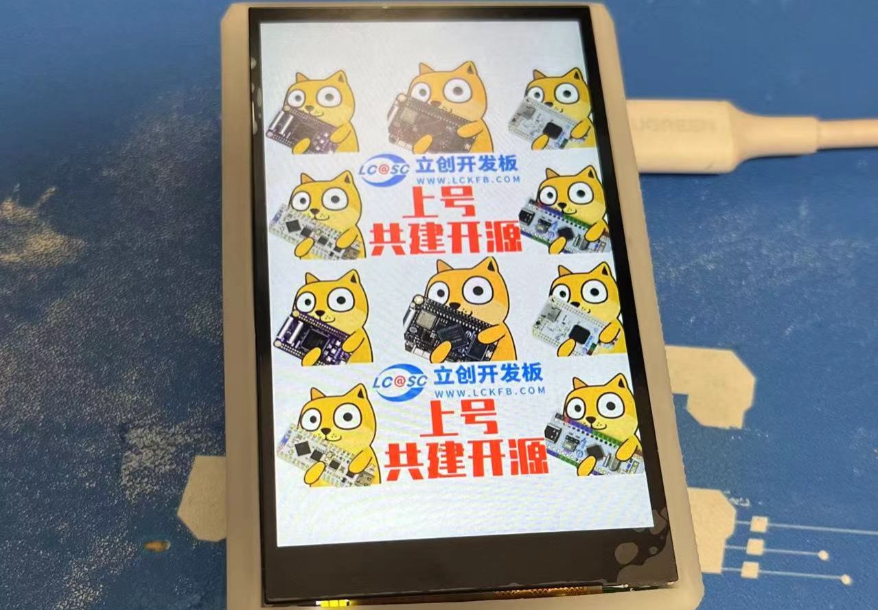

This little gadget, made following Mr. Wu's documentation, mainly focused on learning how to light up the screen, using a 3.1-inch screen. A huge thank you
to
the LCSC development board team for their hard work!

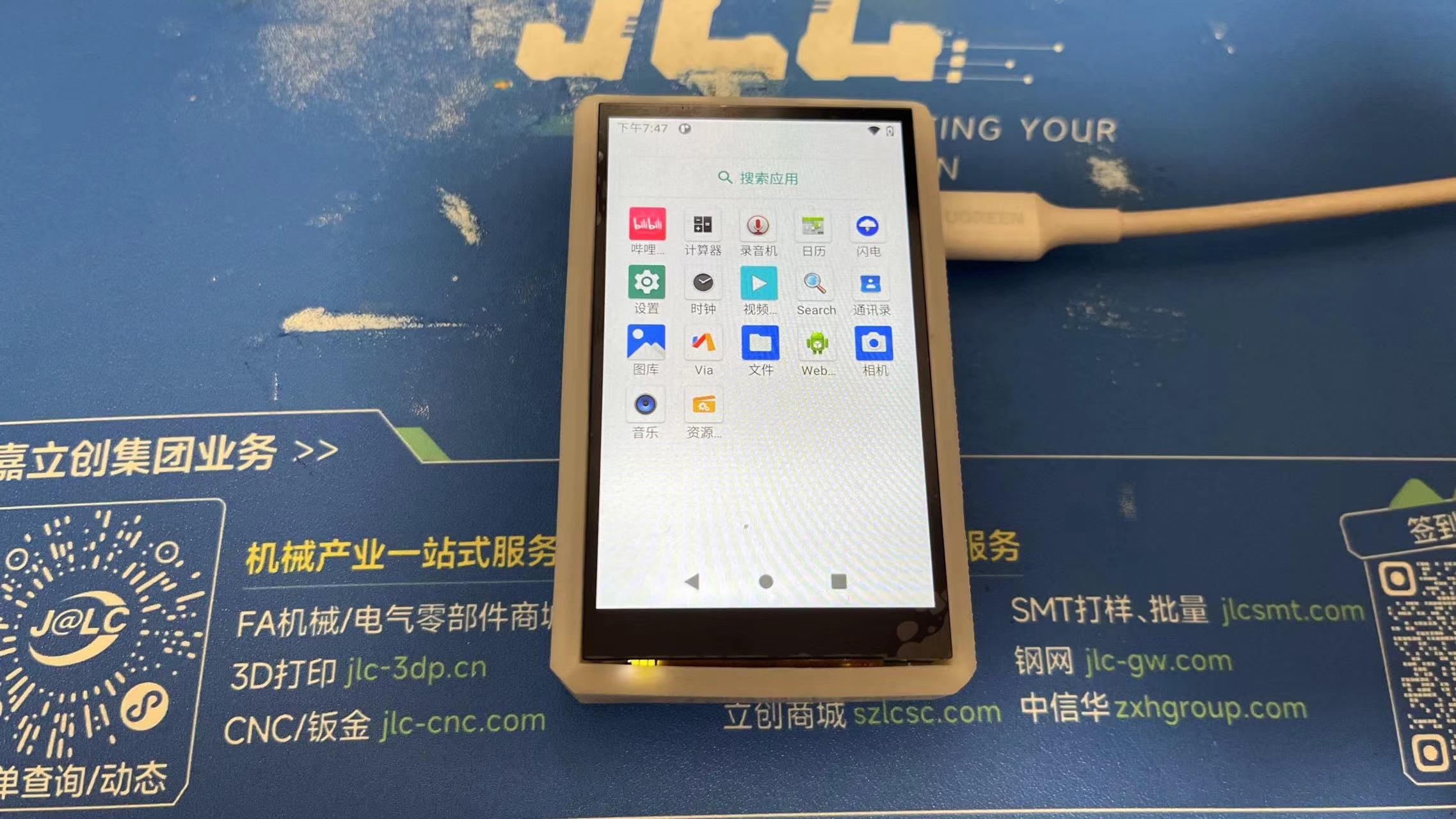

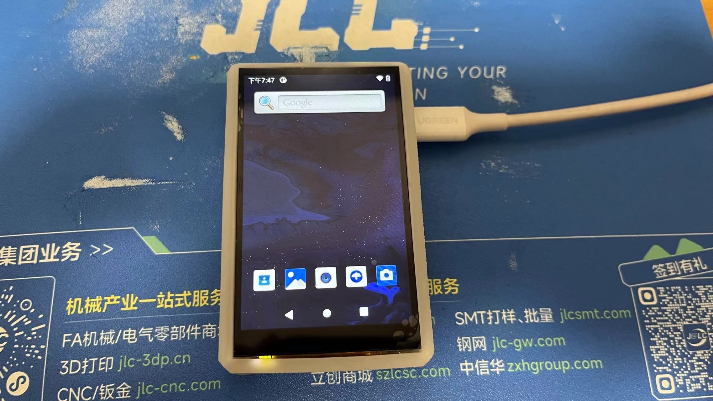

This training camp took a while, and the live stream had some hiccups, but the good thing was that I could follow along and debug step by step. Because many online tutorials are outdated, and the corresponding hardware isn't readily available, the time cost for beginners to figure things out on their own is too high.
Although Mr. Wu's documentation is very detailed, I feel there are still many pitfalls to overcome in building this little phone. First, you need a decent computer for compiling Android; otherwise, it will either be very time-consuming or completely uncompileable. Second, you need to be careful when soldering the screen adapter board; otherwise, you might encounter problems like bridging or cold solder joints. Finally, you need to be careful with the casing; of course, it's easier without a casing, just use studs.
Lastly, let's talk about the Taishan problem. With the RK3566's performance and 2GB of RAM, running Android is still a bit of a stretch, and it gets quite hot even with minimal use. I think it's better suited for Linux research, but the current system image for TaiShanPai is still a bit lacking. Rockchip's SDK defaults to kernel 4.4. Hopefully, TaiShanPai can integrate into the RK35XX community soon, since other RK development boards aren't updated very frequently and mainly rely on the open-source community.
