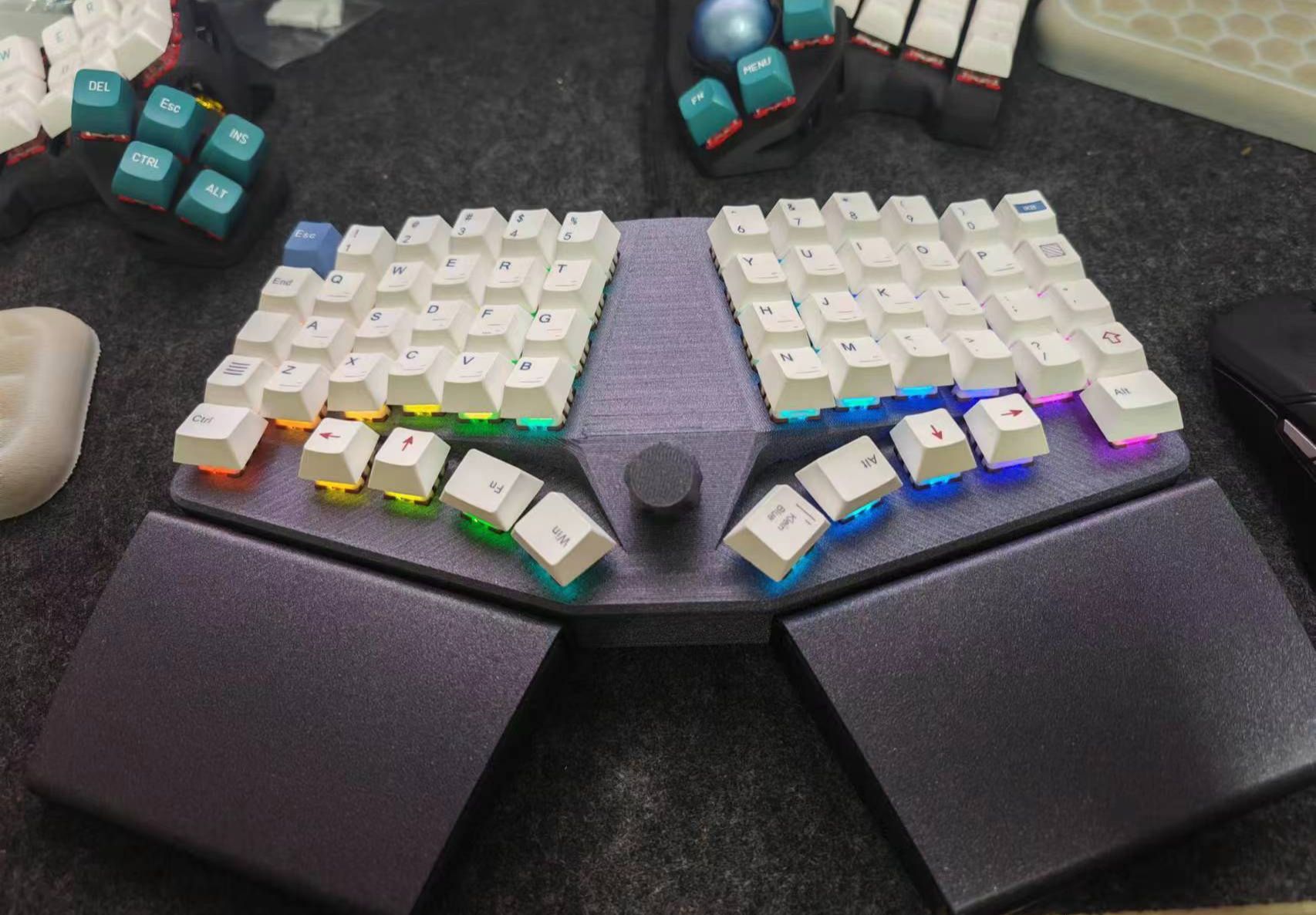

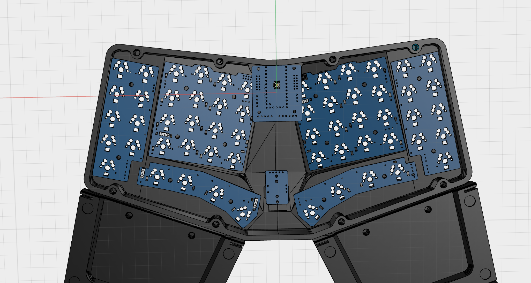

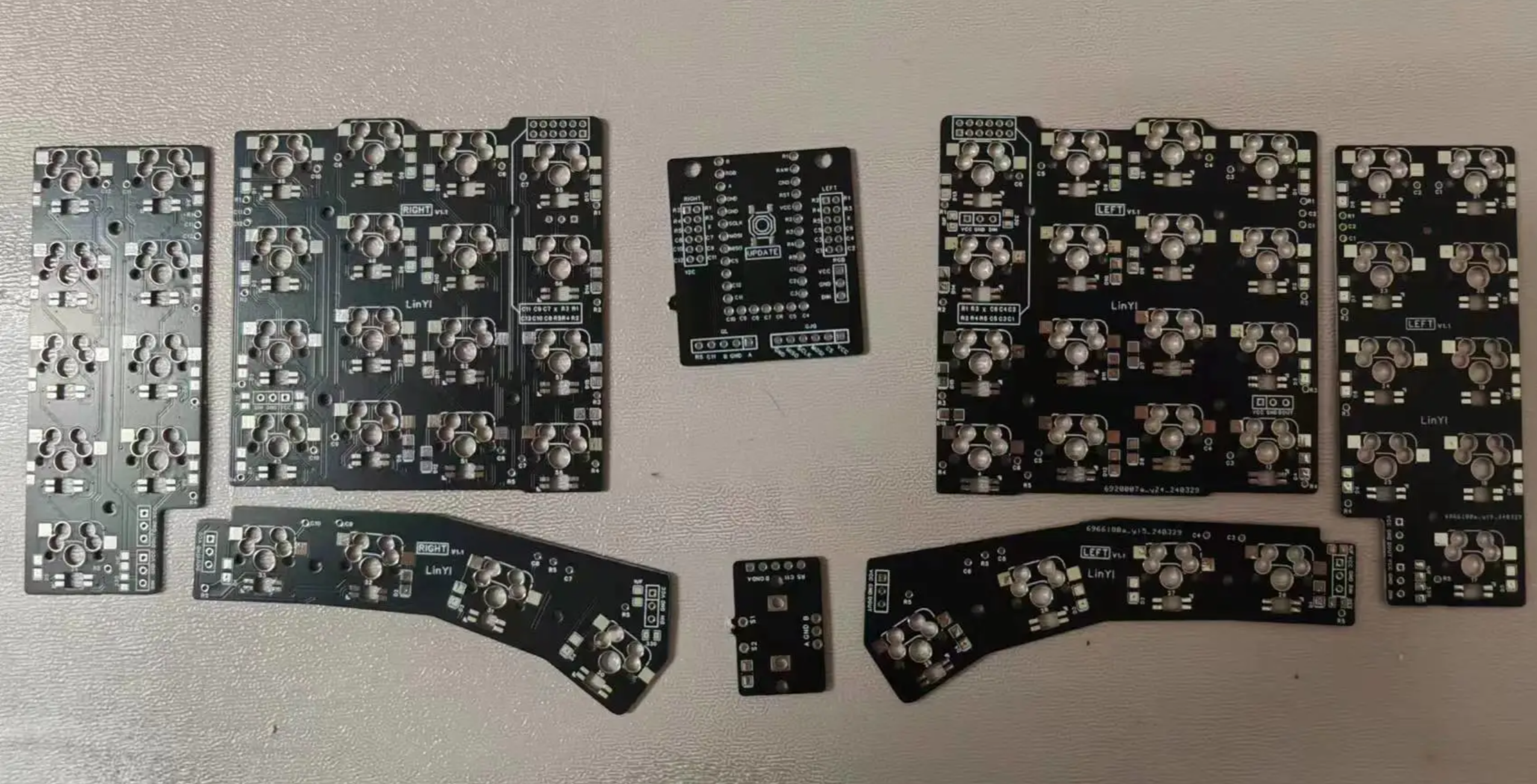

A total of four PCBs are needed, requiring two accounts.
Compared to the original version, hot-swappable axes and RGB LED functionality have been added.
PS: Special thanks to the user "God's Perspective" and the user "Li" for their help with model modifications.
Original open-source address: github.com/sevmeyer/chrumm-keyboard.
The step file is quite large; you can get it from the group: 852305909.
I'll make a welding tutorial when I have time.

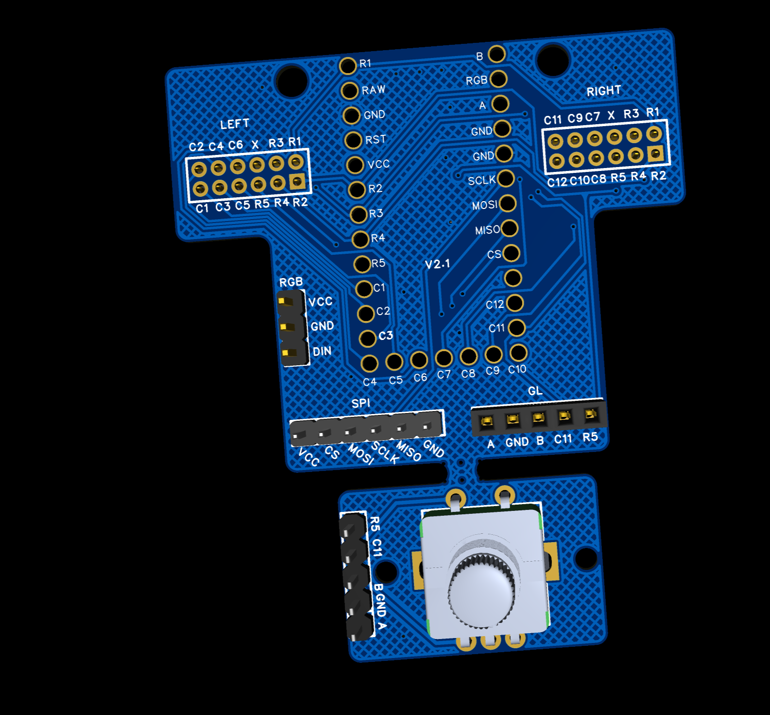

V2.1 updates with another, easier-to-weld main control bracket, but for some reason it doesn't display on the EDA. You can download the print file or project file directly from the attachments.
