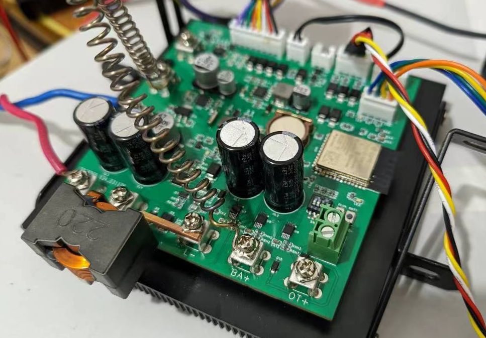

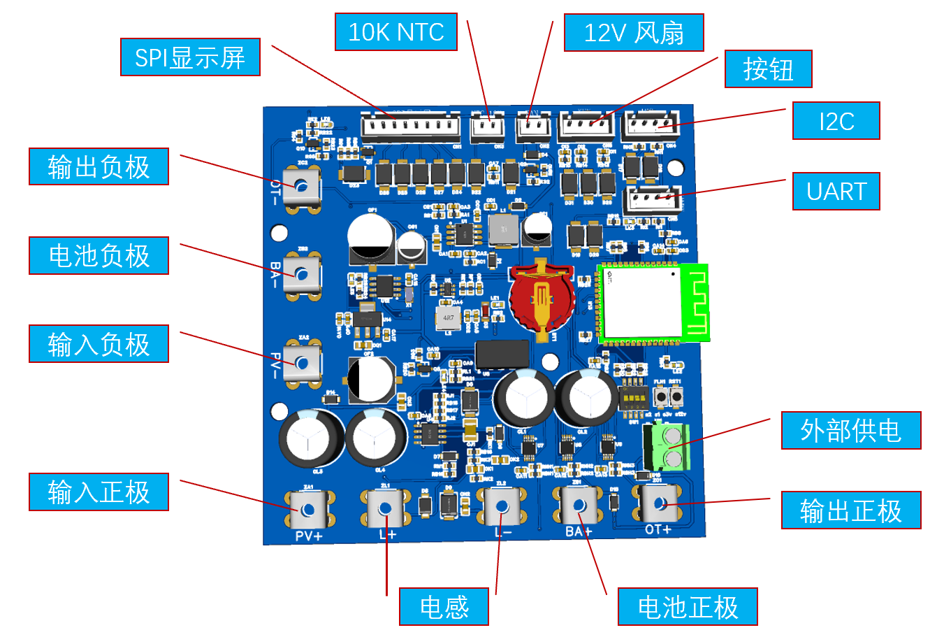

I. PCB Wiring Diagram

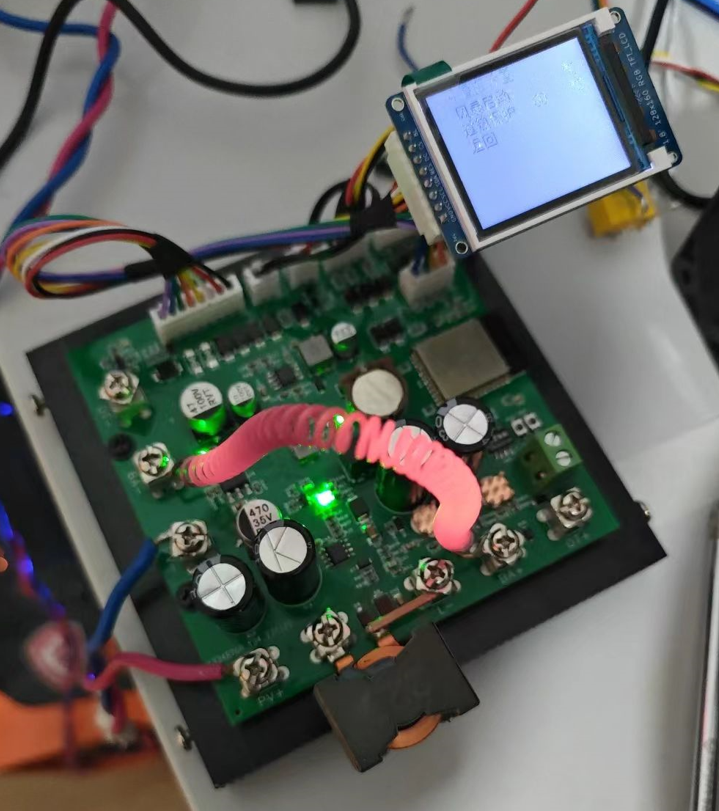

II. Test Conditions
        1. Use a switching power supply with an input of 15-30V.
        2. Use a resistance wire of approximately 5mΩ to simulate a battery.
        3. Use a 12*12 aluminum heat sink as the substrate, simultaneously cooling the MOSFET.
III. Test Results
       1. Based on the above test environment, the module works normally.

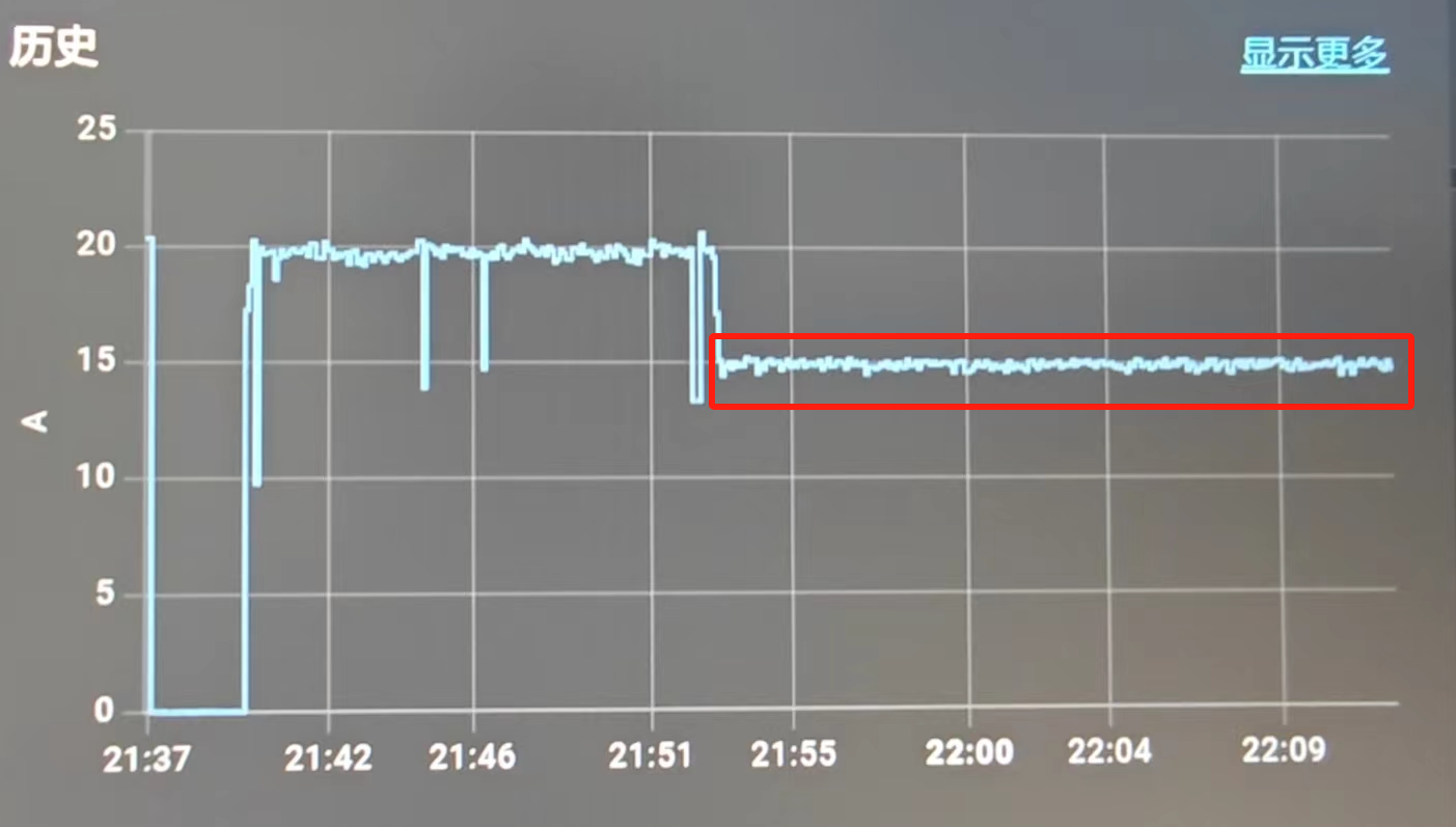

        2. The current effect is shown in the figure below. At 20Ah, the current fluctuates during operation due to the heat dissipation issue of the INA226. The module is stable at 15Ah.

       3. Heat dissipation is crucial; MOSFET heat dissipation is essential, otherwise, the MOSFET may overheat and be damaged. The INA226 is prone to significant temperature drift due to temperature issues; it is recommended to add a heat sink to the INA226.
