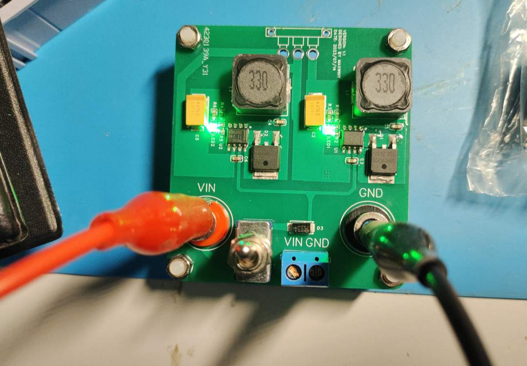

[2] Positive and negative power supply design based on TPS5430
Based on TI's TPS5430, this design uses a BUCK-BOOST topology to implement positive and negative power outputs. The wiring is completely based on the TI datasheet.
The schematic design implements ±15V outputs; please modify the feedback resistor accordingly if necessary.
参考设计图片
