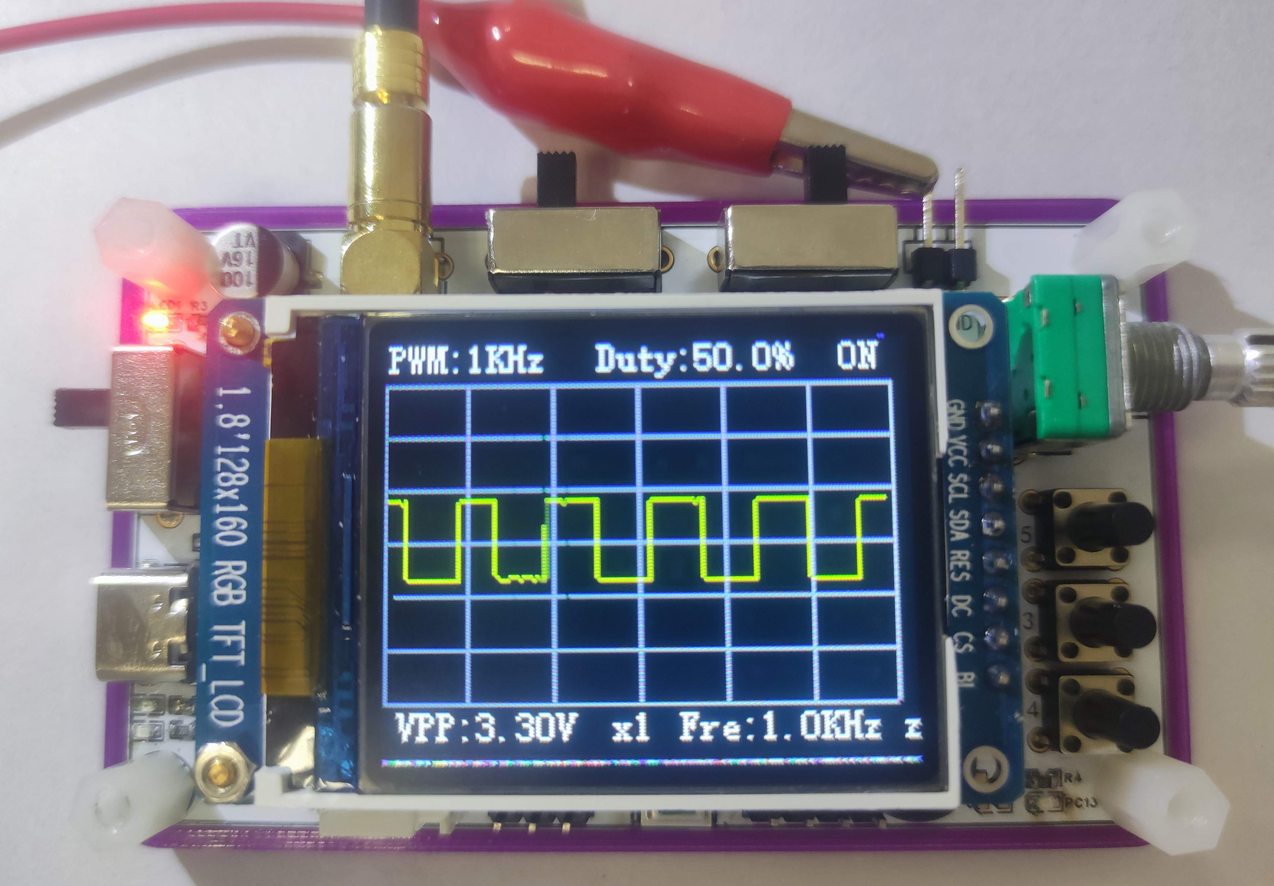

Waveform Input/Output Display:
Tested using an oscilloscope probe to measure the oscilloscope's built-in PWM output waveform.
