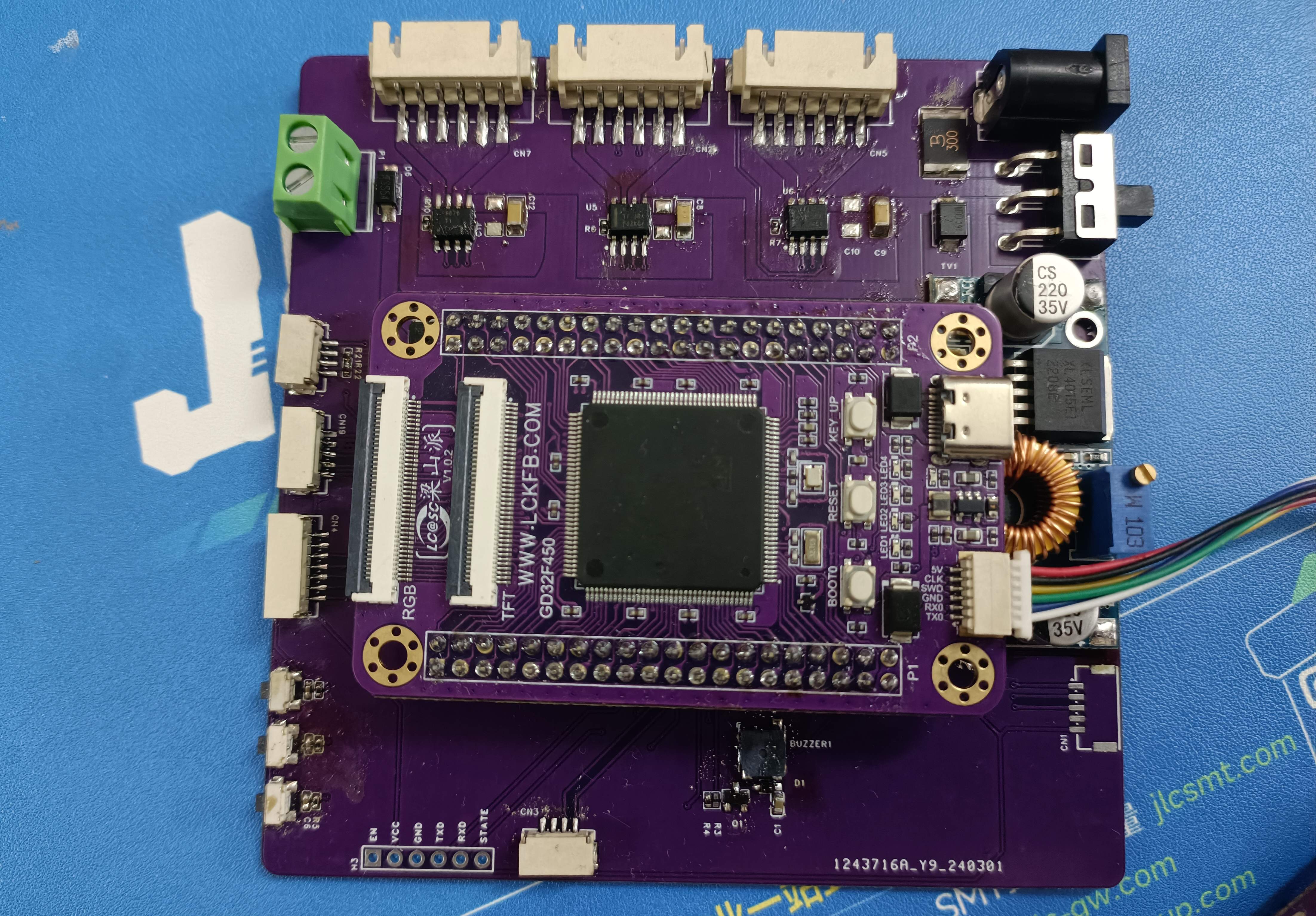

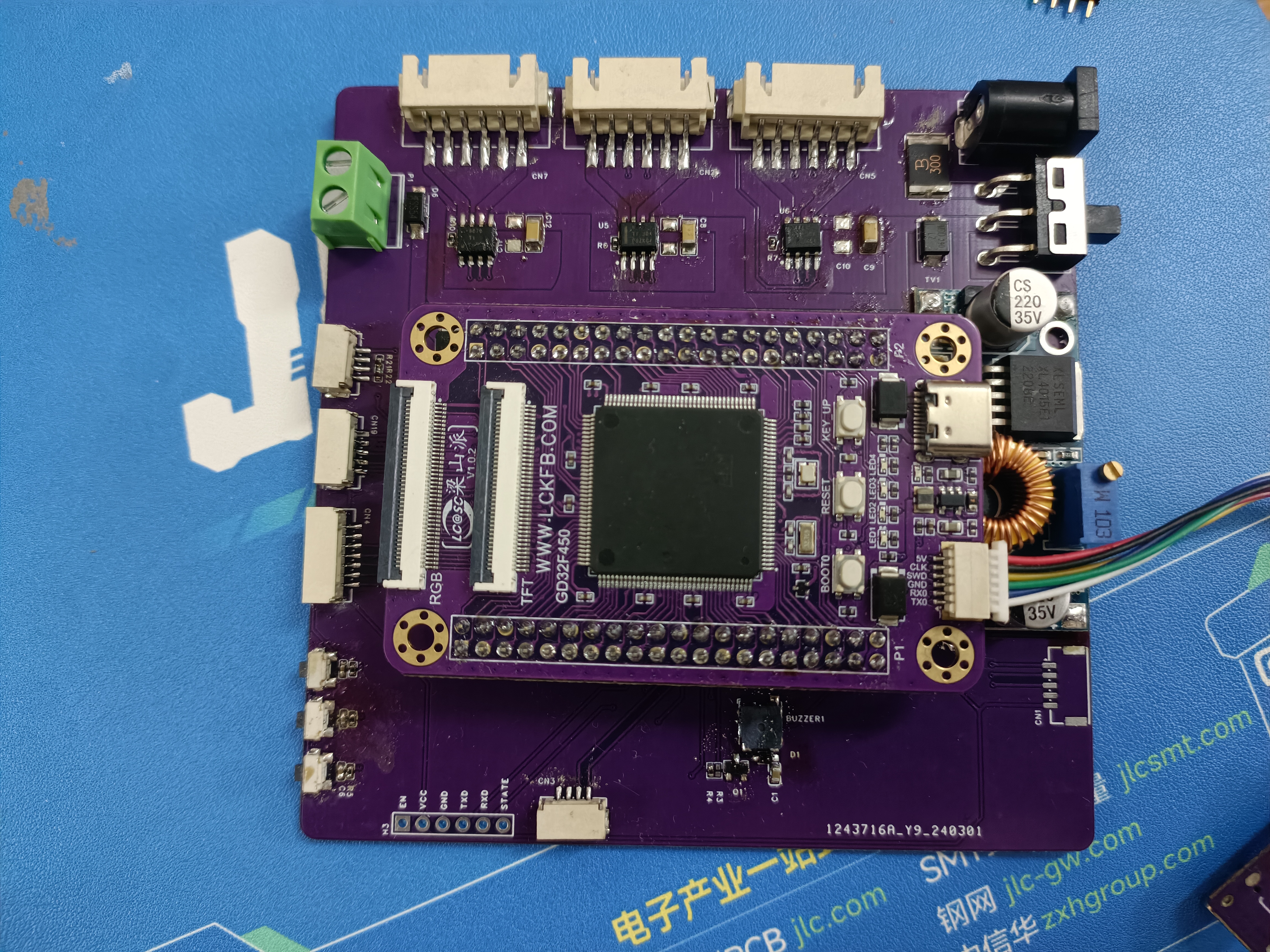

Design of the main control board for the feeding trolley based on LCSC Liangshan School
Objective: To design a feeding vehicle model for dispensing feed.
Functionality includes: 1. Three brushed motors driven by three encoders each, and one standard brushed motor driven without an encoder.
2. An ultrasonic sensor interface for obstacle avoidance.
3. A 5-channel grayscale sensor for line tracking, and a K210 interface for both object recognition and line tracking.
4. Three buttons that can be connected to a screen for various user operations. 5.
Includes a voltage detection circuit and three ADCs for user use.
6. An IIC interface for connecting to a servo control board to control multiple servos.
7. A buzzer for the vehicle's horn or low voltage warning.
8. One attitude sensor for detecting the vehicle's attitude (backup)
. **Note: During soldering, I discovered interference between the ultrasonic module and the servo control board, but since the ultrasonic module is not currently used, the hardware has not been modified. Another solution is to bring the ultrasonic module out from the back.** **
