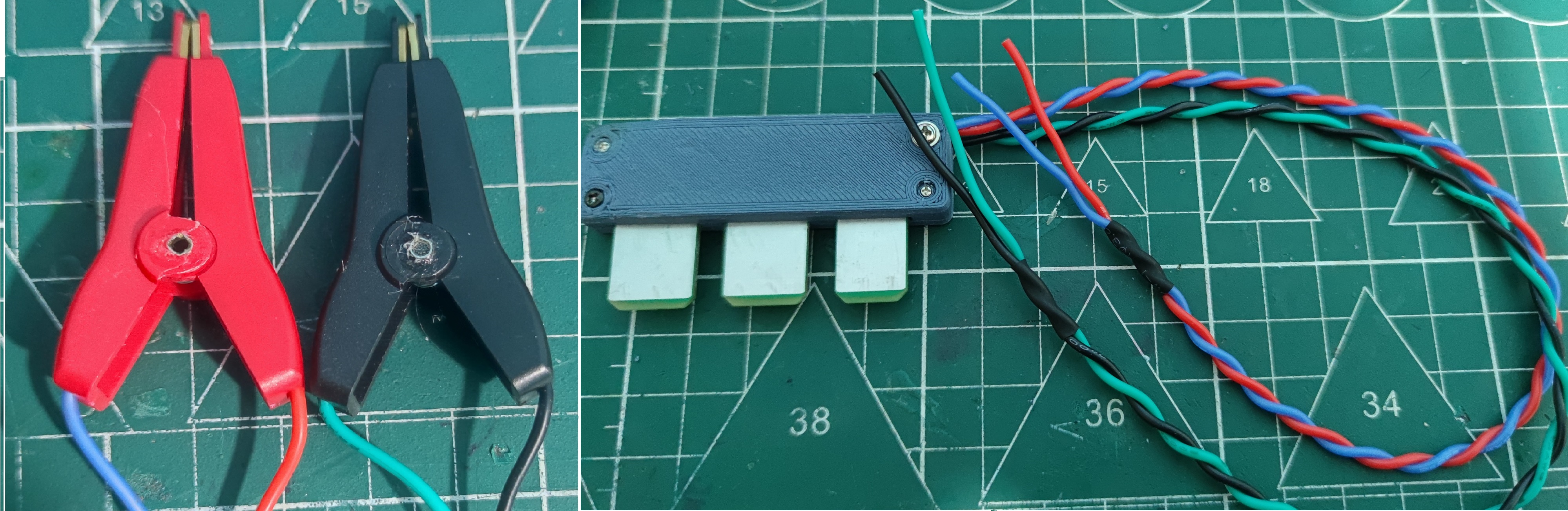

So I made one myself, as shown in the picture below.

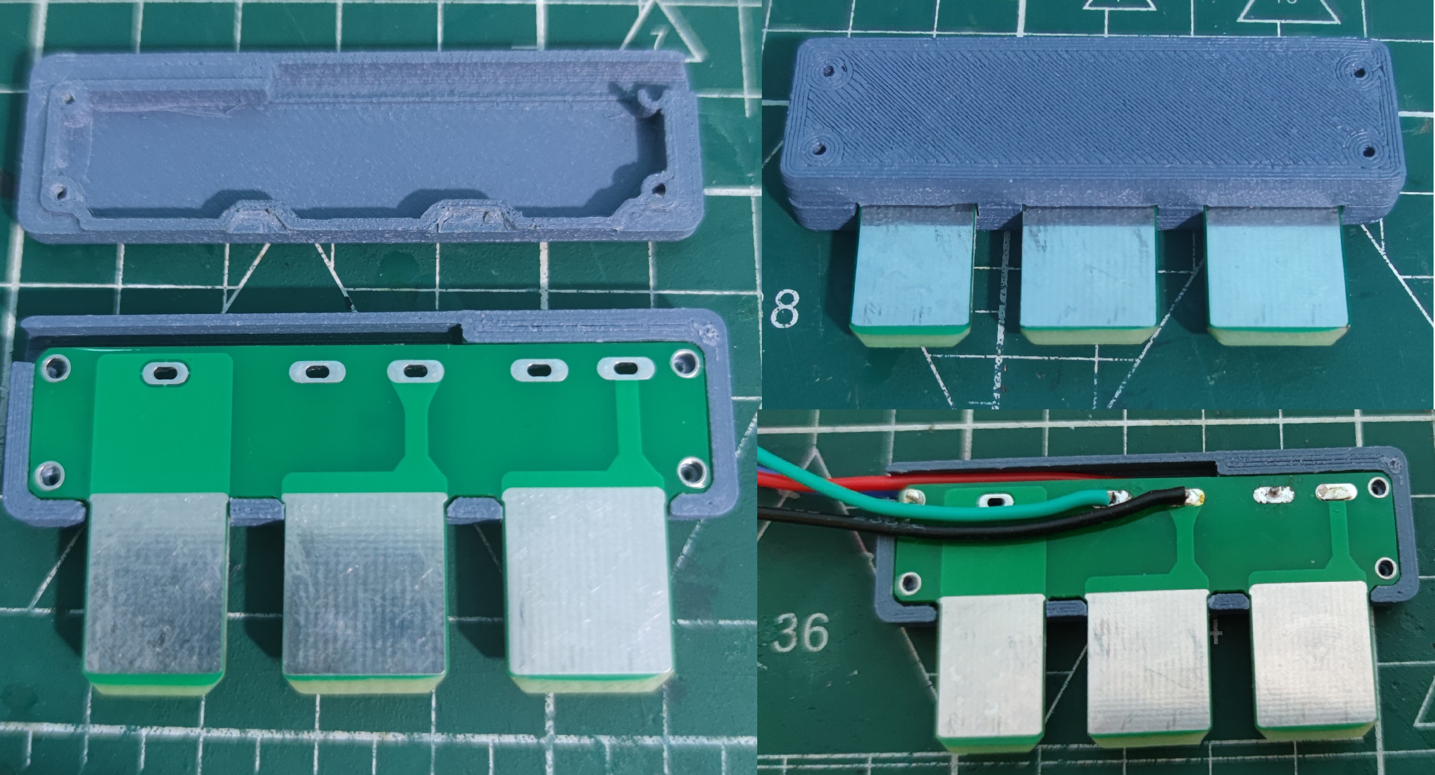

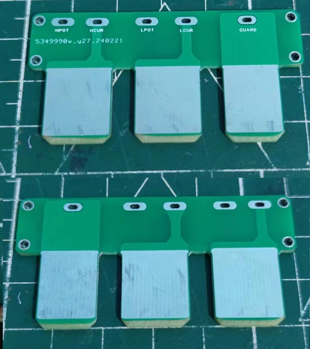

I made the PCB board based on the opening size of this handheld power bridge, and optimized it based on this finished product, adjusting the size and making a shell, which can be 3D printed.
The bottom of the insert can be sanded to create a slope for easier insertion.
PS: It's best to sand the edges of the insert as well to prevent insulating varnish from remaining. The first version's opening area didn't extend beyond the frame, resulting in insulating varnish on the insert's edge. The insert and the handheld power bridge's spring contacts had poor contact, but it wasn't visible to the naked eye. Charlie took a long time to find the cause. A narrow strip of green insulating varnish on both sides protruded a few tenths of a millimeter above the copper foil, preventing the spring contacts from making contact with the copper foil. The PCB opening method has been changed, but it hasn't been tested yet; it should be fine now.
The wiring method is shown in the picture: the two leads of one insert connect to the two copper pieces of a clip. The bottom is for the shielding layer; it's optional.

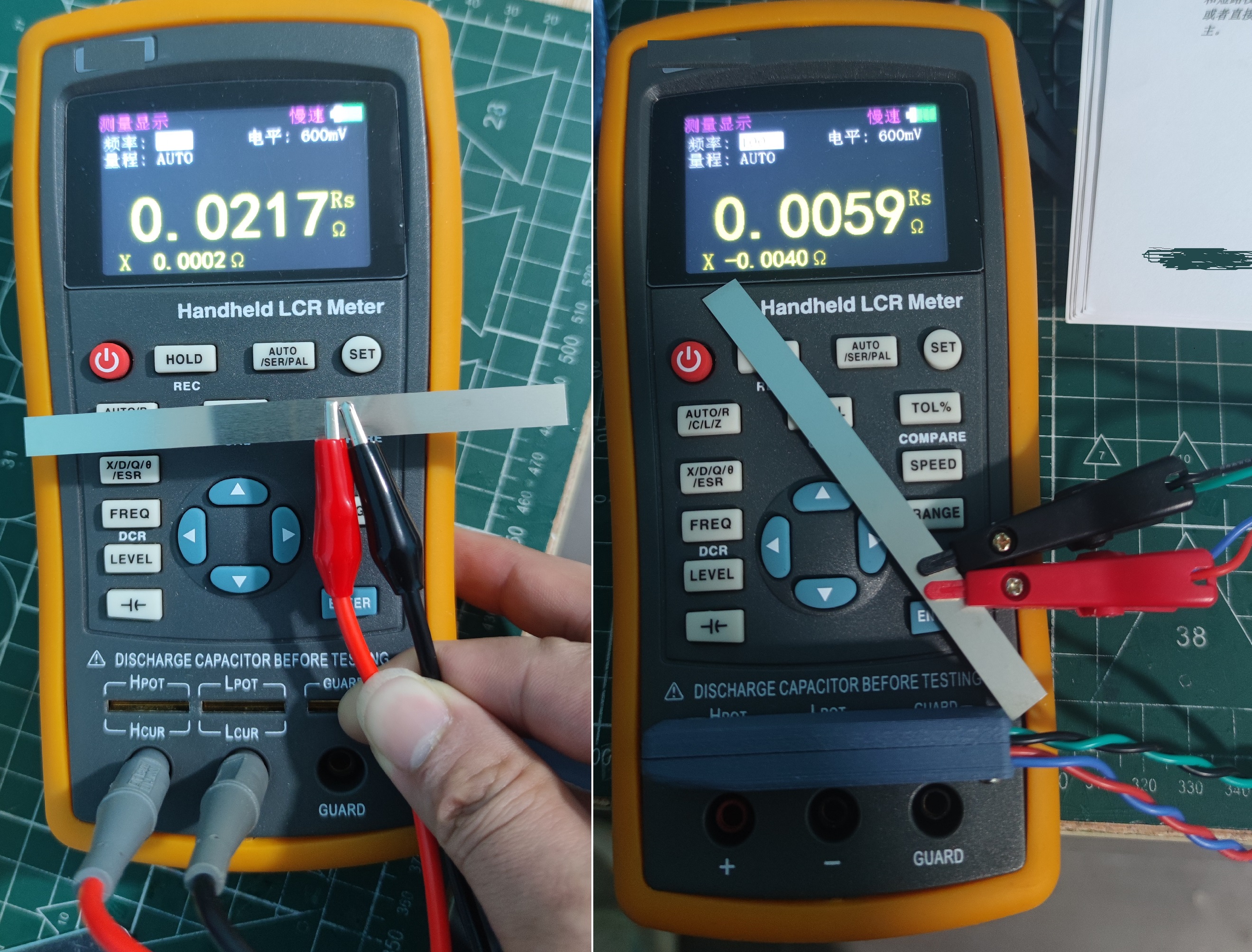

The testing accuracy is much better than the included two-wire alligator clip. The accuracy can be improved by about an order of magnitude.
  PS: This nickel strip measured about 0.5m ohms with a battery internal resistance meter, while the bridge circuit is an order of magnitude larger. The two have different ranges, hence the difference in accuracy. This bridge circuit has a minimum resistance range of 200 ohms, while the internal resistance meter's minimum range is 2 milliohms. Therefore, to measure small resistances, you still need to buy an internal resistance meter.
