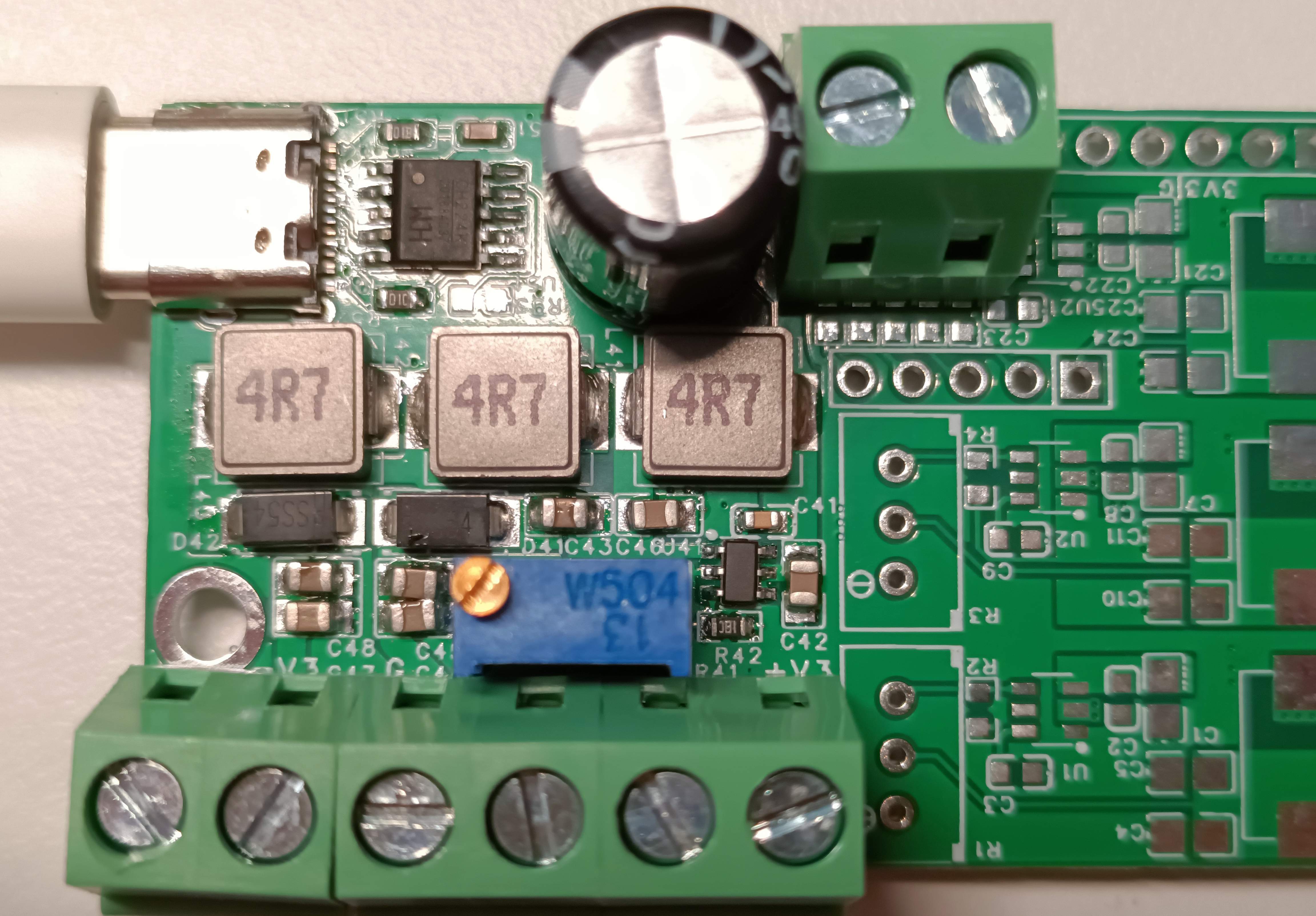

SEPIC+CUK Dual Power Supply + PD Decoy MT3608
The 20V PD Power Supply Module
is designed to build a desktop power supply with adjustable voltage. Its input voltage Vin is designed to be 5V~20V, input via USB PD protocol, and the output voltage Vout is designed to be -20V~20V, output via 5.0mm terminal blocks.
Board Description

400kHz. 8. XL1583 BUCK 23V 3A BUCK step-down 3.6V-23V 3A 380kHz. 7. Verification Board includes: CH224K PD Module (verified) , MT3608 SEPIC+CUK 24V 2A_1 (verified) , TPS54302 BUCK 28V 3A_1 (unverified).
