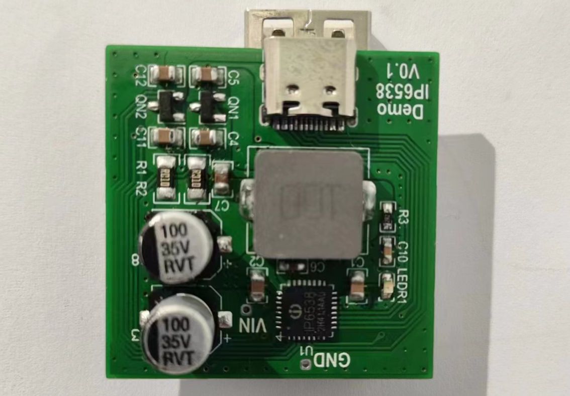

External power supply 36/45W: IP6538-AC
Function Description:
8~32V input, car charging/discharging chip, USB A+C or C+C or A+A, 5V/9V/12V 3A (up to 15V 3A 45W customizable).
Input voltage
8~32V. 40V Max.
Output ports:
USB-A, USB-C (A+C, A+A, C+C all available)
Output power:
Switching frequency
: 150KHz
Static power consumption :
3mA
Chip over-temperature
protection (built-in over-temperature protection at 150℃)
Input voltage :
Input current: Output
voltage:
Output current:
Power supply power:
Power efficiency:
12.09V
0.469A
5.12V
1.00A
5.67W
90.23%
12.13V
0.914A
5.14V
2.00A
11.08W
92.81%
12.12V
1.379A
5.17V
3.00A
16.71W
92.89%
24.34V
0.246A
5.12V
1.00A
5.98W
85.56%
24.33V
0.477A
5.15V
2.00A
11.60W
88.77%
24.32V
0.707A
5.18V
3.00A
17.19W
90.40%
24.31V
0.548A
12.14V
1.00A
13.32W
91.16%
24.29V
1.089A
12.17V
2.00A
26.45W
92.03%
24.28V
1.615A
12.20V
3.00A
39.21W
93.35%

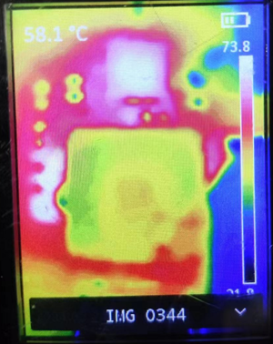

Operating Temperature

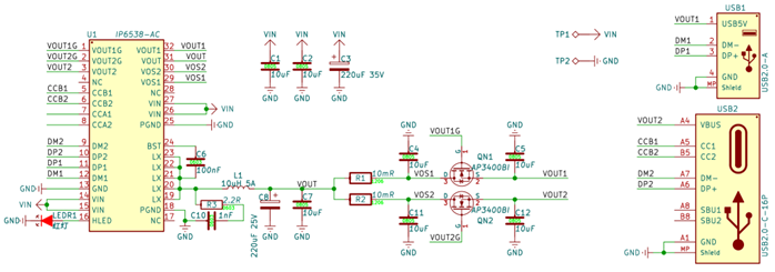

Schematic Diagram

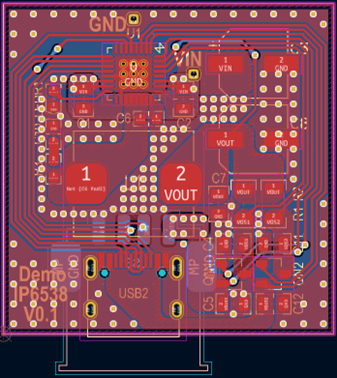

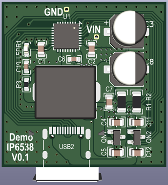

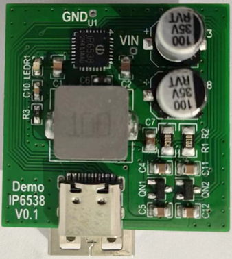

PCB Layout
Diagram 3D preview images and
PCB layout
images are available for download
at https://oshwhub.com/saber.lily.
For other design file formats, please obtain them from your supplier.
