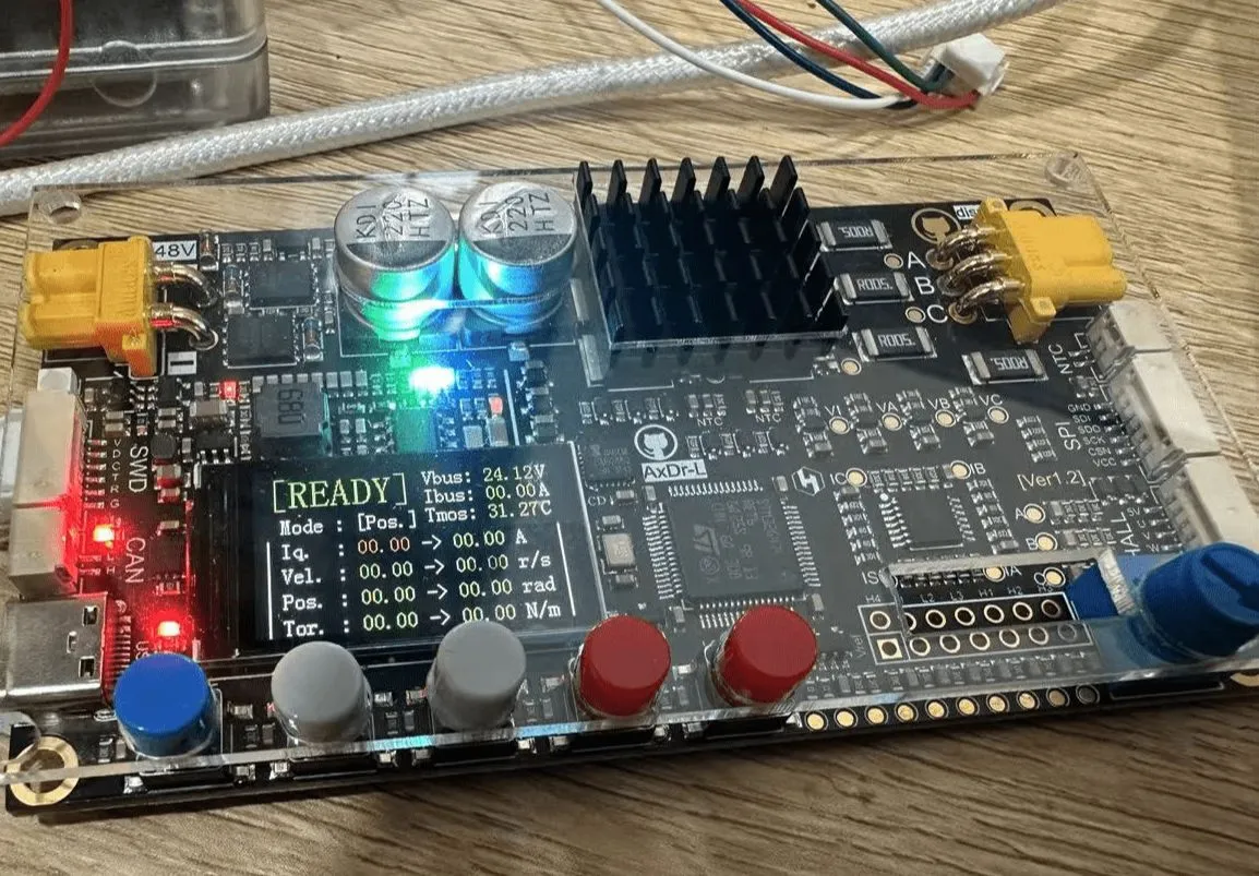

1. Introduction to AxDrive-L The
AxDrive-L FOC motor drive learning board is a hardware project designed for electronics enthusiasts, students, and beginners. It aims to provide a user-friendly and highly educational platform to help users deeply understand and master Field-Oriented Control (FOC) motor control technology. The board features multiple protections, including reverse connection protection and soft start, and is easy to use, allowing beginners to easily learn and understand the principles of the FOC algorithm.

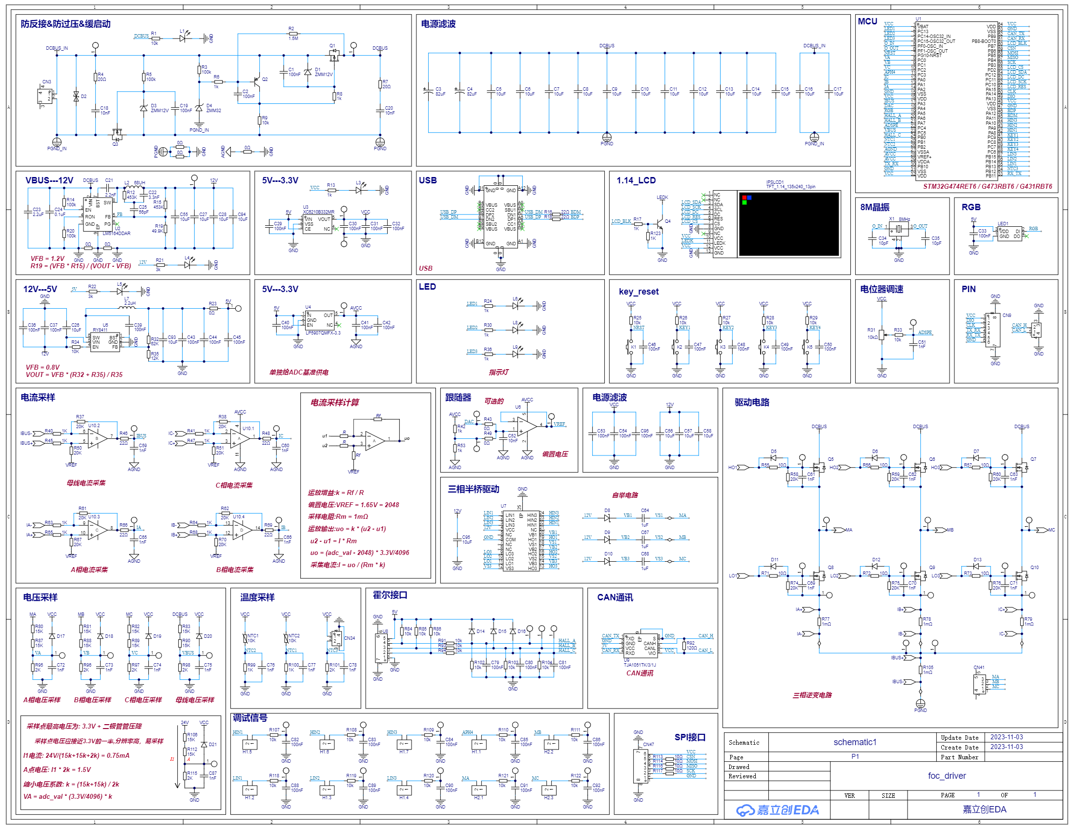

3. Schematic Design

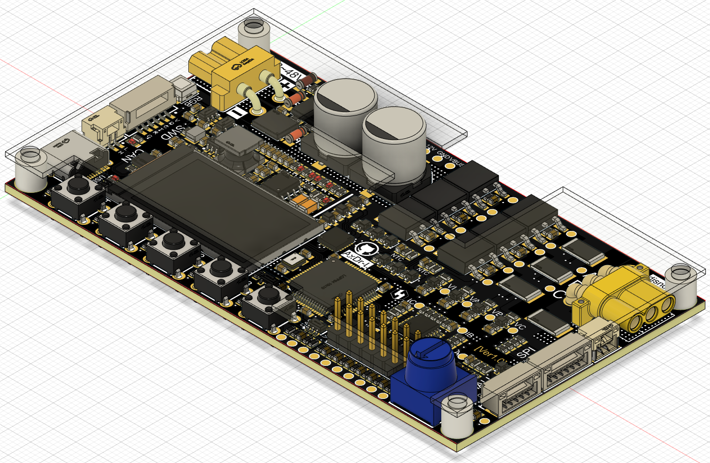

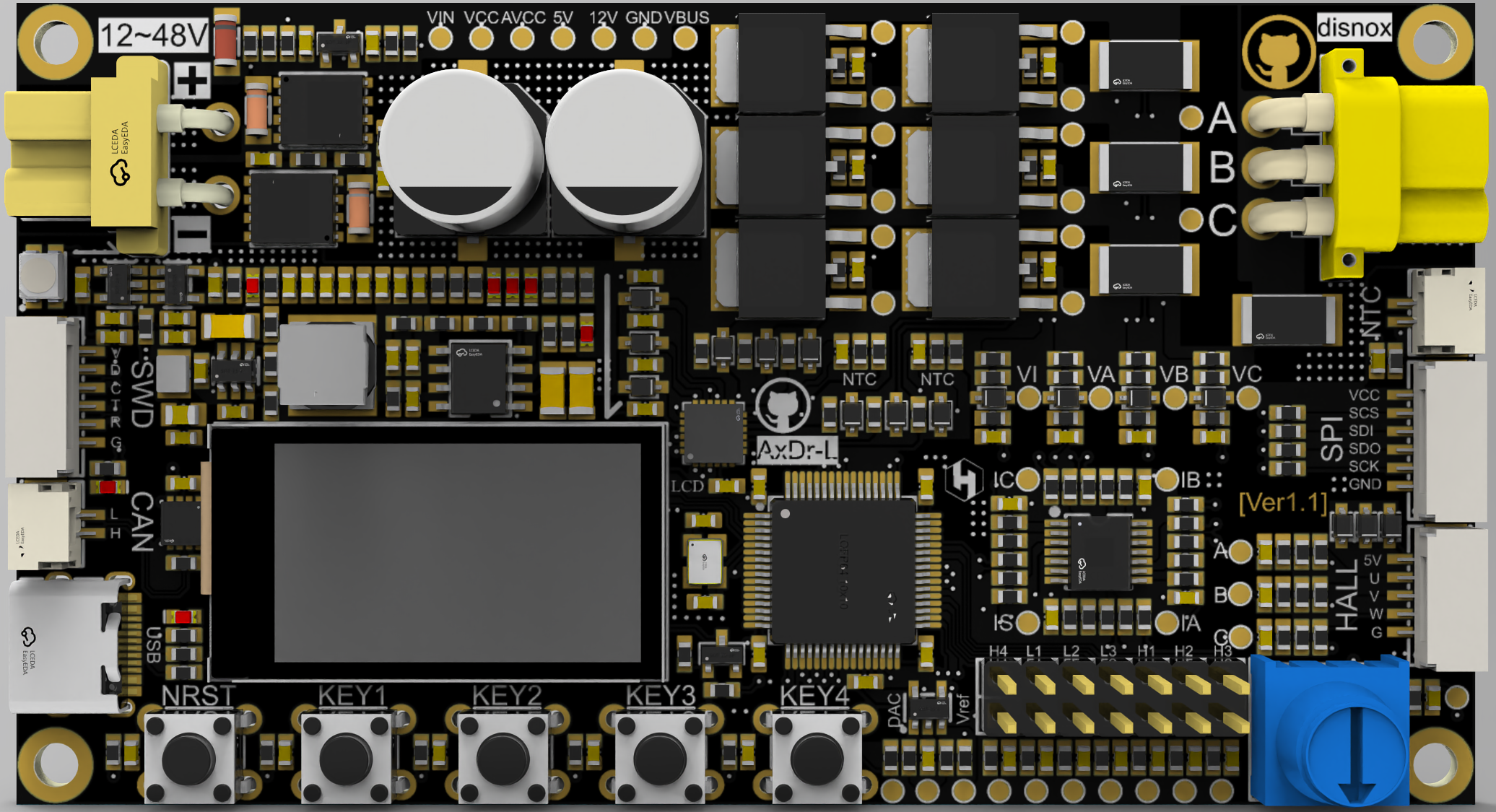

4. 3D-PCB Rendering

For detailed circuit principles, please refer to the hardware design report. A VPN is recommended.

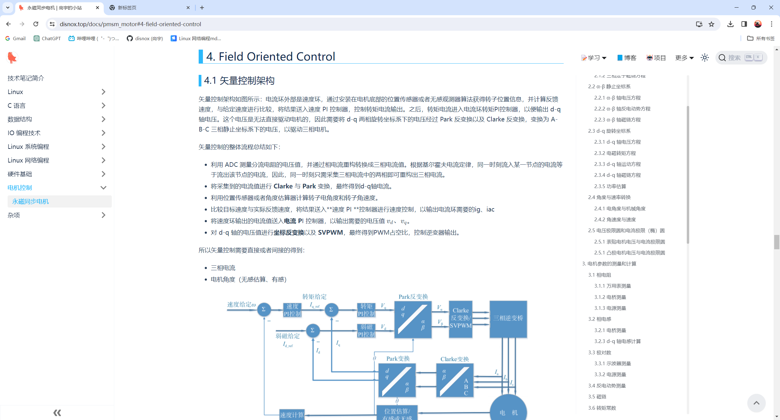

7. Technical Notes:
This is a collection of technical notes I compiled while learning motor control. There may be omissions, so please point out any errors.
Because the website is hosted on GitHub, it might be slow for users in China; a VPN is recommended.
Notes link: (https://www.disnox.top/docs/pmsm_motor#4-field-oriented-control)
Some notes and the directory structure are shown below:

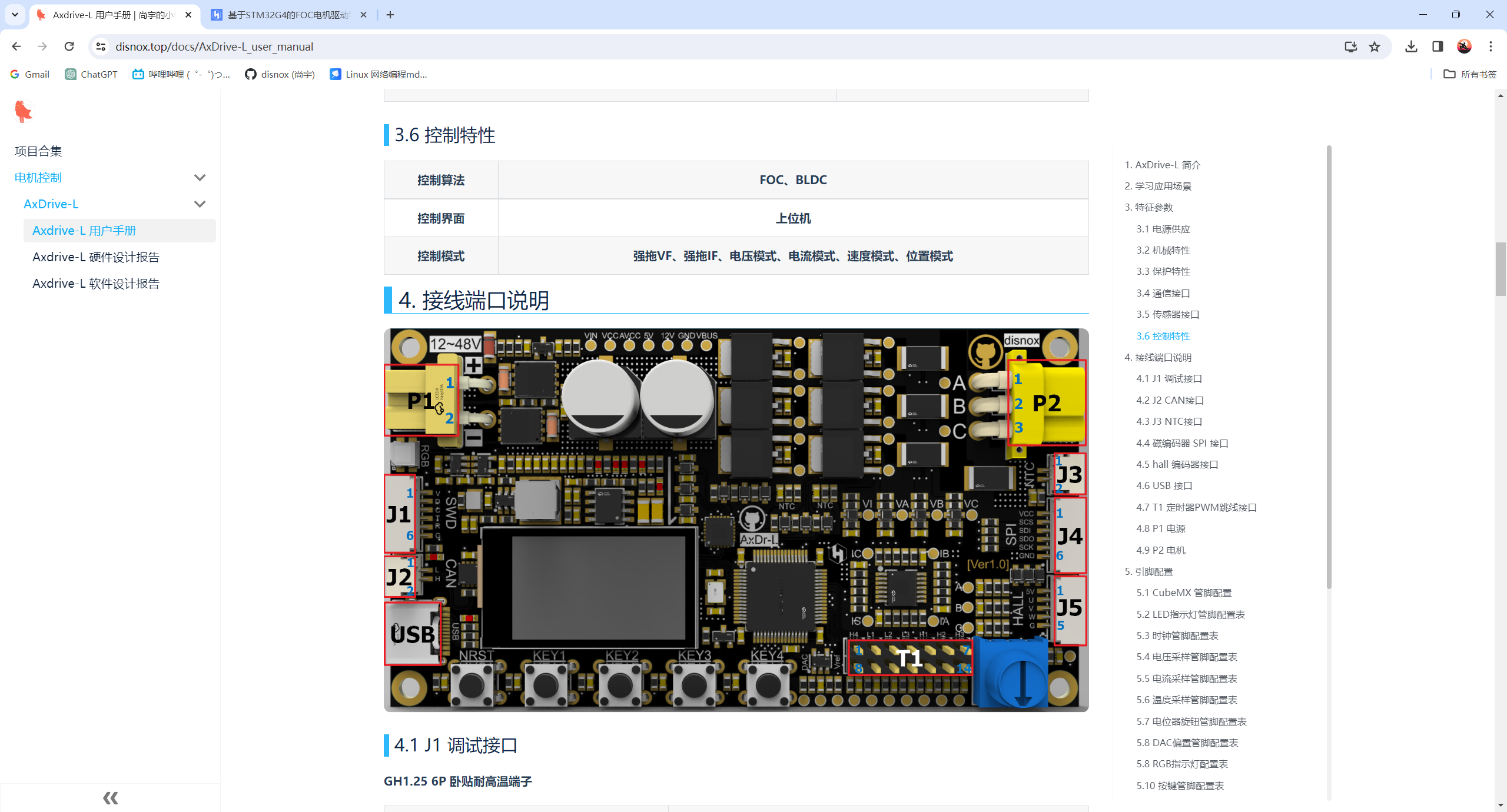

8. User Manual:
This is the user manual for the AxDr-L driver board. Some parameters haven't been updated in detail yet, but I will add them later.
User Manual link: (https://www.disnox.top/docs/AxDrive-L_user_manual)
Some manual content and the directory structure are shown below:

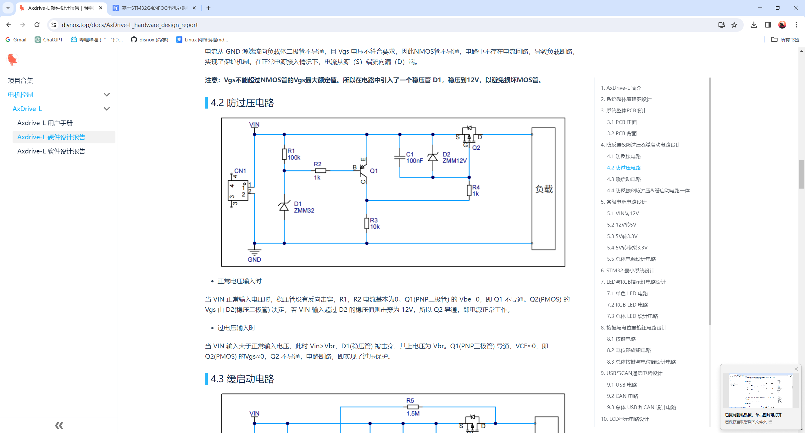

9. Hardware Design Report : This is
the hardware
design report for the AxDr-L driver board. It differs from the current schematic only in some resistor and capacitor numbers; everything else is largely the same. I will revise it when I have time.
Hardware design report link: (https://www.disnox.top/docs/AxDrive-L_hardware_design_report)
Partial manual and directory structure are as follows:

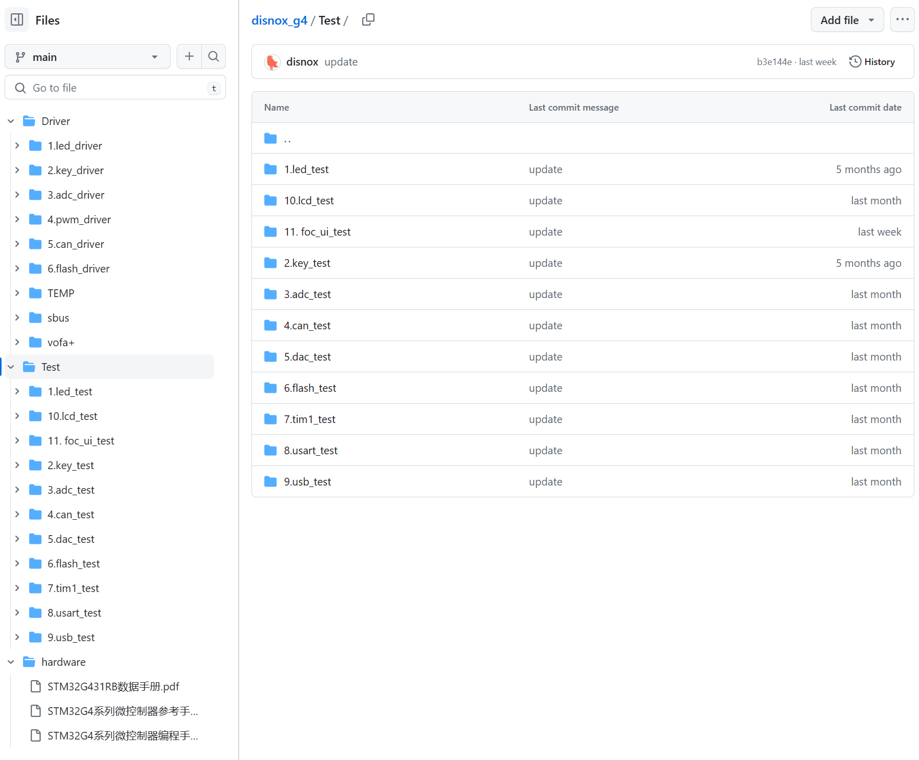

11. Peripheral test code
Peripheral test code link: (https://github.com/disnox/disnox_g4)

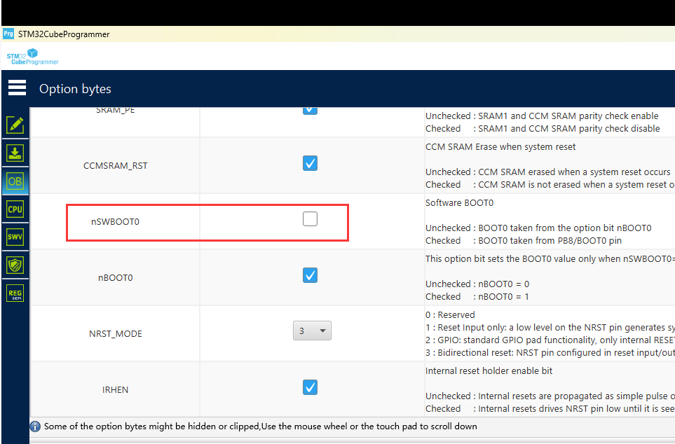

Because the CAN port and Boot0 IO port are multiplexed, the schematic design does not pull boot0 down to GND. Software boot pulldown setting is required through STM32CubeProgrammer:
