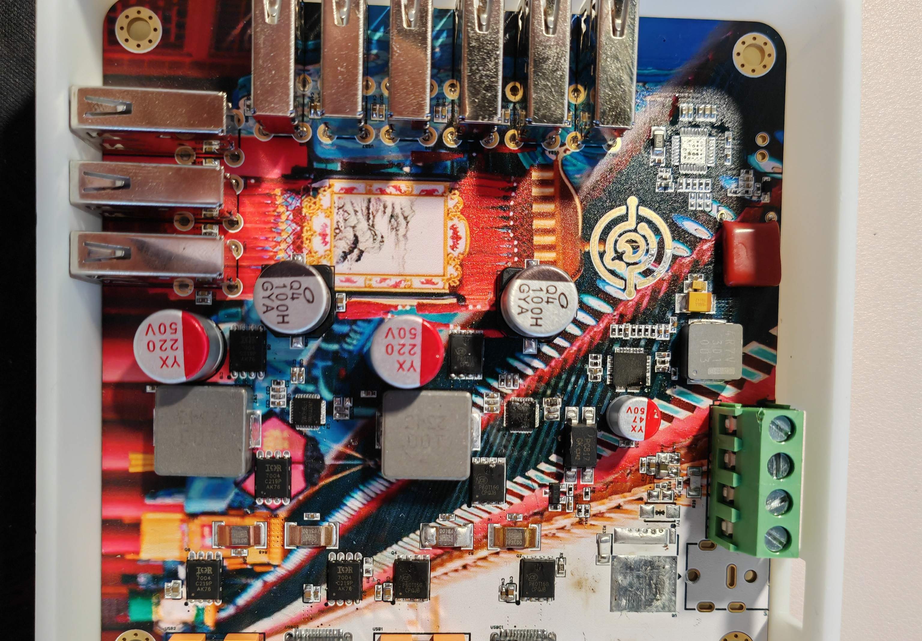

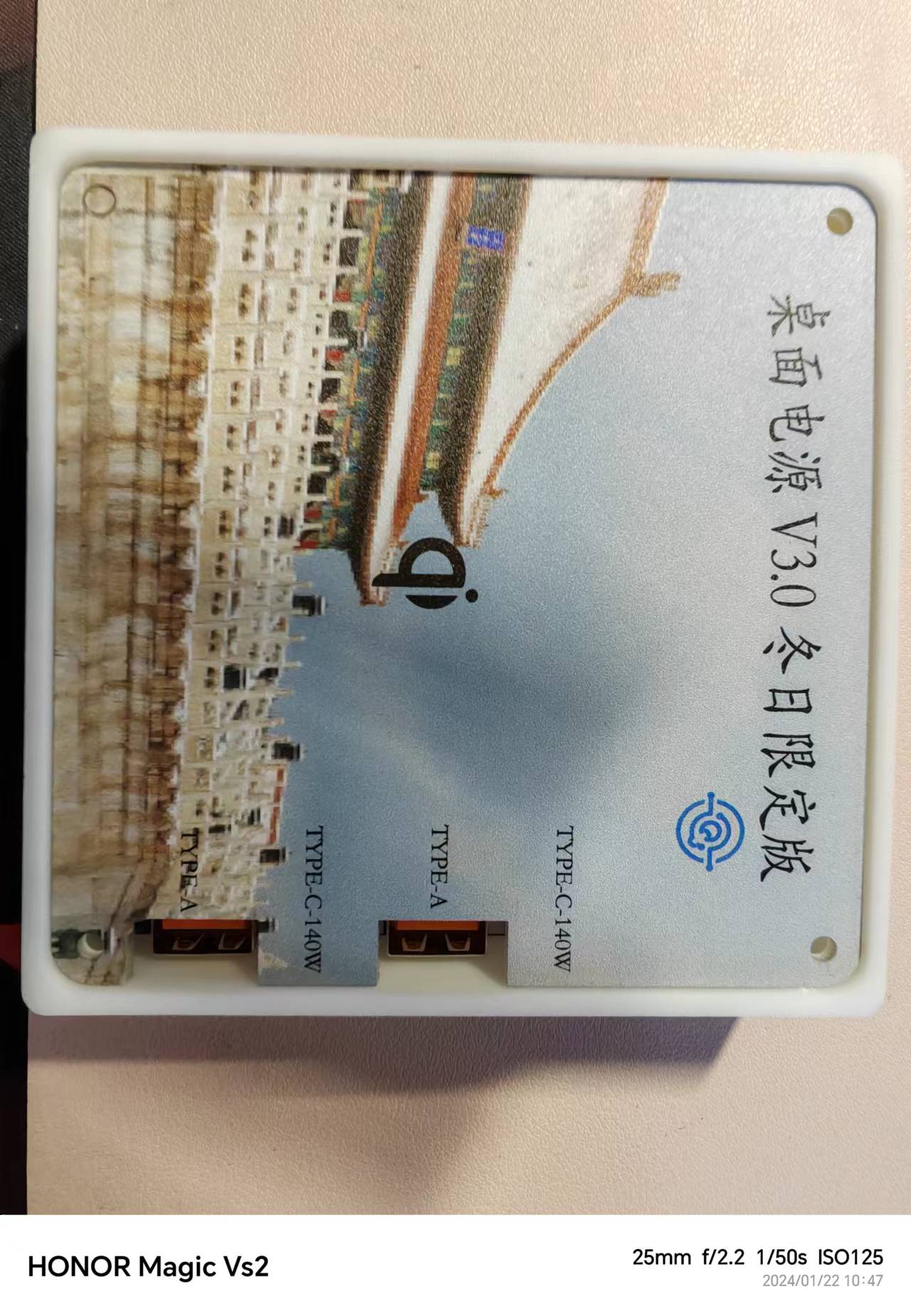

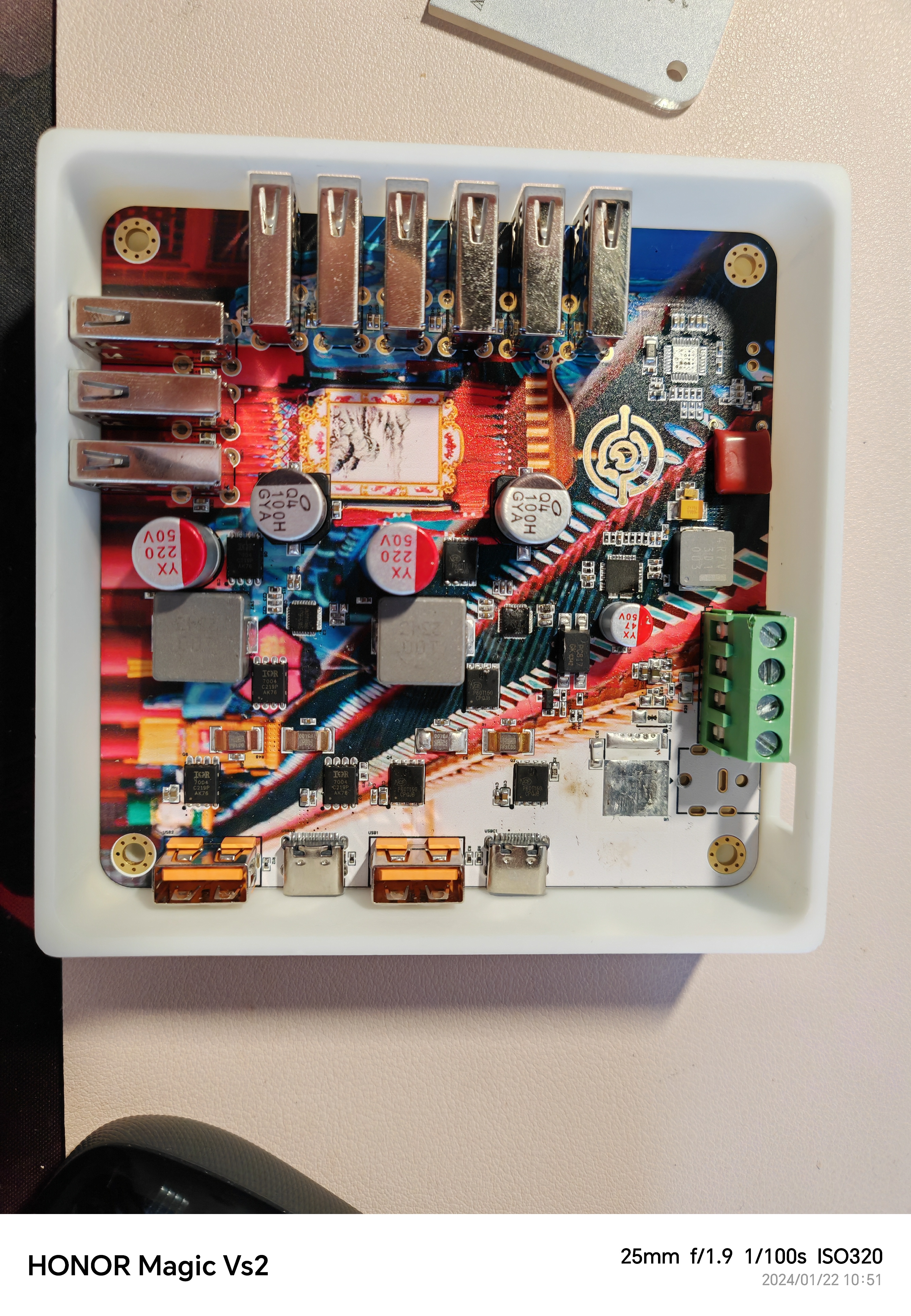

400W power supply
Two SW3666 140W PD charging chips are used, providing two TYPE-C 140W fast charging outputs and two USB-A fast charging outputs.
Through a Visic SIC high-power DC-DC converter, the input voltage is reduced to 5V to provide standard 5V charging for the eight USB-A ports.
Basic IP5266 wireless charging functionality has been verified. Load testing and ripple testing are underway.
