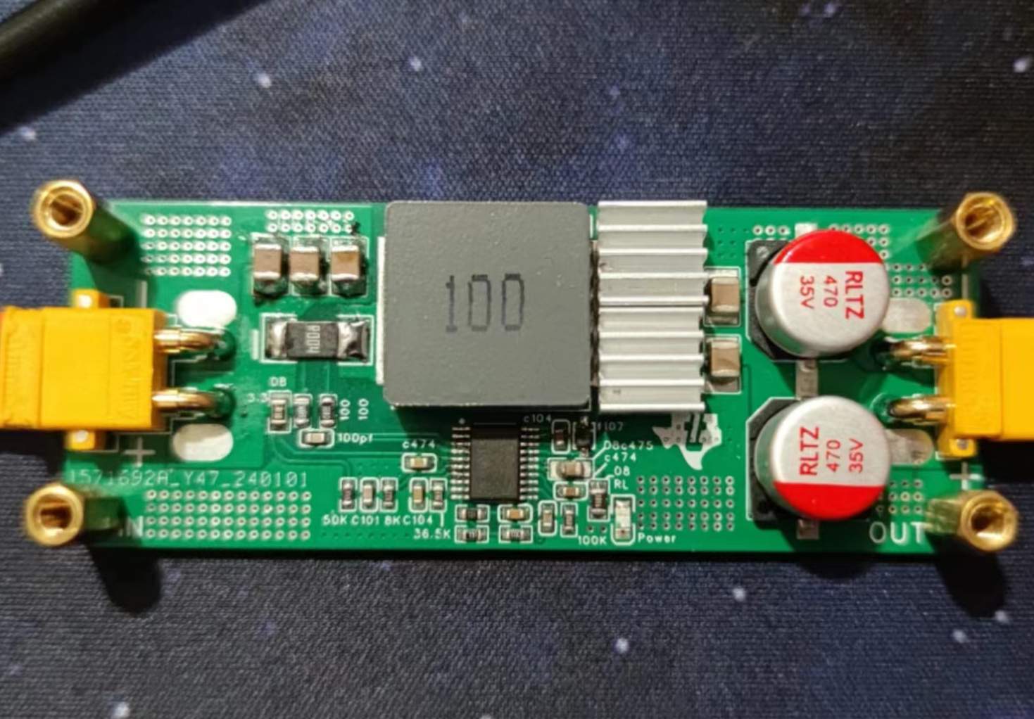

Synchronous BOOST, LM5122, Hakko T12 portable power module, 9~20V input, 24V output.
It uses the LM5122, featuring peak current control and fast response. The application scenario is using a 3S~6S lithium battery to power the T12 soldering iron in emergencies or while in motion, maximizing the capabilities of the Hakko T12 soldering iron.

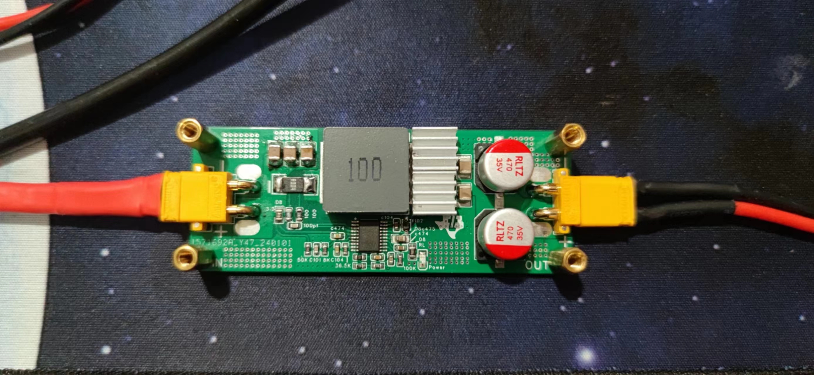

Below is a picture of the actual product:
I didn't notice when drawing it that I used the more expensive LM5122MH model. Those who can afford it can replace it with the cheaper LM5122z model; the only difference is the pinout. I already have one and am too lazy to change it.

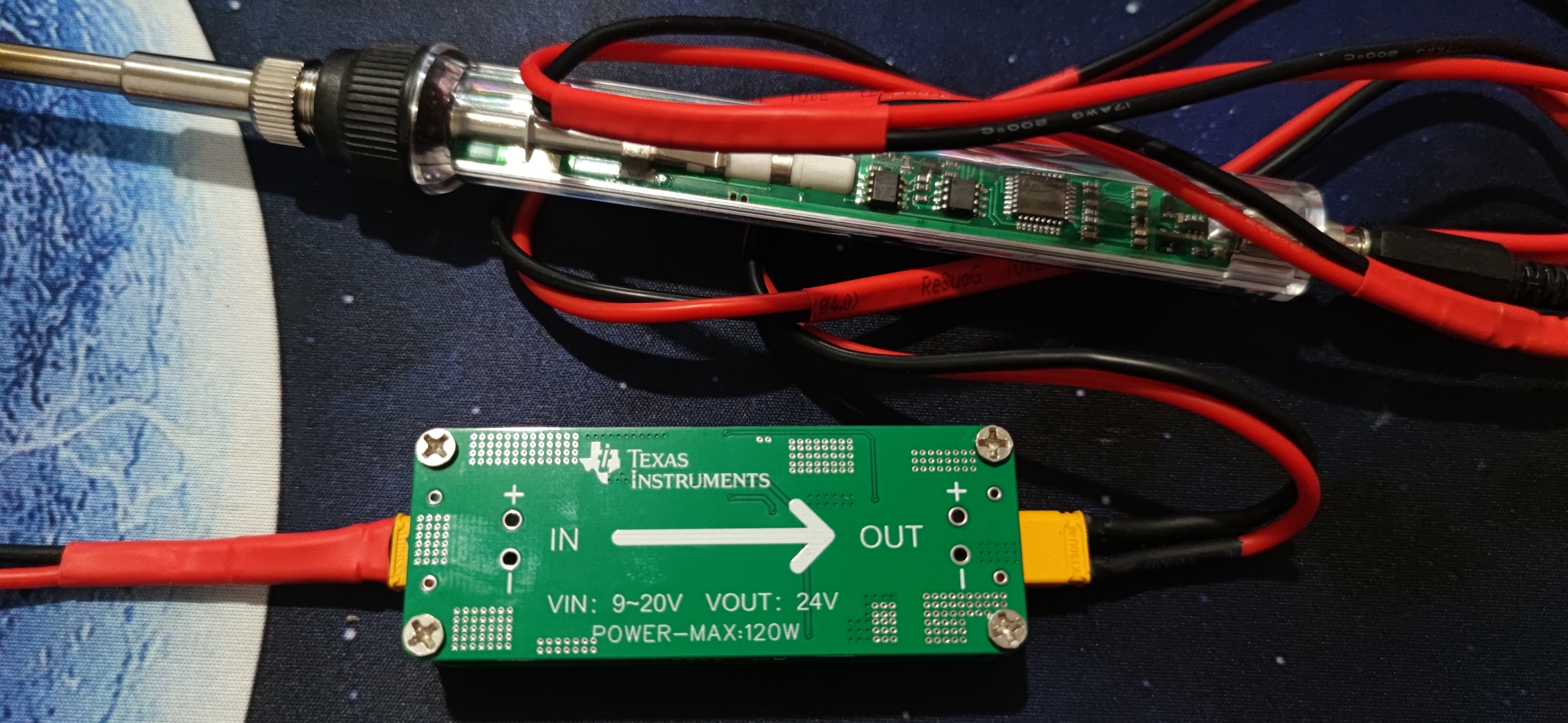

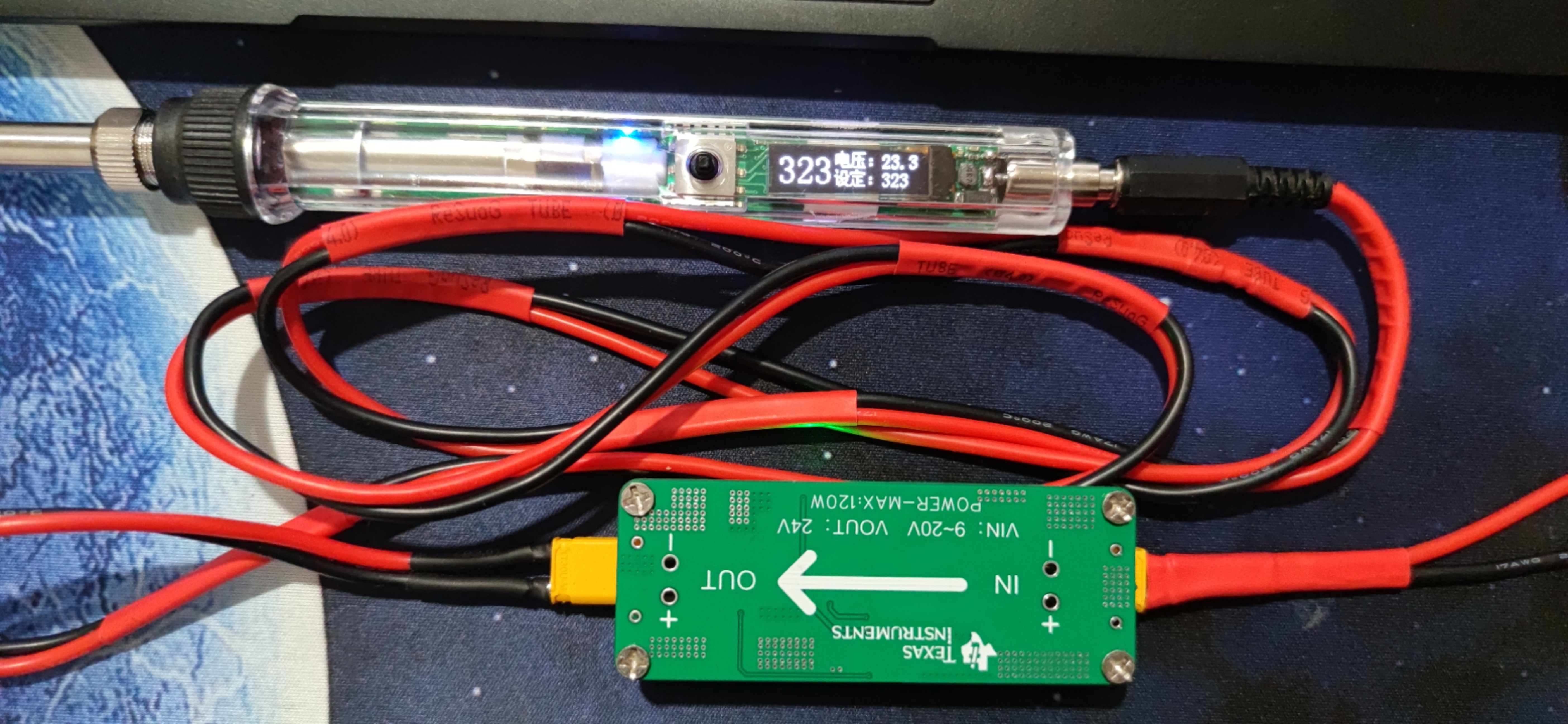

With the T12 soldering iron:
Operating diagram: Measured at 9V input, the output can reach 120W at 24V.
