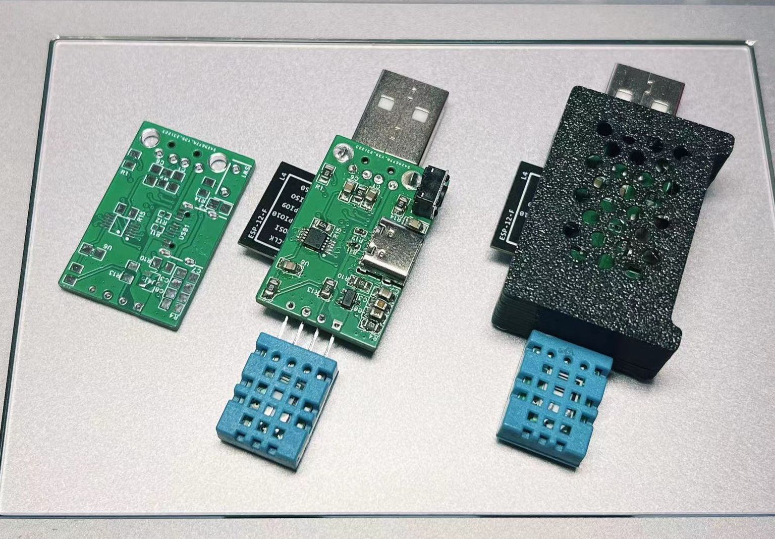

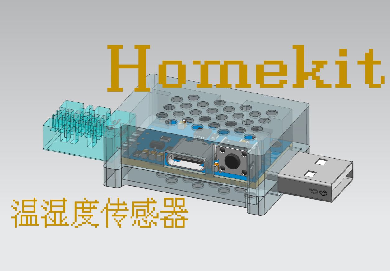

Project Information: http://gofile.me/73GGK/R026bw5a0 Video: https://www.bilibili.com/video/BV1ga4y1m72S This project is a
temperature and
humidity sensor that runs directly connected to HomeKit.
It uses an ESP12F as the controller
and a DHT11 as the sensor. Pin IO5 is used.
It can be powered or programmed via USB-A or Type-C. A CH340X chip can be installed
for serial program transmission and debugging, requiring only a resistor and capacitor for automatic program download.
The software uses the open-source project MIXIAOXIAO, including a self-service Wi-Fi configuration program.
MIXIAOXIAO open-source code GitHub repository: https://github.com/Mixiaoxiao/Arduino-HomeKit-ESP8266
A button is provided for customization; pin IO4 is used, which is optional.

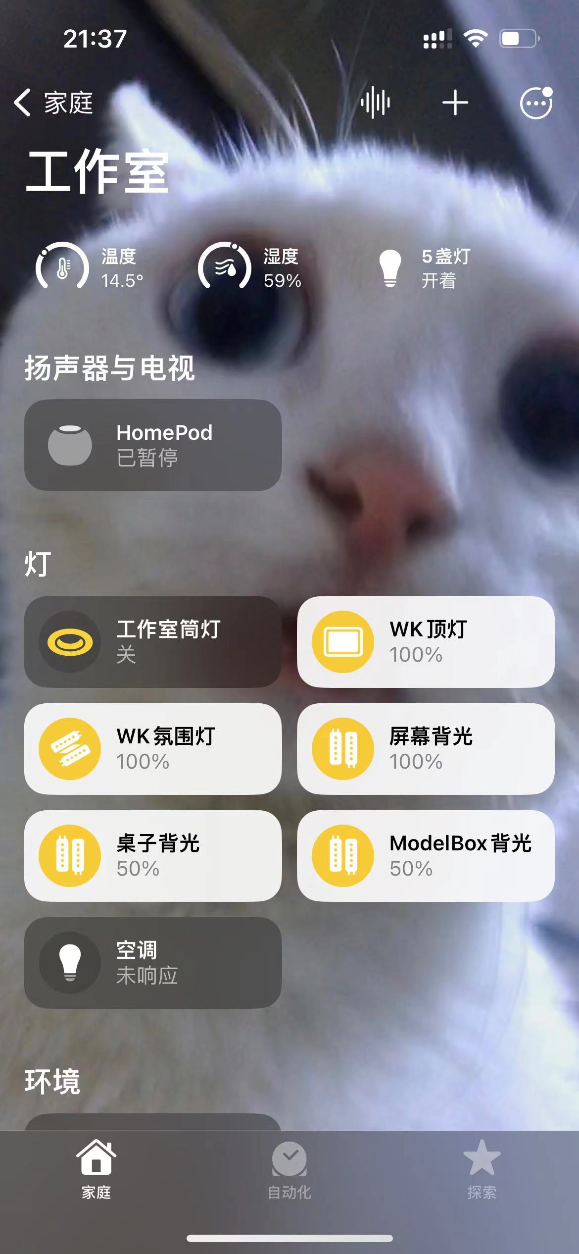

Final Screenshot
