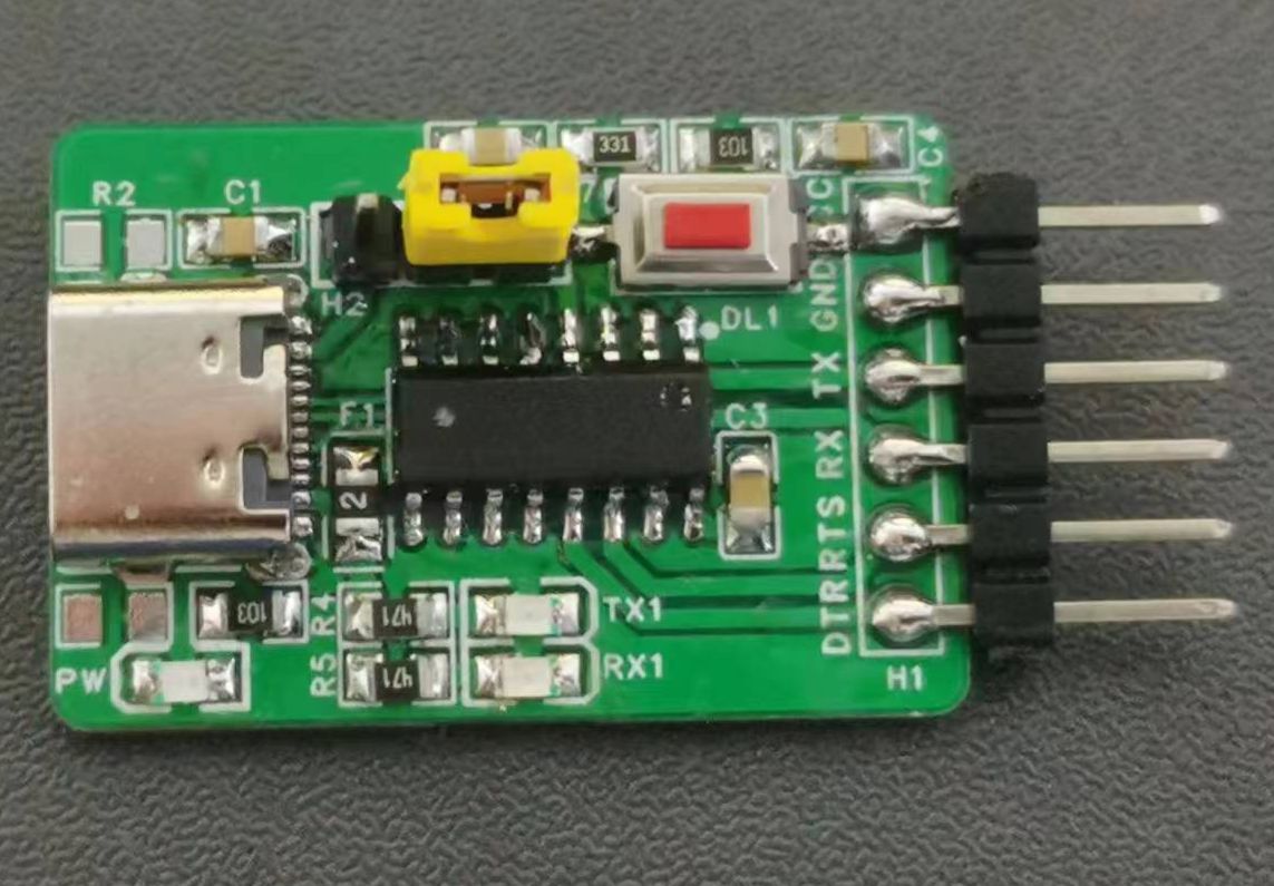

CH340C Programmer
Tested and confirmed to work with STM32, STC51, Arduino, and ESP32 development boards, with one-click automatic download.
PS: Not yet tested because I don't have a GD32. The two resistors on the CC pin of the Type-C port don't need to be soldered.
In practice, the CH340C chip's built-in 3V3V is sufficient for downloading; no additional LDO power supply is needed (a 100nF decoupling capacitor is recommended).
With the shorting cap on the left, it's 5V; with the cap on the right, it's 3.3V.
Version 0.9 has issues; leaving this as a warning to myself.
