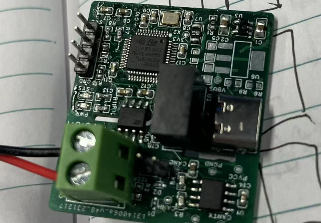

USBCAN (isolated version) DIANCAN
The STM32F072 is used to convert USB information into CAN bus information. The firmware code is still under development. Currently, testing uses Canlight firmware and Cangaroo as the host computer. The BOM has been finalized. The TPS76333 can be replaced with an RT9013 to save costs. The entire set can be purchased from LCSC Mall for approximately 17 RMB, or you can buy it from Taobao. The main controller can be directly replaced with an STM32F042 pintop, allowing direct use of many open-source firmwares.
参考设计图片
