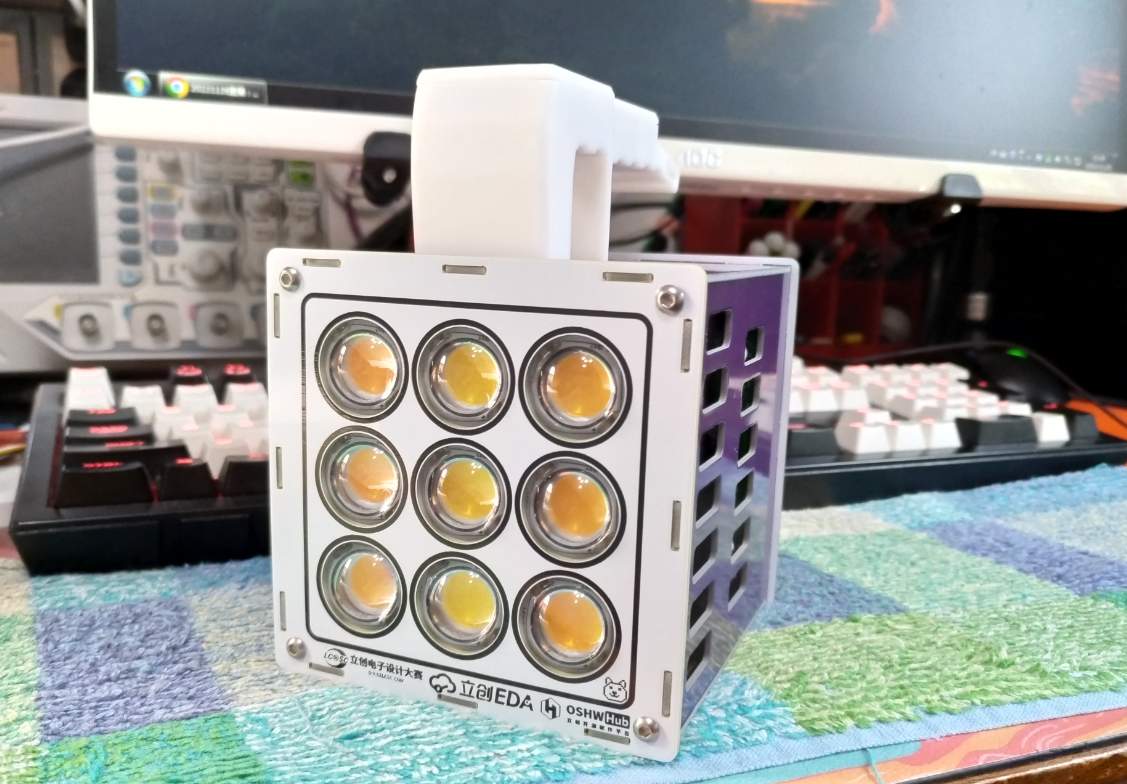

 High-power multi-color temperature flashlight, maximum power 100W, who doesn't want a flashlight in childhood? (bushi)
Continuation of some designs of "Corner Flashlight".
The running account is a bit long-winded, thank you for watching.
Design ideas.
1) Use COB lamp beads. Purpose, COB lamp beads are convenient for heat dissipation, directly contact the aluminum heat sink, and the temperature is low.
         Use CREE COB lamp beads with a maximum power of 12W, voltage 36V. 9 pieces, maximum 108W. 3 series and 3 parallel. Use three color temperature LEDs.
        The lamp beads were bought at 20% off at LiChuang Mall, which are cheap and large. There are three types of 4000K 5000K 6500K.
2) Acrylic lens, 23mm*8mm, low cost, floodlight. About 80 cents each.
3) Use 8cm cooling fan, and can use fans with a thickness of 1-2.5cm. 80*80*20mm aluminum heat sink. It does not overheat when used at full power.
       The fan starts when the temperature of the radiator exceeds 40 degrees.
4) The driver uses three FP7208s, which are boosted to 36V, constant current drive, DC dimming, and no flicker. The three channels can adjust three color temperatures of LEDs respectively.
5) The charging uses CH224K, and the PD is induced to 20V. CN3765, lithium battery charging circuit, maximum 2A.
6) The MCU uses the national technology N32G430C8L7, which is cheap and easy to use, with sufficient performance, and is matched with the OLED screen to display relevant details.
7) For easy carrying, the handle is 3D printed, with an integrated button screen and a TYPE-C charging socket. The 3D Hou printed 8111X resin, a set is about 16 yuan. The
     handle PCB and the main board are connected by a 0.5mm 16P PFC cable. Charging is connected separately with a wire connection, and 20AWG Teflon wire is recommended.
8) The bidirectional current of the battery is detected, and the remaining capacity and remaining usage time can be roughly calculated.

The battery can be external or internal. For internal batteries, it is recommended to use an 8010 thin fan to free up more space. The internal space is enough to accommodate 4 strings of 21700 batteries.
Pay attention to the discharge rate of the battery. The maximum discharge of the flashlight is 9A.
An external battery is used here because there are surplus model aircraft batteries. The battery is fixed with a magic tie.
The battery holder on the upper cover was not installed due to express delivery issues. There is also interference in space.
Similarly, a 1/4 20 tripod screw hole is designed, but the nut was not delivered due to express delivery issues.
