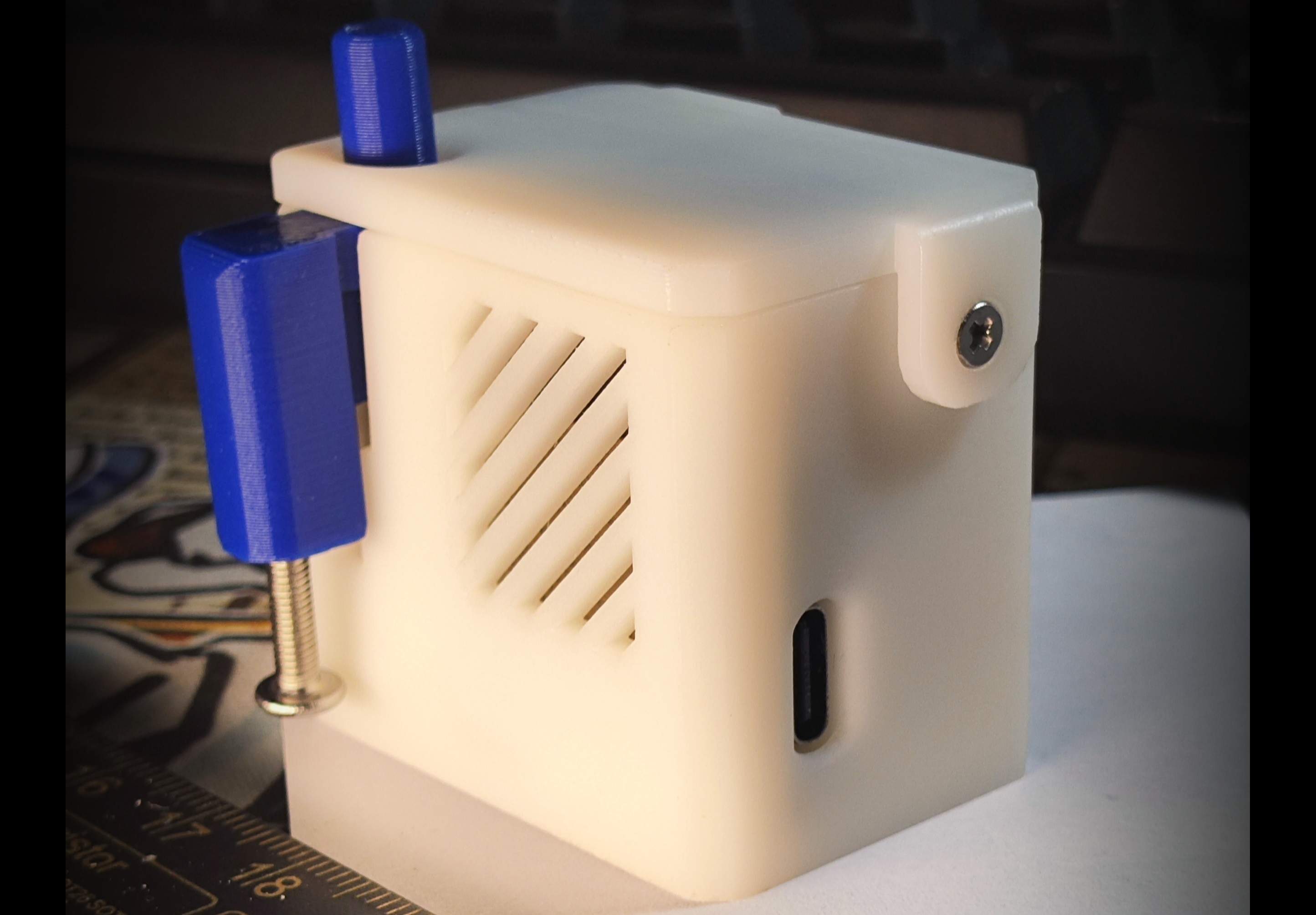

                                                                         Remote Switch Project Overview: This is an innovative project that uses an ESP32 microcontroller connected to the Buffalo Cloud to remotely control physical buttons. It primarily addresses the occasional need to remotely access or manipulate data on my home computer, enabling me to turn it on and off. It also allows me to use the ESP32's Bluetooth keyboard function to input a power-on password.
Product Images:
APP: Shell Model:
Operation Steps: Powering on the Computer: 1. Use the APP to click the power button. 2. Wait for the device to power on and automatically enter the password. 3. Connect using remote connection software such as ParseCard or Sunflower. Extended Functions: Enables switching on/off physical buttons such as lights and sockets. Enables switching on/off touch-sensitive buttons.
Advantages: High expandability: 1. Can simulate Bluetooth keyboard and mouse operation. 2. Complete operation process: WeChat mini-program AP network configuration, automatic reconnection after power failure, storage of WiFi and computer passwords after power failure, watchdog mechanism to prevent crashes. Disadvantages: 1. Insufficient servo motor power (this can be solved by replacing with a larger servo motor).
