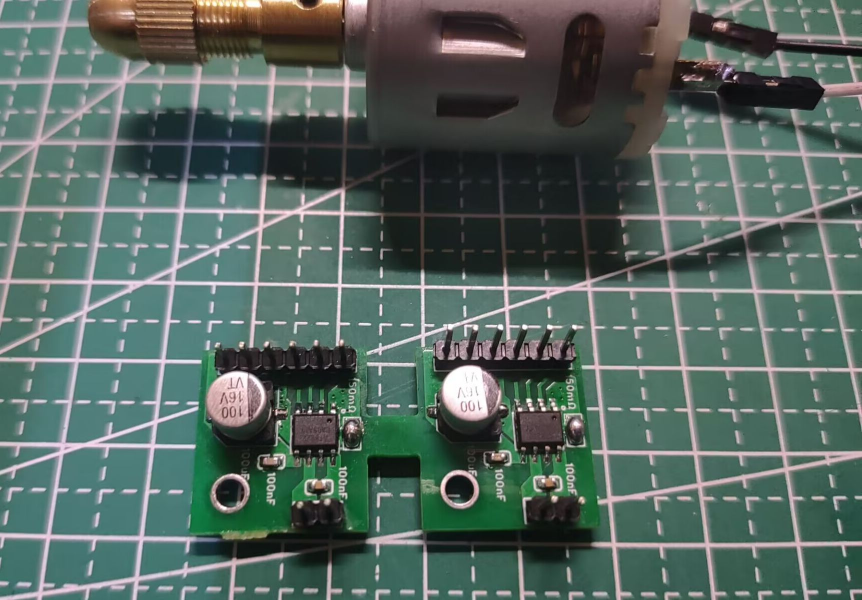

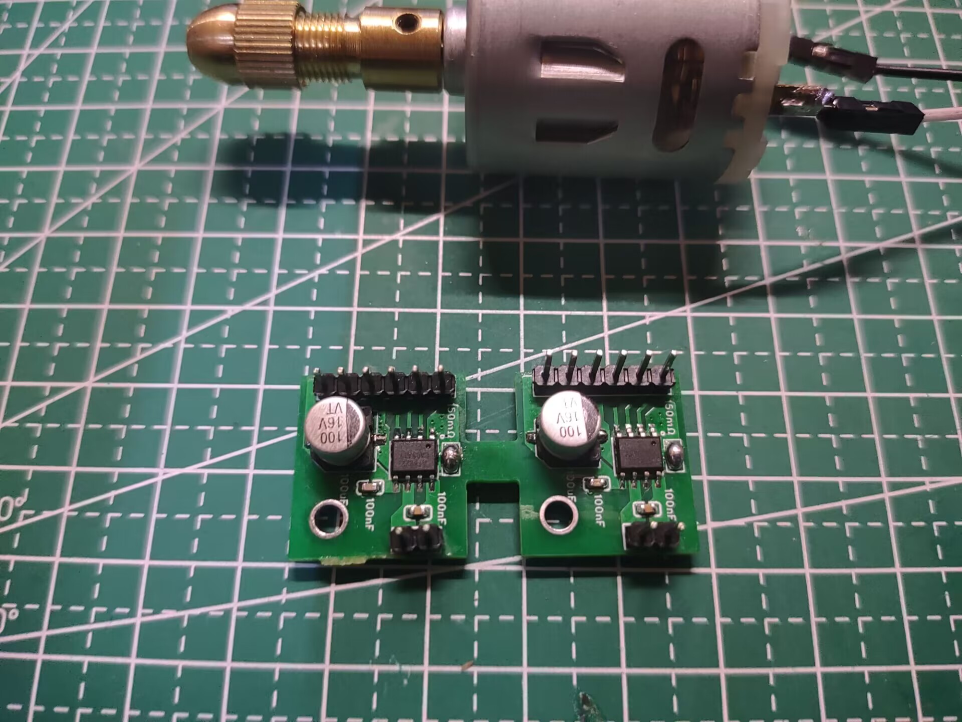

AT8222 DC Motor Drive Test
Overall Board
Usage Instructions:
1. Detailed Wiring :
OUT1, OUT2 ---> Connect to motor;

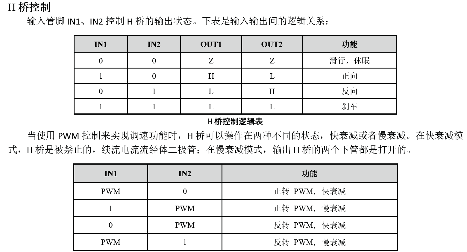

IN1, IN2 --------> Connect to input level signal or control board PWM signal (see control logic section below for details);
VR -------------> Connect to reference voltage (input range 0.5-4V, voltage selection see the final formula);
GND -------------> Connect to signal and drive ground (both must share a common ground!);
HV ------------> Connect to motor drive voltage (5.5-24V, select according to the motor).

Control Logic
