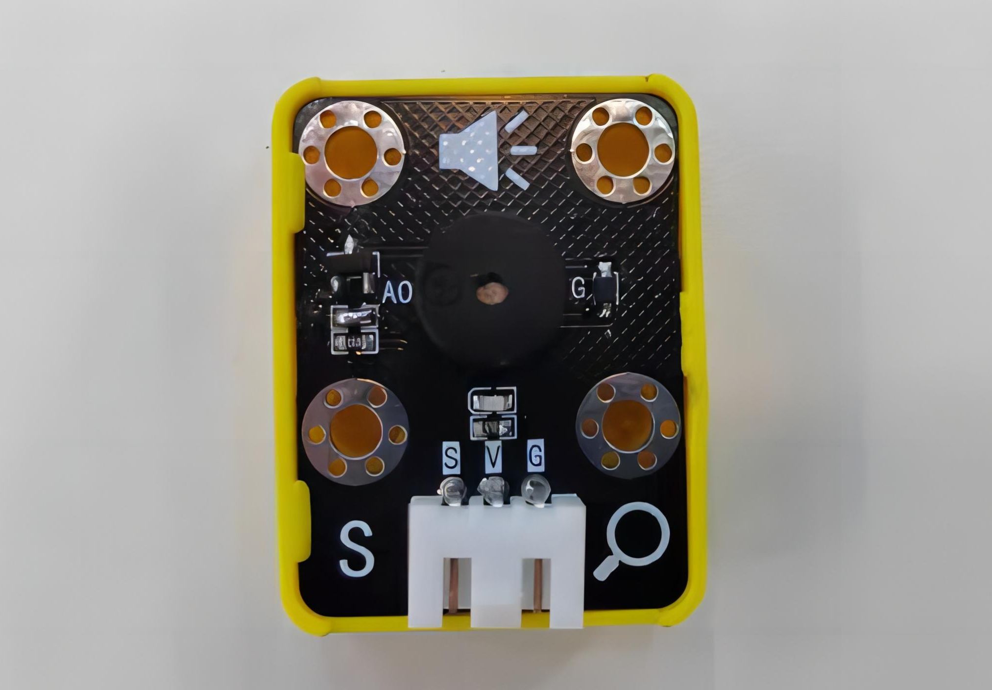

This passive buzzer module is high-level triggered
and comes with a matching 3D shell file

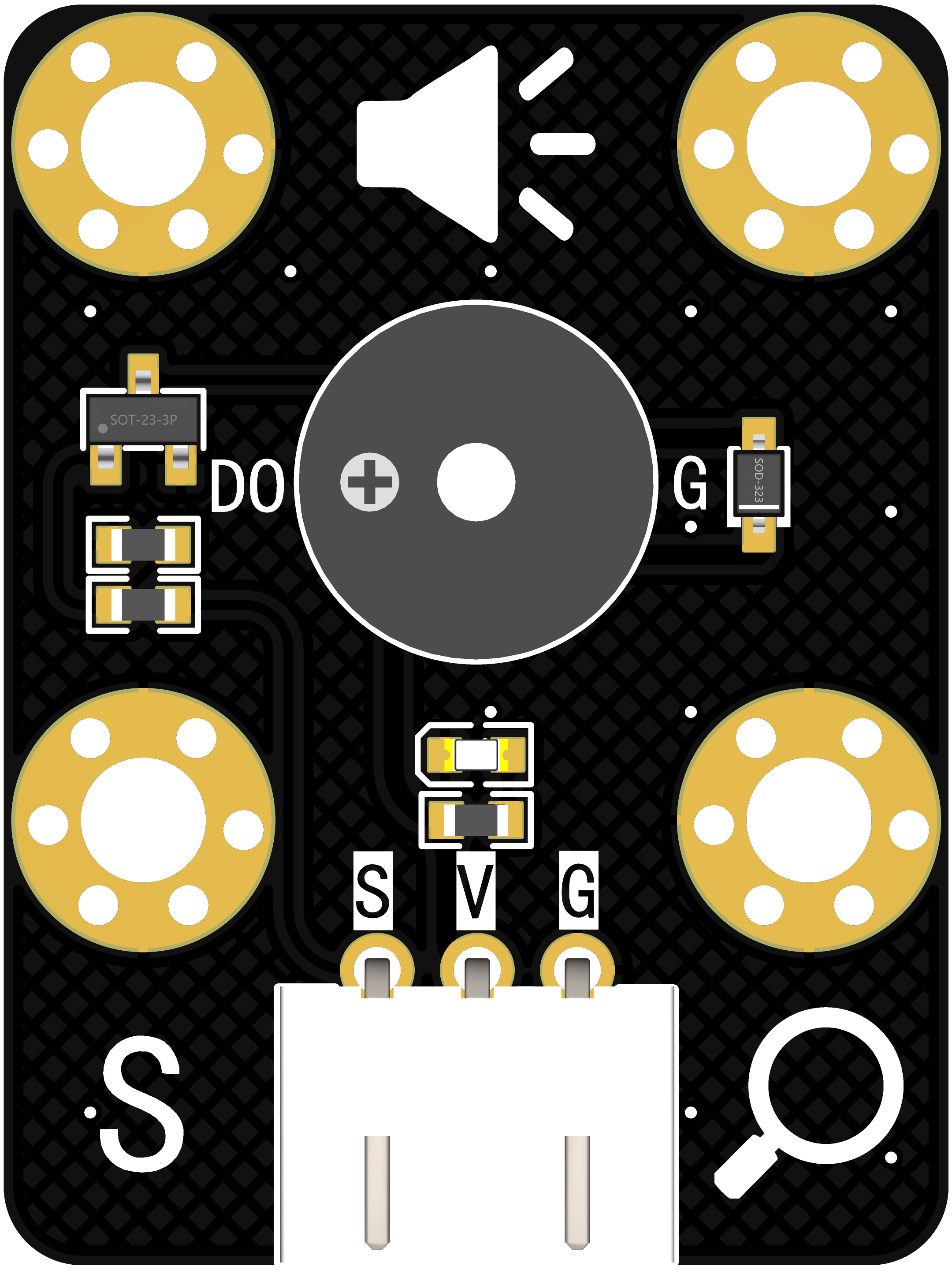

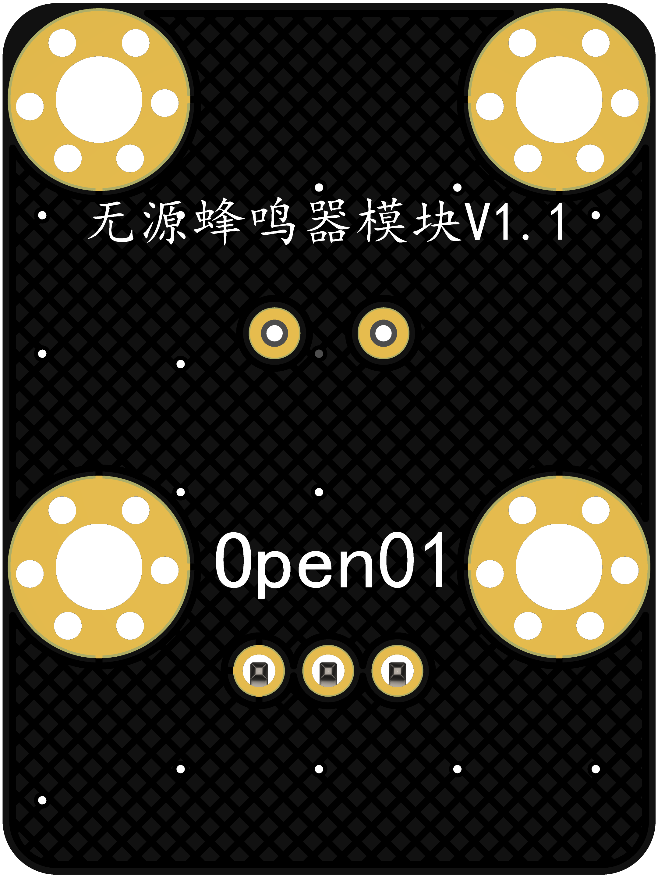

. The design is elegant and incorporates excellent design styles from several online products. II. Renderings
III. Functional Modules
1. Power Indicator
This is a power indicator light. The brightness can be controlled by adjusting the resistance of R1.
2. Passive Buzzer
This passive buzzer module is high-level triggered. R2 is a current-limiting resistor, R3 is a pull-down resistor, and D1 is a freewheeling diode. A standard design, no further explanation needed.
3. Screw Holes
Four screw holes are provided for easy installation.
