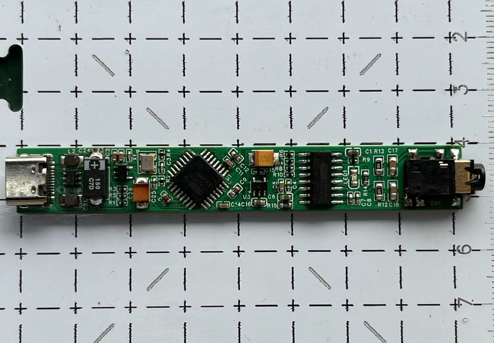

PCM2706C+ES9023P-USBDAC
This is a modified version of the aesthetically pleasing and functional Es9023-USBDAC from JLCPCB's EDA open-source hardware platform (oshwhub.com).
It was changed from Micro USB to Type-C USB, with minor modifications to inductors and other components. The ground plane copper pour was also slightly altered.
The total size is 12*82mm
. The cost on Taobao is approximately 20 RMB (excluding common components like resistors and capacitors).
I recommend using the PCM2707C, as it's cheaper than the PCM2706C.

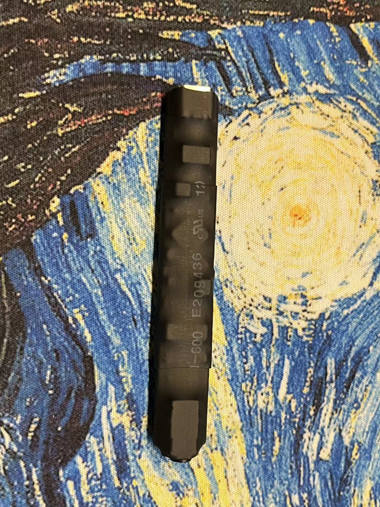

The structural components are naturally unusable; it's wrapped in heat-shrink tubing mainly because the board is small and easy to lose (though you might eventually lose it).
