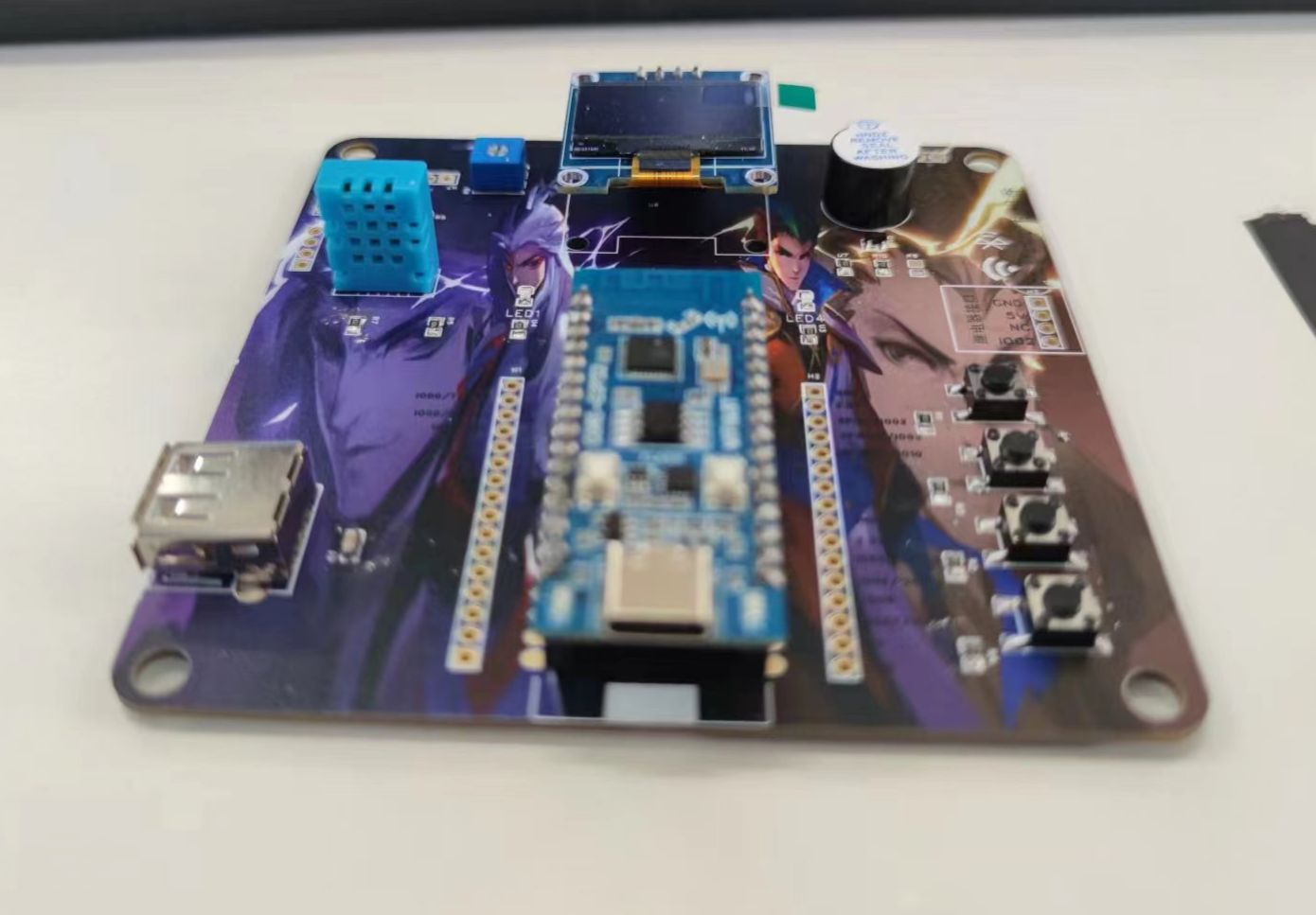

Color circuit board
This system implements buttons, LEDs, OLEDs, a photosensor, a relay, a temperature and humidity sensor, a buzzer, and a sliding rheostat based on an ESP32C3 minimum system board
. The LED module uses 0805-packaged LEDs, suitable for beginners.
The OLED module uses a 4-wire IIC communication OLED; due to the limited pins in the ESP32C3 minimum system, a lower-pin OLED is used.
The photosensor uses a photoresistor with a 10K resistor in series for reading voltage values.
The temperature and humidity sensor uses a cost-effective DHT11 sensor, offering accurate readings and single-bus communication.
The buzzer is an active buzzer, simple and easy to operate.
Finally, color silkscreen printing enhances the overall appearance.
