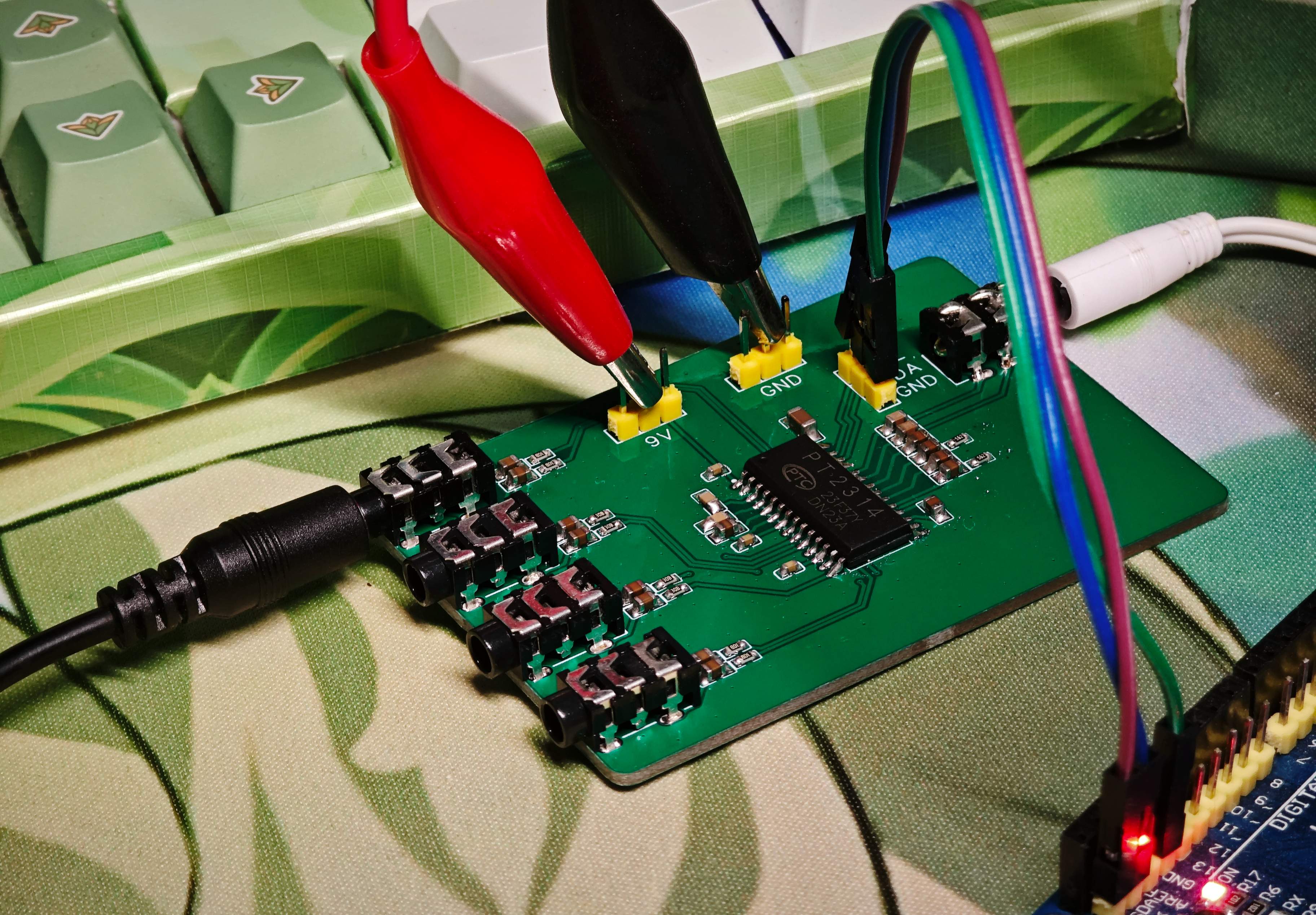

Audio 1-to-4 Electronic Switcher - PT2314
 PT2314 4-Channel Audio Electronic Switcher -
1. Introduction:
The PT2314 is an IIC-controlled 4-channel analog audio electronic switcher with volume control.
It has a 9V power supply, which is somewhat inconvenient; a 5V boost circuit and microcontroller control can be added
. 2. Code:
An existing library is available on the Arduino platform and can be used directly.
`pt.setChannel()` sets the switching channel;
here, the volume is set.
