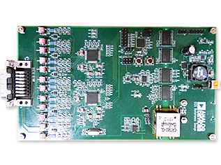

This reference design uses the latest ADAS1000 series of low-power electrocardiogram (ECG) analog front-ends launched by Analog Devices to implement functions such as 12-lead electrocardiogram (ECG) signal measurement, respiration measurement, pacing signal detection, and lead off detection.
The ADAS1000 series provides a low-power, compact data acquisition system for bioelectrical signal applications, designed to simplify the task of acquiring and ensuring high-quality ECG signals. The ADAS1000 series includes a total of 5 models: ADAS1000 , ADAS1000-1 , ADAS1000-2 , ADAS1000-3 , and ADAS1000-4 . Through a single chip or a combination of multiple chips, it can measure electrocardiogram (ECG) signals, chest impedance, pacing artifacts, and lead connection/disconnection status, and output this information in the form of data frames and provide it at a programmable data rate Lead/vector or electrode data. Its low power consumption and small size make it suitable for battery-powered portable applications. It is also a high-performance device, making it suitable for use in high-end diagnostic equipment. <br/

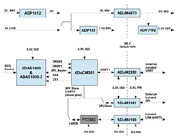

Blockdiagram
