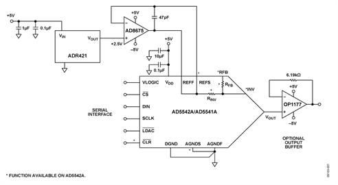

Achieving true 16-bit performance with a voltage-output DAC requires not only selecting the appropriate DAC, but also selecting the appropriate supporting components. For precision 16 digital-to-analog conversion applications, this circuit provides a low-risk solution using the AD5542A / AD5541A voltage output DAC, the ADR421 voltage reference, and the AD8675 ultra-low offset op amp used as the reference voltage buffer.
Reference buffering is critical to the design because the input impedance of the DAC reference input is highly code-dependent, resulting in linearity errors if the DAC reference source is not adequately buffered. The AD8675, with up to 120 dB open loop gain, has been verified and tested to meet the settling time, offset voltage, and low impedance drive capability requirements of this circuit application.
The precision, low offset OP1177 can be used as an optional output buffer when required.
This combination of devices delivers industry-leading 16-bit resolution, ±1 LSB integral nonlinearity (INL) and ±1 LSB differential nonlinearity (DNL), ensuring monotonicity, along with low power consumption, a small PCB and high cost performance and other characteristics.

This circuit uses the voltage output DAC AD5542A, which provides true 16-bit INL and DNL. The DAC architecture of the AD5541A/AD5542A is a segmented R-2R voltage mode DAC. With this configuration, the output impedance is code independent, while the input impedance of the reference is highly code dependent. Therefore, the selection of the reference voltage buffer is very important for the handling of code-dependent reference current. If the DAC reference voltage buffer is insufficient, linearity errors may result. The op amp's open-loop gain, offset voltage, offset error temperature coefficient, and voltage noise are also important selection criteria when selecting a reference voltage buffer for use with a precision voltage output DAC. Offset errors in the reference circuit can cause gain errors at the DAC output.

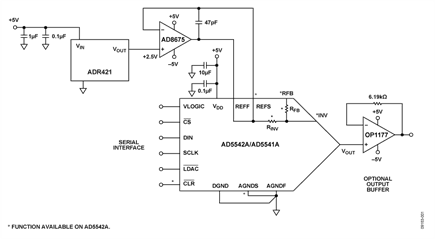

This circuit uses the AD8675 op amp in a drive/sense configuration (Kelvin sensing) as a low-impedance output reference voltage buffer for the AD5542A. The AD8675 has an open-loop gain of 120 dB and is a precision, 36 V, 2.8 nV/√Hz operational amplifier. With a typical offset voltage of 10 µV, typical temperature drift of less than 0.2 µV/°C, and noise of 0.1 µV pp (0 Hz to 10 Hz), the AD8675 is ideally suited for applications requiring minimal error sources.
AD5542A has two operating modes: buffered mode and non-buffered mode. Which operating mode is used depends on the specific application and its settling time, load impedance, noise, etc. requirements. The output buffer can be selected to optimize DC accuracy or fast settling time. The optional output amplifier used in this circuit is the high-precision OP1177. The output impedance of the DAC is constant (typically 6.25 kΩ) and is code independent, but to minimize gain errors, the input impedance of the output amplifier should be as high as possible. The output amplifier should also have a 3 dB bandwidth of 1 MHz or higher. The output amplifier adds another time constant to the system, thus extending the settling time of the output. The wider the bandwidth of the op amp, the shorter the effective settling time of the DAC and amplifier combination.
The device combination shown in Figure 1 achieves minimal PCB area. The AD5542A is available in a 3 mm × 3 mm, 16-lead LFCSP or 16-lead TSSOP package. The AD5541A is available in a 3 mm × 3 mm, 10-lead LFCSP or 10-lead MSOP package.
Note that the AD5541A does not include the Kelvin sense lines for the reference voltage and ground, the clear function, and the R FB and R INV resistors.
The AD8675 and ADR421 are available in 8-pin MSOP or SOIC packages, and the OP1177 is available in an 8-pin MSOP package.
The optional output op amp is the OP1177 in a unity-gain configuration, which includes a 6.19 kΩ resistor in series with the inverting input. This resistor is used to cancel the bias current and match the output resistance of the AD5542A, which is approximately 6.25 kΩ ± 20%.
Measurement results indicate that the AD5542A/AD5541A are ideal for high-precision, low-noise level setting applications. In this high-precision, high-performance system, DC performance levels are maintained through the ADR421 reference and the AD8675 reference buffer. Measurements are made directly on V OUT without the optional output buffer connected.

Integral nonlinearity (INL) error refers to the deviation of the actual DAC transfer function from the ideal transfer function, expressed in LSB. Differential nonlinearity (DNL) error is the difference between the actual step size and the ideal value of 1 LSB. The circuit shown in Figure 1 provides 16-bit resolution with ±1 LSB DNL and INL. Figures 2 and 3 show the DNL and INL performance of this circuit.

In any circuit where precision is important, power and ground return layout on the circuit board must be carefully considered. The printed circuit board (PCB) containing this circuit should have the analog portion separated from the digital portion. If this circuit contains other devices in the system that require an AGND to DGND connection, the connection can only be made at one point. This ground point should be as close as possible to the AD5542A/AD5541A. This circuit should use a multi-layer PCB with larger area ground and power layers. For more discussion on layout and grounding, please refer to tutorial MT-031 .
The AD5542A/AD5541A power supplies should be bypassed with 10 μF and 0.1 μF capacitors. These capacitors should be placed as close to the device as possible, with the 0.1 μF capacitor ideally facing the upper right side of the device. The 10 μF capacitor should be a tantalum bead or ceramic type capacitor. The 0.1 μF capacitor must have low equivalent series resistance (ESR) and low equivalent series inductance (ESL), which are typically found in ordinary ceramic capacitors.
The 0.1 μF capacitor provides a low-impedance path to ground for high frequencies caused by transient currents caused by internal logic switches. For more information on proper decoupling techniques, please refer to Tutorial MT-101 .
Power traces should be as wide as possible to provide a low impedance path and reduce the effects of glitches on the power lines. Clocks and other fast-switching digital signals should be digitally shielded from other devices on the board.
