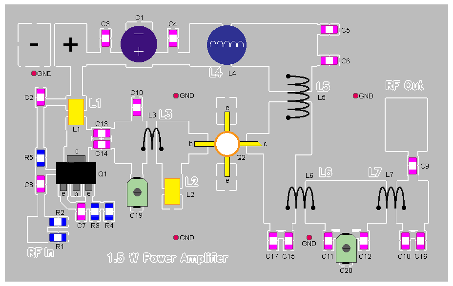

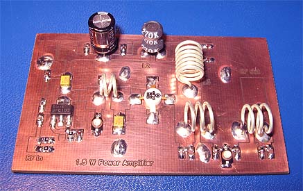

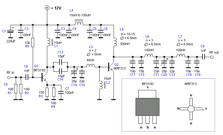

1.5W VHF amplifier
This project will explain the basic functions of a Class C transmitter. I will explain how to design the transmitter and the purpose of the different components. I will also explain how to build a 1.5W PA transmitter. The project will include instructions on the PCB, components, and how to fabricate the coils, assemble, and test.
