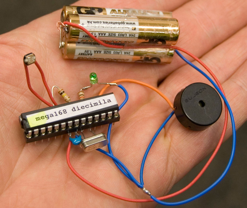

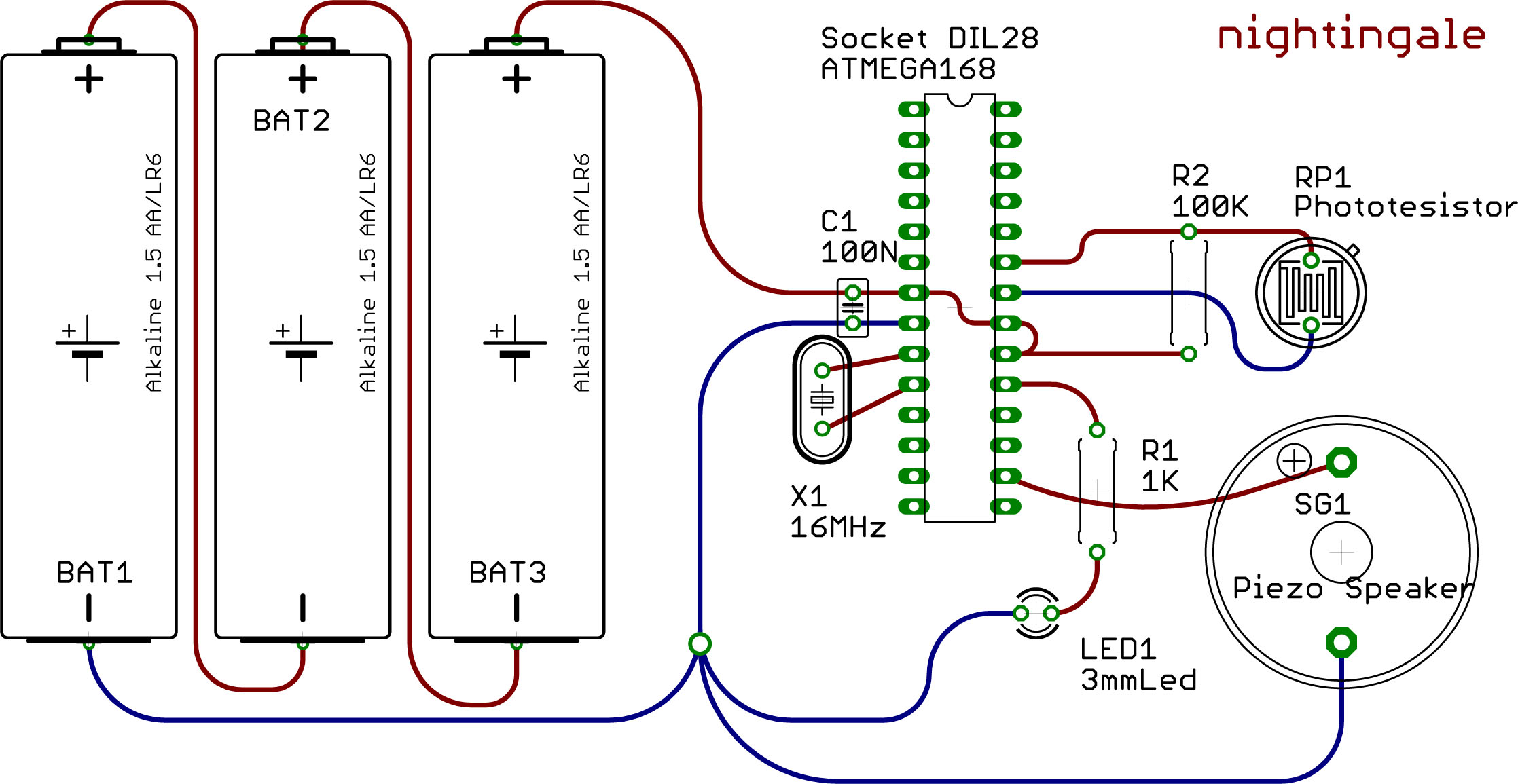

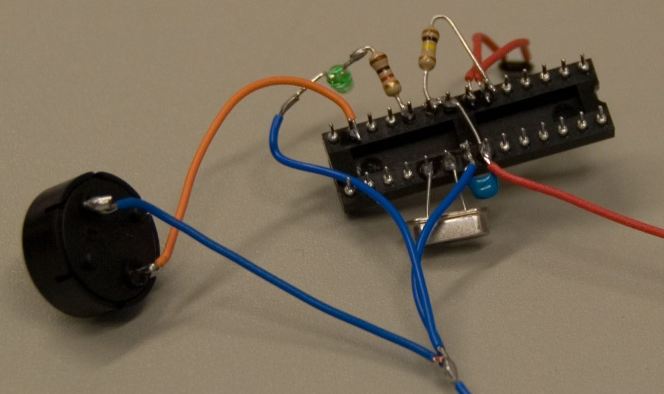

To demonstrate the watchdog and sleep functionality, we built a small device to measure daylight and activate a sound when night falls. We're not using Arduino hardware here because the USB chip and voltage regulator consume too much power in sleep mode. Therefore, we soldered a small circuit around a 28-pin DIL socket and plugged in an ATMEGA chip from the original Arduino board after uploading the code.
Arduino Minimum Hardware / Nightingale Schematic

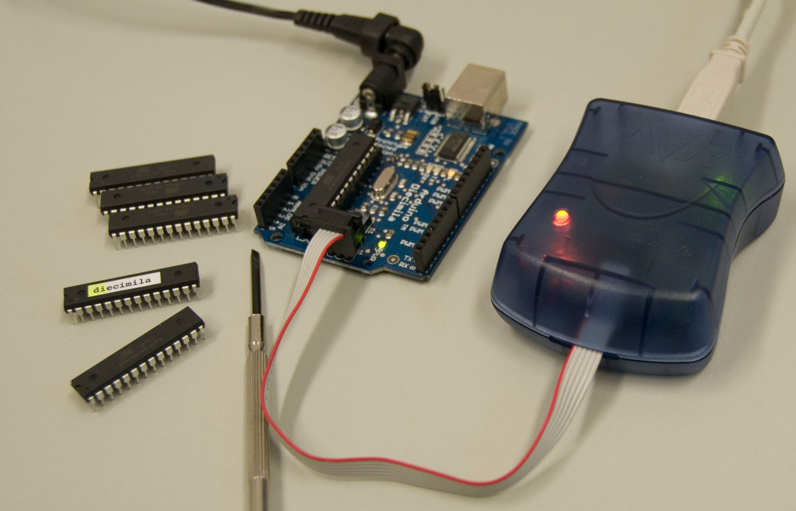

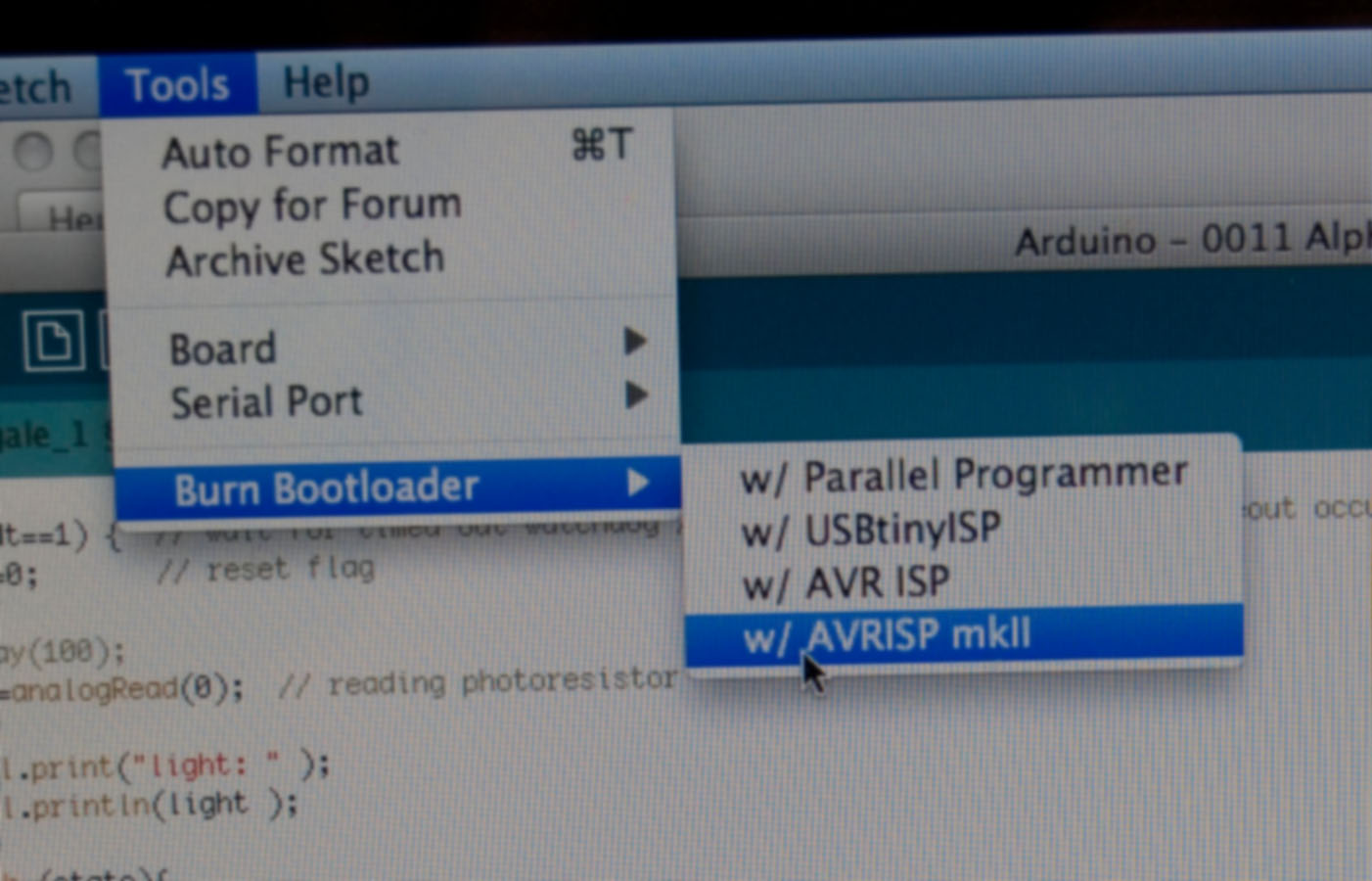

Burn the bootloader
Instead of damaging the ATMEGA chip on the Arduino board, we recommend purchasing some blank ATMEGA 168 PU-20 chips and burning a bootloader onto them. All you'll need is an AVRIPS-MKII programmer (inexpensive) and a 9-volt DC power supply to run the Arduino board, which doesn't have a USB port. When removing the chip, be careful not to bend the IC pins; a screwdriver is a useful tool for this task.
