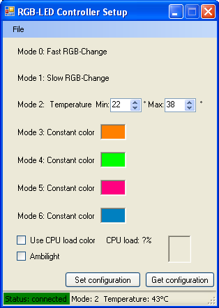

This project is a full-color LED controller that can be configured via USB connection. The color of the connected LEDs (common anode only) depends on the selected operating mode:
Slow color change (approximately 40 minutes)
Rapid color change (approximately 2 minutes)
Temperature-based color (temperature range adjustable)
Constant Color 1
Constant Color 2
Constant Color 3
Constant Color 4
In color-changing mode, the LEDs automatically cycle through all possible colors of the rainbow within a certain time period.
In temperature-based mode, the color changes according to the temperature measured by the DS1821 sensor. At home, I use this mode to light it up based on the temperature of the radiator.
In constant color mode, the LED color is constant, but it can be configured via USB using a C# Windows application.
Using this application, the circuit can also be used to light up LEDs, changing the color from blue to red, depending on the PC's CPU load or the screen content.

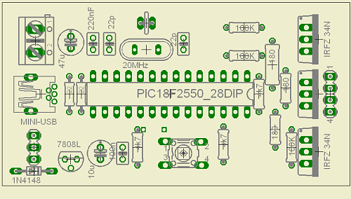

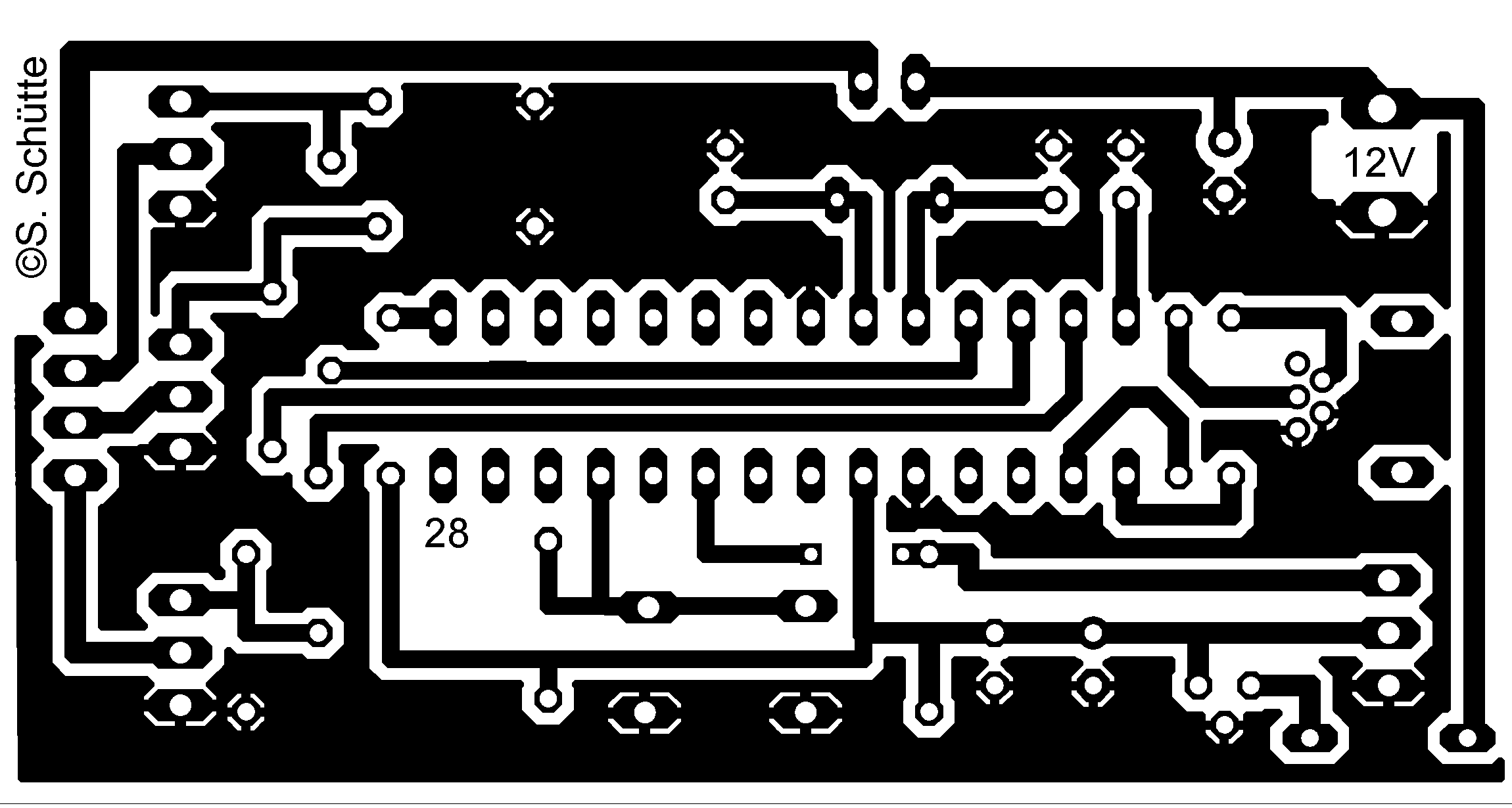

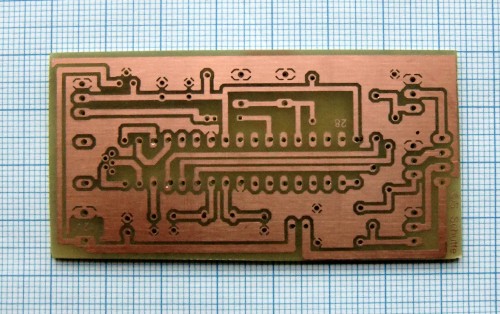

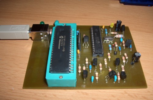

First, a PCB needs to be created. The image above shows the PCB layout. The Eagle file is included in the project download.

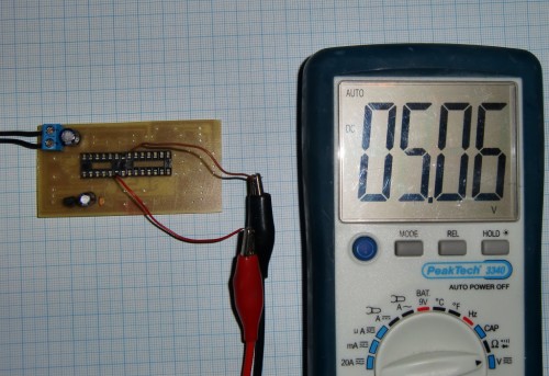

Next, solder the 5V components required to power the microcontroller onto the PCB. Once completed, supply 12V and check that the microcontroller has 5V (pin 8 = GND, pin 20 = +5V). Then, you can solder the remaining components.

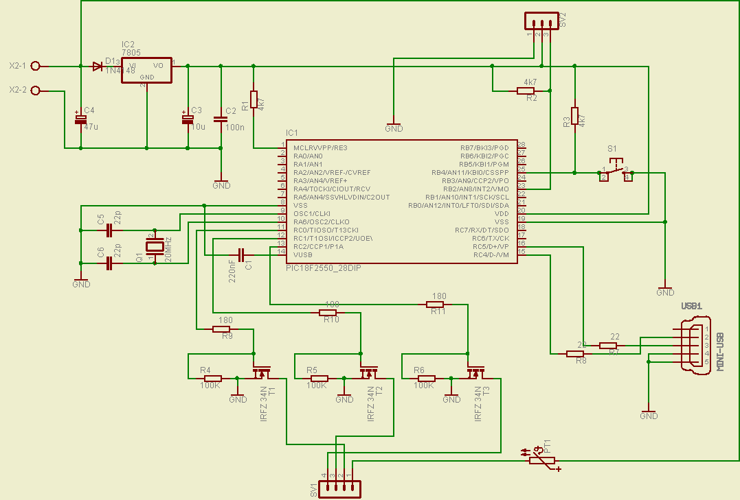

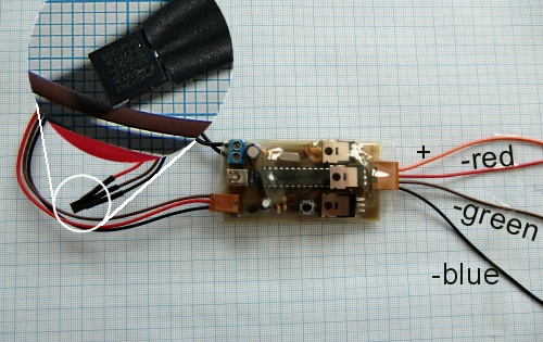

The diagram below shows how to connect the LED strip (common anode) and the wiring of the DS18S20.

If you now launch the Windows application (ConfigurationUIRGBConfigurator inDebugRGBConfigurator.exe), you should be able to configure the PIC according to your needs, as shown in the first image above.

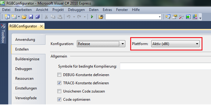

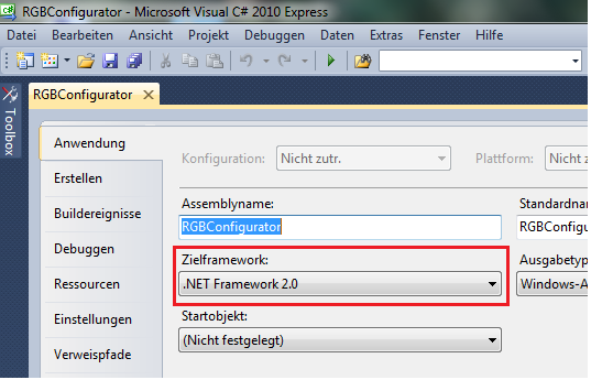

To launch on Windows 7, please use this version of the software. It uses a newer version of the Microchip USB API DLL (mpusbapi.dll, version 2.6a) and is compiled with the correct options to work on 64-bit systems.
