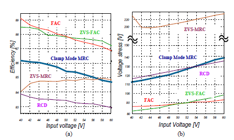

We compared the results using various methods with the two main properties that all of these methods attempt to improve: efficiency and voltage stress. Figure 2 supports Leu's conclusion that ACF (called FAC in Figure 1) has the best performance, providing the lowest stress and the highest efficiency.
Figure 2: Comparison of efficiency and voltage stress in a forward converter

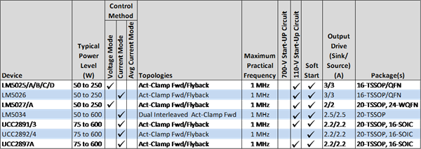

Texas Instruments (TI) has several ACF topologies to choose from, as shown in Table 1, the most popular of which are the LM5025A voltage mode and the UCC2897A current mode.
The LM5025A PWM controller contains all the functions required to implement a power converter using active clamp/reset technology. Using active clamp technology can achieve higher efficiency and higher power density compared to traditional capture winding or RDC clamp/reset techniques. Two control outputs are provided: main power switch control (OUT_A) and active clamp switch control (OUT_B). Two internal composite gate drivers parallel MOS and bipolar devices to provide superior gate drive characteristics. The controller is designed for high-speed operation, including an oscillator frequency range of up to 1MHz and a total PWM and current sense propagation delay of less than 100ns. The LM5025A includes a high-voltage startup regulator that operates over a wide input range of 13 V to 90 V. Other features include: line undervoltage lockout (UVLO), soft start, oscillator upper and lower synchronization functions, precise reference and thermal shutdown.
The UCC2897A is a peak current mode fixed frequency high performance pulse width modulator. The controller includes logic and drive capability for the P channel auxiliary switch, as well as a simple method to program critical delays for proper active clamping operation. Features include an internal programmable slope compensation circuit, precise D-MAX limiting, and a synchronized oscillator with internal timing capacitors. Accurate line monitoring also programs the on and off transitions of the converter based on the bulk input voltage VIN. The UCC2897A adds secondary hiccup mode current detection thresholds, bidirectional synchronization, and input overvoltage protection. The UCC2897A is available in 20-pin TSSOP (PW) and 20-pin QFN (RGP) packages.
Table 1: Texas Instruments ACF devices
