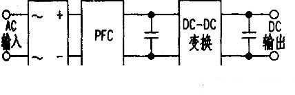

The traditional switching power supply structure is shown in the figure on the right, which connects the power factor correction circuit (PFC) and the DC-DC conversion circuit in series. As a result, the efficiency is low and it is quite difficult to reduce the standby power.

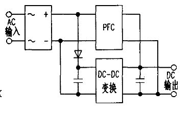

The structure of the switching power supply of this design is shown in the left figure, which can be called a hybrid parallel mode. By adopting an excellent DC/DC conversion IC, supplemented by voltage feedback and measures to increase the conduction angle, this switching power supply is within the power range of 70 to 350W. The efficiency is over 90%, the standby power is only 0.1W, and the suppression of high-order harmonics has also reached Class D of the IEC61000-3-2 specification (applicable to LCD TVs, monitors, and computers).

The whole circuit is shown in the figure below. The AC power is rectified by BD1 after passing through the common mode choke coil Lcm; L1, Cl, and C2 form a bamboo filter (the capacity of Cl and C2 is very small, and the waveform is still pulsating after filtering); PT is used to suppress surge current. The pulsating DC voltage after rectification and filtering passes through the primary winding of transformer T1 and diode D3 and is turned on and off by the field effect tube in ICl. The pulsating DC voltage is output from the secondary winding of T1 through D7.
The other DC voltage obtained after filtering by D2 and C3 is turned on and off by the field effect tube through the primary winding of T2. The DC voltage is output from the secondary winding of T2 through D8 and D9.
As a result, the pulsating DC voltage and the DC voltage are added and output, which makes the output waveform have large ripples, but the ripples disappear after adding feedback. The 6t coil, inductor L2 and diode D1 are specially designed in the circuit to suppress high-order harmonics.
A π-type filter composed of C10, L3, and C11 is added to the output end of the circuit. When the transformer secondary voltage exceeds the voltage on the filter capacitor, the current waveform flowing through the inductor and the diode becomes a triangular wave. After being averaged by the π-type filter, it is equivalent to expanding the conduction angle, reducing the peak current, and thus suppressing high-order harmonics.
