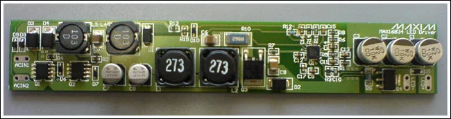

The LED driver reference design discussed in this article uses PWM dimming to solve these basic problems. This LED driver uses chopper PWM dimming without causing any supply current overshoot. The design features up to 90% efficiency and operates at 24V. One-way power input is allowed, with a MOSFET half-bridge at the input. Figure 1 shows the top layer of the design board.
参考设计图片
