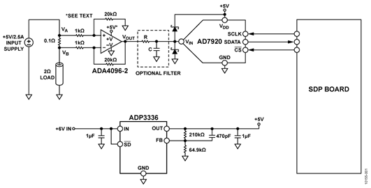

High-side current monitors may experience overvoltage conditions after a transient, or when the monitoring circuit is connected, disconnected, or turned off. The circuit shown in Figure 1 uses an ADA4096-2 op amp with overvoltage protection connected as a differential amplifier to monitor high-side current. The ADA4096-2 has input overvoltage protection so that no inversion or latch-up will occur up to 32 V above or below the supply rail.
The circuit is powered by the ADP3336 adjustable low dropout 500 mA linear regulator , which can also be used to power other components in the system if required. When set to 5 V output, the input voltage range is 5.2 V to 12 V. To save power, the current sensing circuit can be turned off by removing the ADP3336 power supply, while the power source (such as a solar panel) can still operate.
Figure 1. High-side current sensing with input overvoltage protection (schematic diagram: all connections and decoupling not shown)
This voltage will be applied to the unpowered ADA4096-2 input; however, no latch-up or damage will occur for input voltages within 32 V of the supply rails. For lower throughput rates, the AD7920 can also sleep between samples. The maximum power consumption of the AD7920 is 5 ¬W in sleep and 15 mW when powered up. Under operating conditions, the ADA4096-2 requires only 120 μA. When the operating voltage is 5 V, the power consumption is only 0.6 mW. In shutdown mode, the ADP3336 consumes only 1 μA.
Circuit description
This circuit is a classic high-side current sensing circuit topology using a single sense resistor. The other four resistors (dual 1 kΩ/20 kΩ divider) are within the membrane network (for ratio matching) and set the differential amplifier gain. This amplifies the difference between the two voltages developed across the sense resistor and suppresses the common-mode voltage:
V OUT = (V A – V B ) (20 kΩ/1 kΩ)

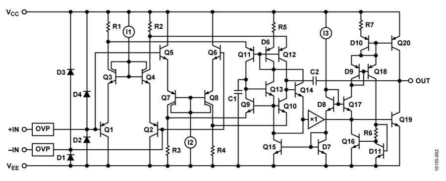

Figure 2 shows the schematic diagram of the ADA4096-2. The input stage contains two parallel differential pairs (Q1 to Q4 and Q5 to Q8). As the input common-mode voltage approaches V cc -1.5 V, Q1 through Q4 turn off when I1 reaches the minimum compliance voltage. Conversely, as the input common-mode voltage approaches V EE + 1.5 V, Q5 through Q8 turn off when I2 reaches its minimum compliance voltage. This topology achieves maximum input dynamic range because the amplifier can handle the input at 200 mV outside the supply rail (room temperature).
Figure 2. ADA4096-2 schematic diagram
As with any rail-to-rail input amplifier, the V OS mismatch between the two input pairs determines the amplifier's CMRR. If the input common-mode voltage range is kept within 1.5 V of each supply rail, transitions between input pairs can be avoided, improving CMRR by approximately 10 dB.
The ADA4096-2 input protects the device from input voltage excursions up to 32 V beyond each supply rail. This feature is particularly important in applications with power supply sequencing issues that can cause the signal source to become active before amplifier power is applied.

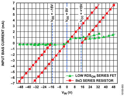

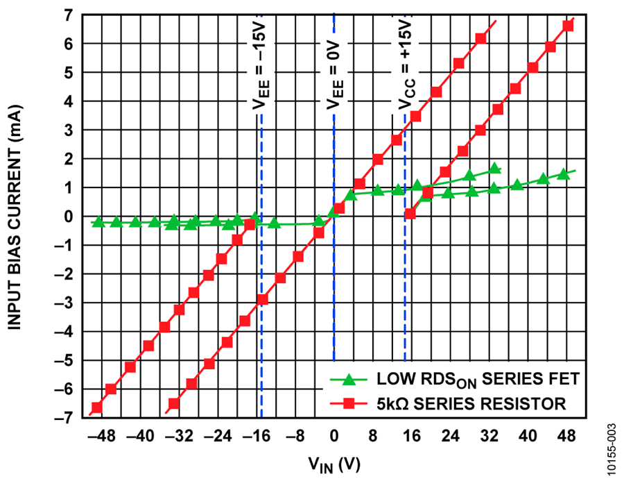

Figure 3 shows the input current limiting capability of the ADA4096-2 provided by a low RDSON internal series FET (green curve) compared to using an external 5 kΩ series resistor and an unprotected op amp (red curve).
Figure 3 shows the ADA4096-2 in a unity-gain buffer configuration, where the supply is connected to GND (or ±15 V) and the positive input is swept until the input exceeds the supply by 32 V. Generally, the input current is limited to 1 mA during positive overvoltage conditions and 200 µA during negative undervoltage conditions. For example, under a 20 V overvoltage condition, the ADA4096-2 input current is limited to 1 mA, providing a current limit equivalent to a series 20 kΩ resistor.
Figure 3 also shows that the current limit circuit is effective whether or not the amplifier is powered.
Please note that Figure 3 only represents input protection under abnormal conditions. See Table 2 through Table 4 of the ADA4096-2 data sheet for the correct amplifier operating input voltage range (IVR).
Figure 3. Input current limit capability
