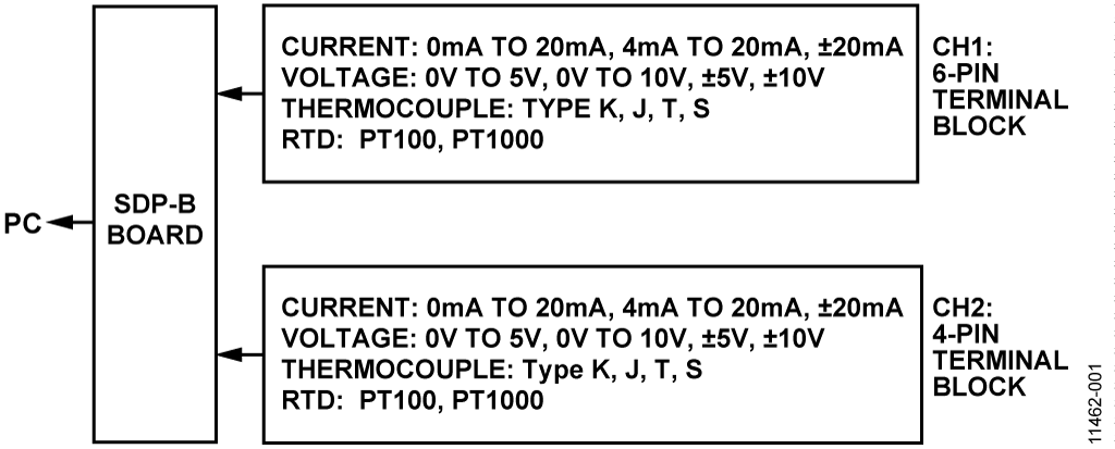

The circuit shown in Figure 1 provides two 16-bit, fully isolated, general-purpose analog input channels suitable for programmable logic controller (PLC) and distributed control system (DCS) modules. Both channels support software programming, as well as a variety of voltages, current ranges, thermocouples, and RTD types, as shown in Figure 1. Input channels are protected against ±30 V DC overvoltage conditions.
Figure 1. Universal analog input channel overview

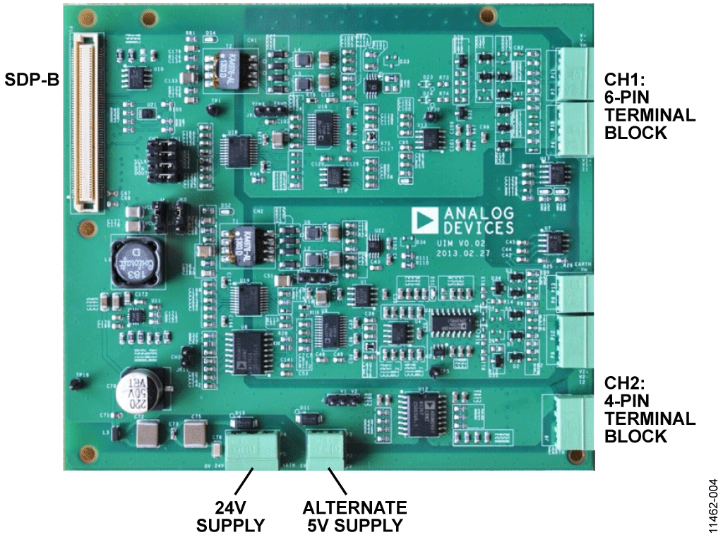

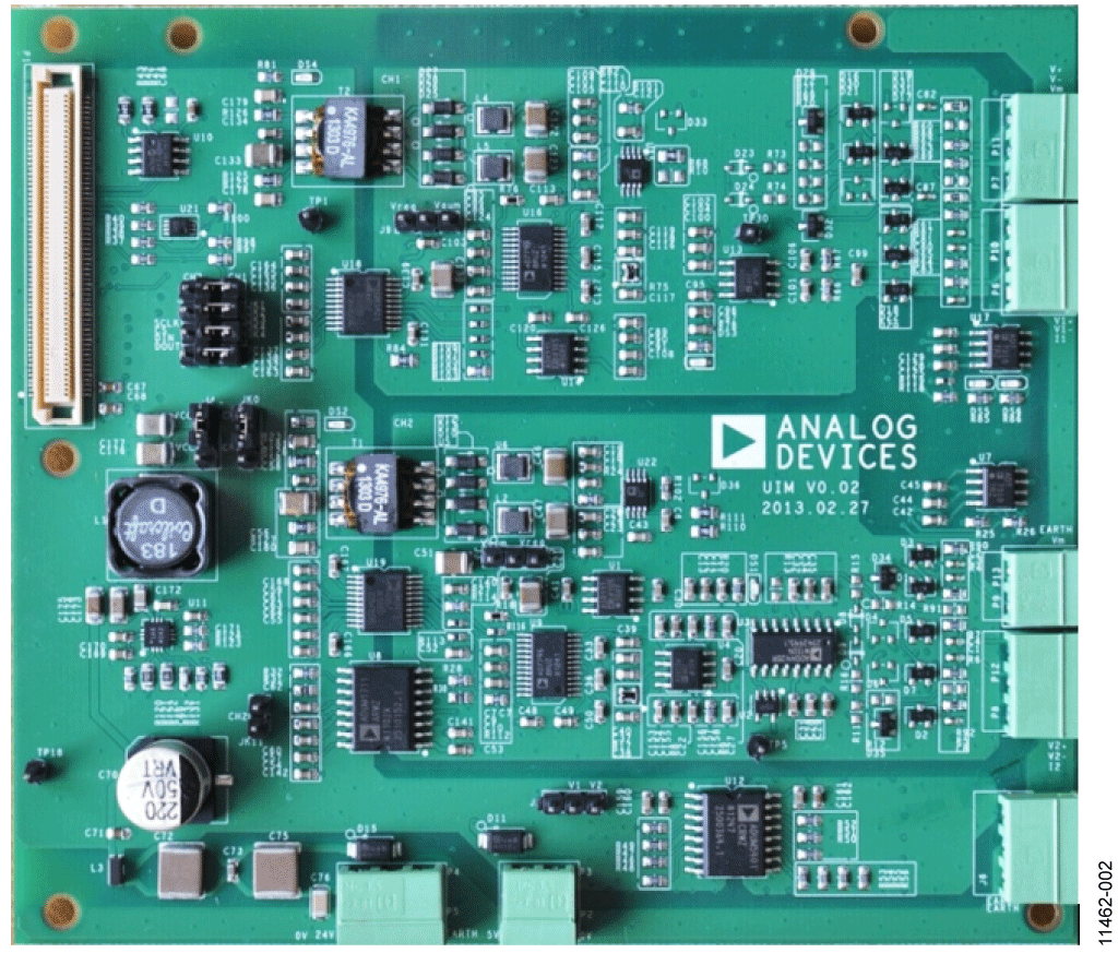

The demo board contains two different fully isolated universal input channels, one with a 4-pin terminal block (CH2) and one with a 6-pin terminal block (CH1). For the 4-pin terminal board (CH2), the voltage, current, thermocouple, and RTD inputs all share the same 4 terminals, minimizing the number of terminal pins required. For the 6-pin terminal board channel (CH1), the voltage and current inputs share one set of 3 terminals, and the thermocouple and RTD inputs share another set of 3 terminals; this requires more terminals but results in lower device count and component cost Also lower. Figure 2 shows a photo of the PCB and Figure 3 shows a detailed schematic of the circuit.
Figure 2. Universal Analog Input Board

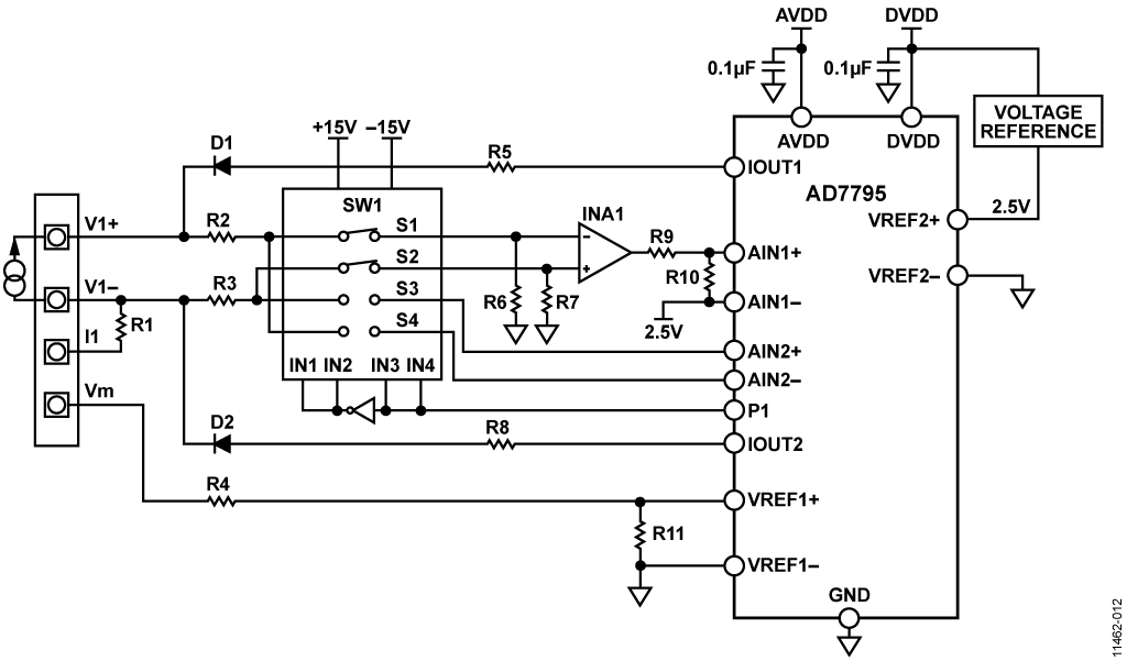

For the 4-pin terminal block channel (CH2), use the ADG442 , low R ON anti-latch-up switch to switch between voltage, current, thermocouple, and RTD input modes.

Figure 2 shows the channel location with a 4-pin terminal block and the channel location with a 6-pin terminal block. Also shown is the location of the 24 V power input.

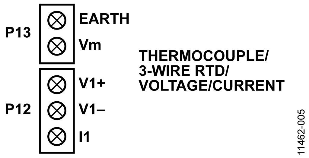

CH2: 4-pin terminal board channel
input connector
Figure 5. CH2 input connector
voltage and current

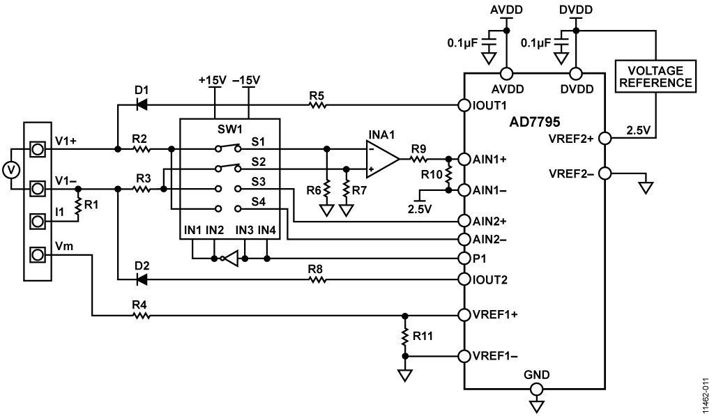

The P12 connector is used for voltage and current input connections. Figures 11 and 12 show simplified schematics of this input connection and configuration. Supported differential input ranges are: 0 V to 5V, 0 V to 10V, ±5V, ±10 V, 0 mA to 20 mA, 4 mA to 20 mA, and ±20 mA. Connect a voltage or current input between V1+ and V1– because a current input will short the V1+ and I1 pins together at the same time. This connects a 249 Ω precision current sense resistor with 0.1% accuracy and a 0.25 W rating.

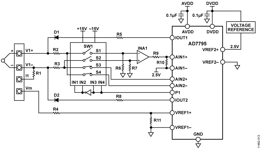

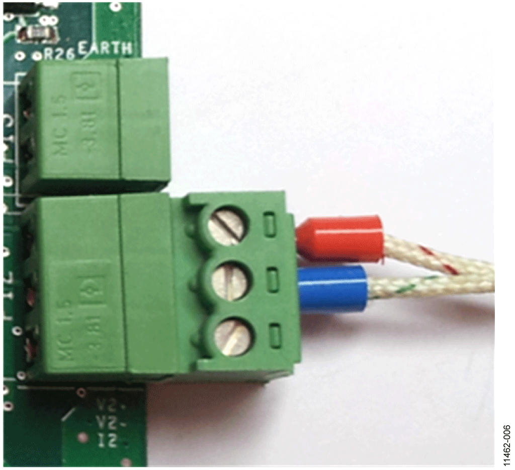

The P12 connector is also used for thermocouple input. Several thermocouple types can be connected, including J, K, T and S. The thermocouple is connected between the V1+ and V1- inputs (Figure 5). Figure 6 below shows how to connect a thermocouple (for example, Type T) to a universal analog input board. A simplified schematic of the thermocouple input is shown in Figure 13.
Figure 6. CH2 Thermocouple Connector

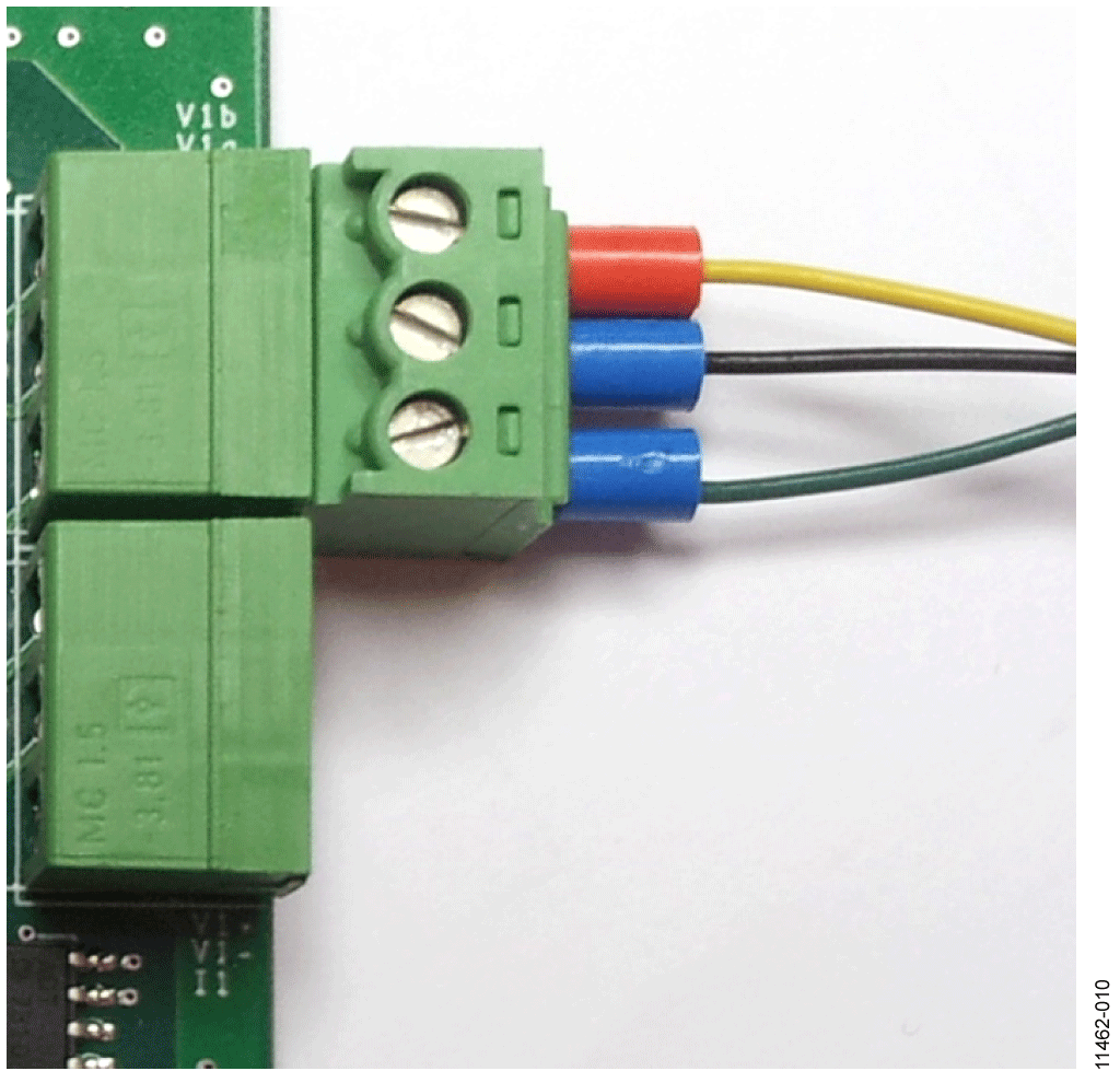

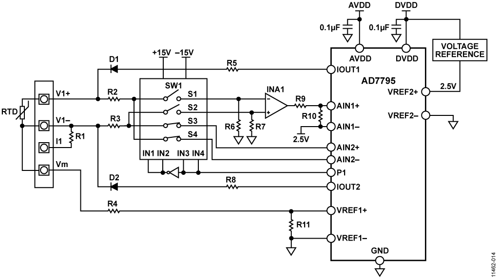

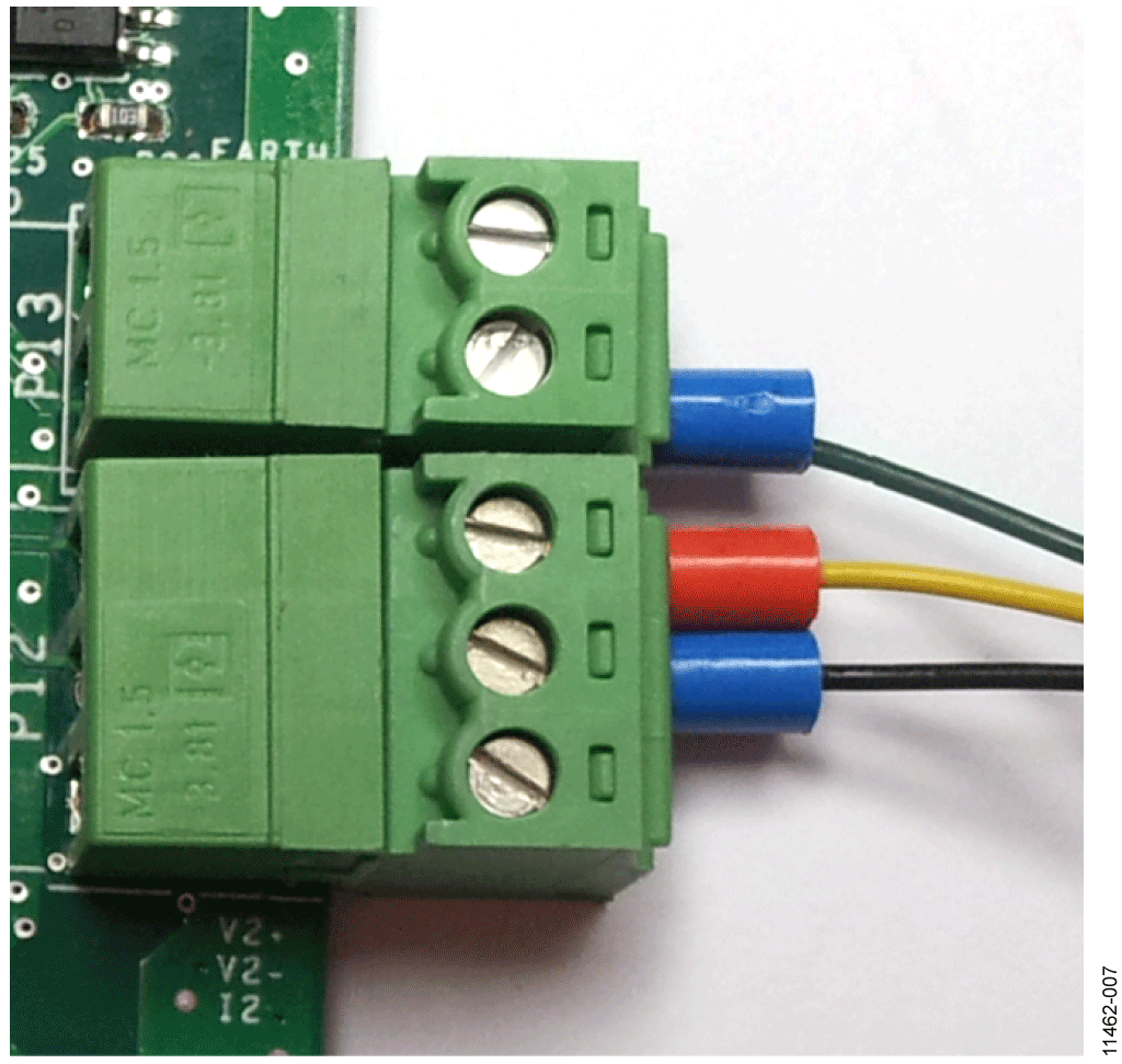

P12, P13 connectors are used for RTD input. The hardware can support 1000 Ω and 100 Ω platinum RTD inputs. For 3-wire mode, the two common wires are connected to V1+ and V1–, and the loop is connected to Vm (see Figure 5). Figure 7 below shows how to connect a 3-wire RTD sensor to a universal analog input board. A simplified schematic of the RTD input is shown in Figure 14.
Figure 7. CH2 RTD Connector

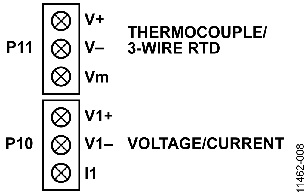

input connector

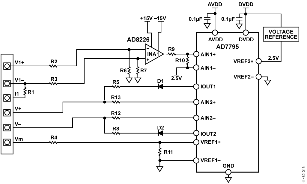

Figure 8. CH1 channel input connector. The simplified input diagram is shown in Figure 13.
voltage and current
The P10 connector is used for voltage and current input connections. Supported differential input ranges are: 0 V to 5 V, 0 V to 10V, ±5V, ±10V, 0 mA to 20 mA, 4 mA to 20mA, and ±20 mA. Connect a voltage or current input between V1+ and V1– (see Figure 13), although for current inputs also short the V1+ and I1 pins together, thus connecting a 249 Ω precision current sense resistor. Accuracy is 0.1% and rating is 0.25 W.

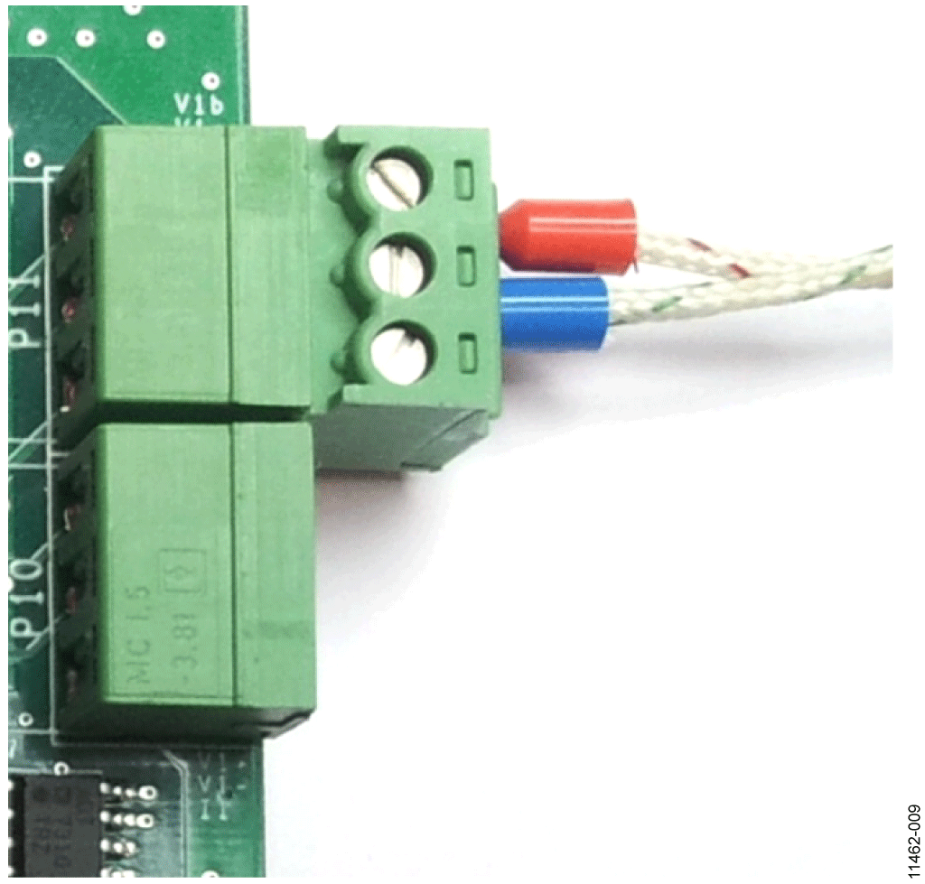

P11 connector is used for thermocouple input. Several thermocouple types can be connected, including J, K, T and S. The thermocouple is connected between the V+ and V- inputs (Figure 8). Figure 9 below shows how to connect a thermocouple (Type T in this case) to a universal analog input board.
Figure 9. CH1 Thermocouple Connector

The P11 connector is also used for RTD input. The hardware can support 1000 Ω and 100 Ω platinum RTD inputs. For 3-wire mode, the two common lines are connected to V+ and V–, and the loop is connected to Vm (see Figure 8). Figure 10 below shows how to connect a 3-wire RTD sensor to a universal analog input board.

Figure 11. CH2 simplified voltage input schematic diagram

Figure 13. Simplified thermocouple input schematic of CH2
Figure 14. CH2 simplified RTD input schematic diagram
Figure 15. Simplified input diagram of CH1
