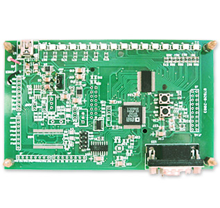

This reference design is based on Analog Devices' ADXL345 and implements a series of typical applications of acceleration sensors, including: pedometer, flash message, hard drive drop protection, human fall protection, inclination measurement, rotation detection, shaking detection, single-click and double-click detection As well as other intelligent detection functions and game control functions, etc.

4. Hardware schematic diagram and PCB layout

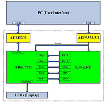

Blockdiagram
