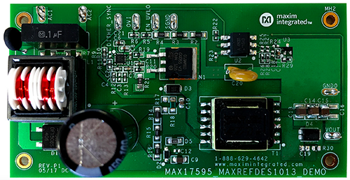

An offline DCM flyback converter using the MAX17595 is demonstrated for a 24V DC output application. The power supply delivers up to 0.5A at 24V.
Designed, Built, Tested
This document describes the hardware shown in Figure 1. It provides a detailed systematic technical guide to designing a synchronous buck using Maxim’s MAX15112 current-mode controller. The power supply has been built and tested, details of which follow later in this document.
