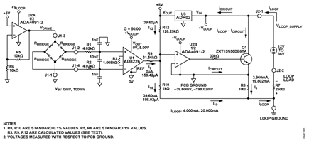

The circuit shown in Figure 1 is a robust and flexible loop-powered current transducer that converts the differential voltage output of a pressure sensor into a 4 mA to 20 mA current output.
The design is optimized for a variety of bridge-type voltage or current-driven pressure sensors, using only four active components and achieving a total unadjusted error of less than 1%. The loop supply voltage range is 12 V to 36 V.
The inputs of this circuit are ESD protected and provide voltage protection above the supply rails, making it ideal for industrial applications.

This design provides a complete 4 mA to 20 mA transmitter pressure sensor detection solution, with the entire circuit powered by the loop. There are three important circuit stages: sensor excitation driver, sensor output amplifier, and voltage-to-current converter.
The total current required by the circuit is 1.82 mA (maximum), as shown in Table 1. Therefore, the bridge can be used to drive pressure sensors with currents up to 2 mA without exceeding the maximum available loop current of 4 mA.

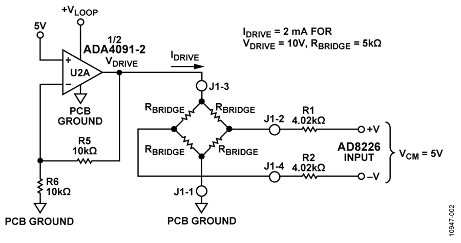

Excitation: Voltage Drive Configuration
Figure 2 shows the voltage drive configuration of S1, which is located on the PCB marked VOLTAGEDRIVE (For the complete circuit layout and schematic, see the CN0289 Design Support Package: http://www.analog.com/CN0289-DesignSupport )
Figure 2. Sensor voltage drive configuration R BRIDGE =5kΩ, V DRIVE = 10V
The voltage drive circuit is usually configured for a 10 V bridge drive voltage. In this mode, the minimum allowed bridge resistance is:
CN0289_image1
For bridge resistances below 5 kΩ, the drive voltage can be reduced to 5 V by removing R6 and using a buffer configuration.
Other values ​​of the driving voltage can be obtained by selecting the appropriate R6 as follows:
CN0289_image2
in:
CN0289_image3
Note that the loop voltage V LOOP should be at least 0.2 V higher than the bridge drive voltage to give U2A enough headroom.
CN0289_image4

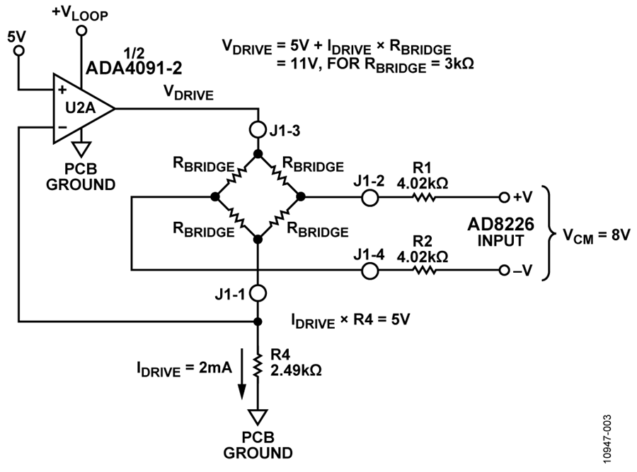

Excitation: Current Drive Configuration
By moving S1 to the position marked CURRENT DRIVE on the PCB, the circuit can be switched to the current drive configuration shown in Figure 3.
Figure 3. Sensor current drive configuration (R BRIDGE = 3 kΩ)
In current drive mode, the maximum allowed bridge drive current of 2 mA must be maintained. The circuit configuration is R4 = 2.49 kΩ and I DRIVE = 2 mA. Use the following equation to select the R4 value to obtain a lower I DRIVE value:
CN0289_image5
The driving voltage V DRIVE can be calculated by the following formula :
CN0295_Image5
The U2A power supply requires 0.2 V headroom, therefore:
CN0289_image7
In Figure 3, R BRIDGE = 3 kΩ, I DRIVE = 2 mA, V DRIVE = 11 V, V LOOP ≥ 11.2 V.
The ADA4091-2 op amp was chosen for this circuit because of its low power consumption (250 μA per amplifier), low offset voltage (250 μV), and rail-to-rail input and output characteristics.

Use the ADR02 5 V reference voltage to set the drive voltage or current of the bridge and set the 4 mA zero-scale offset. Its initial accuracy is 0.1% (Grade A), 0.06% (Grade B), and has 10 μV pp voltage noise. Additionally, it will operate from supply voltages up to 36 V and consume only 1 mA (max), making it ideal for loop-powered applications.
The reference voltage
By forcing a current equal to the sum of the signal component (I 9 ) and the offset component (I 12 ). to flow through R10, an output current of 4 mA to 20 mA is produced. The current I 10 = I 9 + I 12 ) produces a voltage across R10, which is applied to the sensing resistor R10 through U2B and Q1. The current flowing through R8 is 100 times the current flowing through R10. Therefore, the loop current I LOOP can be calculated by the following formula:
CN0289_image19
Choose values ​​for R8 (10 Ω) and R10 (1 kΩ) that allow you to easily obtain 0.1% tolerance.
For the circuit to work properly, the circuit current II CIRCUIT  is generated by the bipolar NPN transistor controlled by the U2B output and the gain should be at least 300 to minimize linearity errors. Its breakdown voltage should be at least 50 V.
Output transistor Q1 is a 50 V NPN power transistor dissipating 1.1 W at 25°C. The circuit has worst-case power dissipation with 20 mA output current into a 0 Ω loop load resistor and a V CC supply of 36 V. Q1 power dissipation under these conditions is 0.68 W.
The supply voltage V LOOP of the drive circuit board depends on the loop supply V LOOP_SUPPLY, the loop load R7 and the loop current I LOOP . The relationship between these values ​​is as follows:
CN0289_image20
For the circuit to operate properly, the supply voltage V LOOP must be greater than 7 V to provide sufficient headroom for the ADR02 reference.
therefore,
CN0289_image21
For 20 mA maximum loop current and R7 = 250 Ω
CN0289_image22
The minimum loop supply voltage also depends on the bridge drive circuit configuration. In the voltage drive mode with V DRIVE = 10 V, the supply voltage V LOOP must be greater than 10.2 V so that U2A can maintain sufficient margin (see Figure 2).
In current drive mode, the supply voltage V LOOP must be greater than 11.2 V so that U2A can maintain sufficient headroom (see Figure 3).
The loop supply voltage is limited to 36 V (maximum).

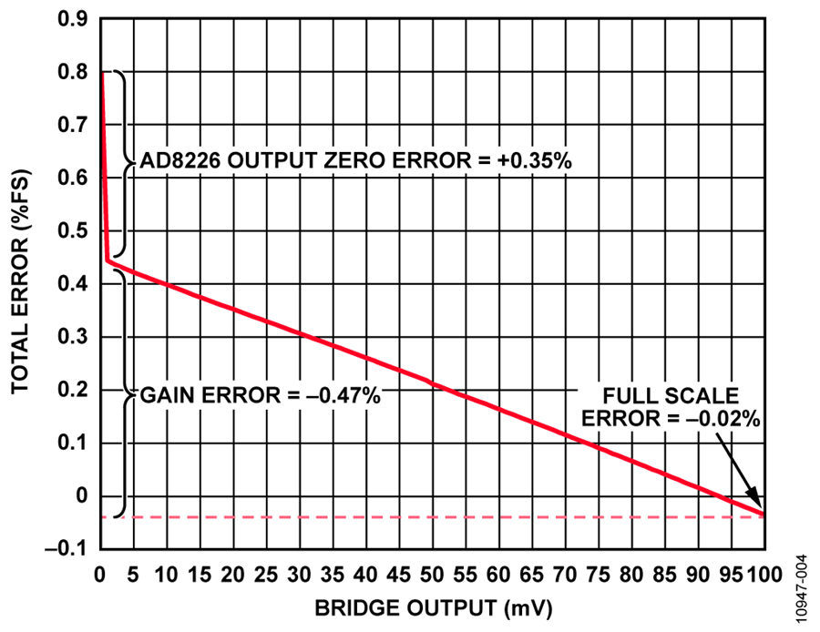

Although the circuit is allowed to have a total error of 1% or less, if better accuracy is required, the circuit needs to have offset and gain adjustment capabilities. For a 4 mA output and zero-scale input, the offset is calibrated by adjusting R12, and then for a full-scale 100 mV input, full scale is adjusted by changing R9. These two adjustments are independent of each other; offset calibration is assumed to occur first.
The actual error data of the circuit is shown in Figure 4. The total output error (%FSR) is calculated by dividing the difference between the ideal and measured output current by the FSR (16 mA) and multiplying the result by 100.
Note that the error between the 0 mV and 1 mV inputs is caused by the AD8226 output stage saturation voltage, and the error range of the circuit under load is 20 mV to 100 mV. All rail-to-rail output stages are limited by their ability to reach the supply rails via saturation voltage (bipolar outputs) or on-resistance (CMOS outputs).
If errors due to the output saturation voltage cause problems, the input signal from the bridge can be biased by connecting an appropriate resistor between the +5 V reference voltage and one side of the bridge output.
Figure 4. Total Error in Output Current (%FSR) vs. Bridge Output (3 kΩ Bridge, 24 V Loop Supply)
