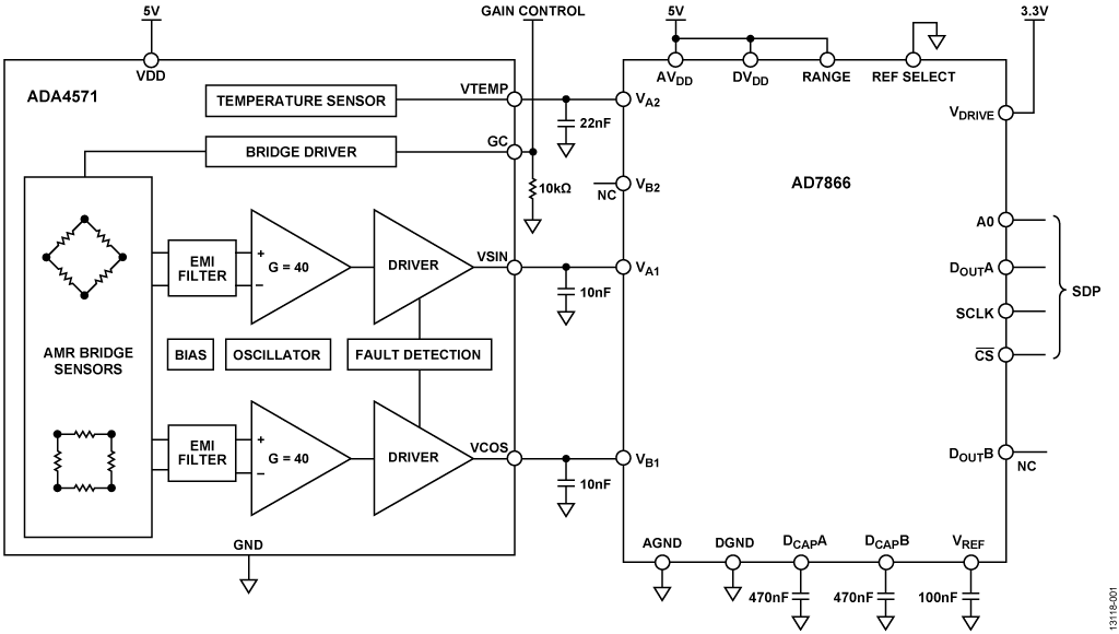

Circuit description
The ADA4571 is an anisotropic magnetoresistive (AMR) sensor that integrates a signal conditioning amplifier and ADC driver, as well as a temperature sensor for temperature compensation. The ADA4571 generates two analog outputs that indicate the angular position of the surrounding magnetic field.
The ADA4571 integrates an AMR sensor and a fixed-gain (nominal G = 40) instrumentation amplifier. The ADA4571 provides clean, amplified cosine and sine output signals related to the angle of a rotating magnetic field. T output voltage range is proportional to the supply voltage.
The sensor contains two permalloy Wheatstone bridges at an angle of 45° to each other. The rotating magnetic field in the xy sensor plane provides two sinusoidal output signals, and the angle (α) between the sensor and the direction of the magnetic field doubles the frequency. Within a homogeneous field in the xy plane, the output signal is independent of the physical position in the z direction (air gap).
The output voltage swing range for the sine and cosine outputs is 7% V DD to 93% V DD . There are two diagnostic bands ( 0% to 7% of VDD and 93% to 100% of VDD ), thus providing wire break detection to all internal connections.
The ADA4571 is available in an 8-pin SOIC package.
The VSIN and VCOS outputs have an output impedance of 50 Ω and form a 318 kHz noise filter with external 10 nF capacitors.
The AD7866 is a dual-channel, simultaneous sampling, 12-bit, 1 MSPS SAR ADC. The polarity of the RANGE pin determines the analog input range and output encoding. If this pin is tied to a logic high when the chip select signal goes low, the analog input range for the next conversion is 0 V to 2 × VREF (0 V to 5 V), which is 0.35 V to 4.65 for the ADA4571 AMR sensor The V signal provides approximately 350 mV headroom.
Tying the REFSEL pin low configures the ADC to use the internal 2.5 V reference. This voltage is available on the V REF pin, but a buffer must be used before it can be used elsewhere in the system. The D CAP A pin and D CAP B pin are decoupled with a 470 nF capacitor to ensure normal operation of the ADC.
The AD7866 simultaneously samples both channels of the sensor. The digital words typically include 1 leading zero per data stream in D OUT A and D OUT B, followed by 3 status bits, plus 12 bits of conversion data. However, by holding the CS pin low for an additional 16 clock cycles, both digital words are available from one channel (D OUT A). Therefore, the SPI interface allows access to two channels on one data line.
The AD7866 has dual channel multiplexers on both ADC inputs. A logic 0 on the A0 input pin allows the A1 and A2 inputs to transition, while a logic 1 on the A0 input pin allows the B1 and B2 inputs to transition. The temperature sensor output of the ADA4571 connects to the B1 input of the AD7866 and allows software temperature calibration of the system.

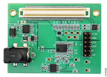

Figure 26. Photo of EVAL-CN0368-SDPZ board
