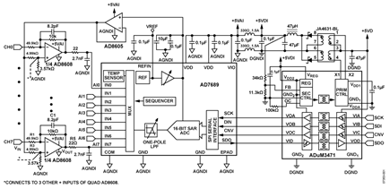

The circuit shown in Figure 1 is a cost-effective, highly integrated 16-bit, 250 kSPS, 8-channel data acquisition system that can digitize ±10 V industrial-grade signals. The circuit also provides 2500 V rms isolation between the measurement circuit and the host controller, and the entire circuit operates from a single isolated PWM-controlled 5 V supply.
Figure 1. 16-bit, 250 KSPS, 8-channel data acquisition system (schematic: all connections and decoupling not shown)
Circuit description
This circuit is used with the 16-bit, 8-channel, 250 kSPS PulSAR ADC AD7689 and two low-cost precision quad AD8608 operational amplifiers to provide all signal conditioning and digitization functions within the data acquisition system. In addition, only the AD8605 operational amplifier is needed to buffer the reference voltage of the AD7689.
The AD8605 and AD8608 are low-cost single and quad rail-to-rail input and output CMOS amplifiers, respectively. The AD8608 inverts, level shifts, and attenuates ±10 V input signals to match the input range of the ADC, which is 0 V to +4.096 V when using a +4.096 V reference and a single +5 V supply. .
The AD8605 is used as an external reference voltage buffer to provide sufficient drive capability for level translation. The AD8605 and AD8608 have extremely low offset voltage, low input voltage and current noise, and wide signal bandwidth, making them suitable for a variety of applications. The AD8608's low current and voltage noise ensures that resistor noise is the dominant contributor to high input impedance output noise. The input impedance in this circuit (equal to R1) is 50 kΩ.
The AD7689 16-bit, 8-channel, 250 kSPS PulSAR ADC contains all the components required for a multi-channel, low-power data acquisition system. It includes a 16-bit SAR ADC, an 8-channel low crosstalk multiplexer, a low-drift reference and buffer, a temperature sensor, an optional single-pole filter, and a channel sequencer. The sequencer can be used to scan channels continuously and does not require a microcontroller or FPGA to control channel switching. The AD7689 is packaged in a small 20-pin, 4 mm × 4 mm LFCSP, minimizing cost and printed circuit board (PCB) area. Operating temperature range is −40°C to +85°C. Power consumption is 12.5 mW (typ) at 250 kSPS from a 5 V supply.
The ADuM3471 is a four-channel digital isolator that integrates a PWM controller and transformer driver to drive an isolated DC/DC converter. The ADuM3471 provides 5 V, 2 W isolated power to the circuit and isolates digital signals at the SPI interface.
Analog front-end design
In process control and industrial automation systems, typical signal levels are up to ±10 V. The circuit in Figure 1 uses an inverting amplifier with attenuation and level shifting to convert the ±10 V signal into a signal suitable for the ADC range.
The circuit formula is as follows:
CN0254_equation1
The front-end signal gain (−R2/R1) is set to −0.2 so that the signal range reaching the ADC is 4 V peak-to-peak. This is consistent with an input range of 0 V to 4.096 V (equal to the reference voltage V REF ).
CN0254_equation2
For an OV input signal, the output of the op amp should be at midscale or 0.5 V REF .
CN0254_equation3
Substituting formula 1 into formula 2, we get
CN0254_equation4
The common-mode voltage at the input of the op amp is calculated by:
CN0254_equation5
For R3/R4 = 1.4 and V REF = 4.096 V, the common-mode voltage of the op amp is 1.7 V.
There are four amplifiers inside each AD8608, and the four non-inverting inputs are shorted together and connected to the resistor divider R3/R4. The second voltage divider is for the second AD8608. To eliminate op amp input bias current,
CN0254_equation6
The input impedance of the circuit is R1, which should ideally be higher. However, resistor thermal noise is proportional to the square root of the resistance, so system noise performance decreases as the resistor value increases. To determine the optimal value, a simple analysis of the noise is required.
According to the Nyquist criterion, the maximum signal frequency content should be less than half the maximum sampling rate. The AD7689 250 kSPS sampling rate produces a Nyquist frequency of 125 kHz. To minimize signal attenuation within this bandwidth, the front-end's −3 dB cutoff frequency is designed to be approximately 12 times the Nyquist frequency, or 1.5 MHz.

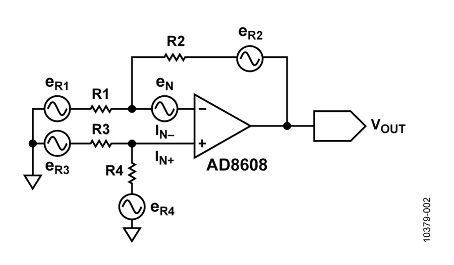

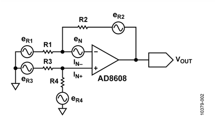

The noise model for this circuit is shown in Figure 2. There are three noise sources in this circuit: resistor noise, amplifier voltage noise, and amplifier current noise. The rms value for each noise source is shown in Table 1. For more information on op amp noise, see application note AN-358 and tutorials MT-047 , MT-048 , and MT-049 .
Figure 2. Noise model for AD8608 inverting configuration.
The total rms noise before the ADC should be less than 0.5 LSB within the target bandwidth so that the ADC can correctly digitize the input signal.

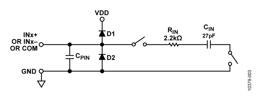

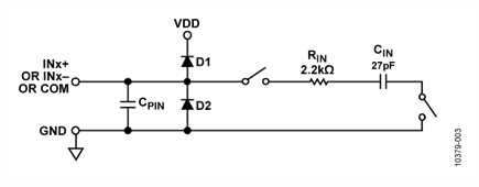

The AD7689 is a modern SAR ADC using an internal switched capacitor DAC. Due to the SAR architecture, there is no pipeline delay during the conversion process, greatly simplifying multiplexing operations. Figure 3 shows the equivalent analog input circuit. A small transient current is injected into the analog input at the sampling frequency, and an external filter network consisting of R5 and C2 reduces its effect on the op amp output. In addition, the filter bandwidth is 2.7 MHz, which reduces noise at the ADC input.
Figure 3. Equivalent analog input circuit of AD7689

The ADuM3471 is a single-chip solution for power and digital I/O isolation. Isolation voltage is 2500 V rms (UL 1577 device approved). The ADuM3471 provides 4 channels of isolated I/O ports and integrates a PWM controller and transformer driver for an isolated DC/DC converter. When used with some external components, the ADuM3471 can provide 2 W of isolated power from any regulated voltage (3 V to 24 V). The necessary external components are a transformer for power transfer, two Schottky diodes for full-wave rectification, an LC filter for ripple suppression and two feedback resistors for setting the output voltage. See the ADuM3471 data sheet and Figure 1 for details.
Layout considerations
The performance of this or any high-speed/high-resolution circuit is highly dependent on proper PCB layout, including but not limited to power supply bypassing, signal routing, and proper power and ground planes. For more information on PCB layout, see Tutorial MT-031 , Tutorial MT-101 , and A Practical Guide to High-Speed ​​Printed Circuit Board Layout (Analog Dialogue) .
For a complete design support package for the CN-0254, including schematics, board layout and BOM, see http://www.analog.com/CN0254-DesignSupport .

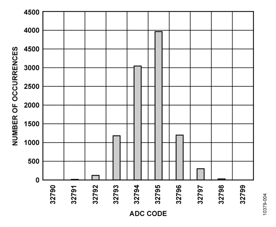

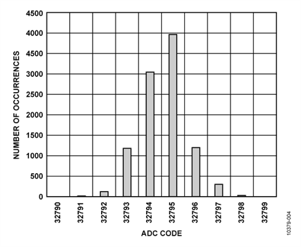

Figure 4 shows a plot of 10,000 ADC code samples (1 second at 1 kSPS) with CH0 to CH7 on the evaluation board terminal strip shorted to GND. Note that 95% of the code is at 4 LSB, with a peak-to-peak distribution of approximately 7 LSB. This corresponds to an rms value of approximately 7 ÷ 6.6 = 1.1 LSB.
Figure 4. Histogram at 0 V DC input, 10,000 samples

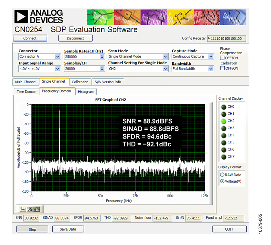

The AC performance is shown in Figure 5. The sampling rate of 250 kSPS is controlled by the system demonstration platform ( EVAL-SDP-CB1Z SDP ), and the digital signal processing including signal windowing and FFT is calculated on the PC through the CN-0254 evaluation software. The input sine waveform is 20 kHz audio, provided by a low-distortion B&K sine generator Type 1051.
Figure 5. FFT at KAISER window (parameter = 20), 20 KHZ input, 250 KSPS sampling rate
