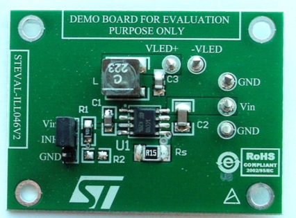

HB LED driver based on ST1CC40 in SO-8 BW package with disable function
STEVAL-ILL046V2
The STEVAL-ILL046V2 evaluation board is based on the ST1CC40, which is an 850 kHz fixed switching frequency monolithic step-down DC-DC converter designed to operate as a precise constant current source with an adjustable current capability of up to 3 A DC.
In closed loop operation, the ST1CC40 feedback pin voltage is 100 mV, thus the sensing resistor calculation is expressed as Rs = 100 mV/ILED.
The STEVAL-ILL046V2 is provided with 660 mA by connecting a 150 mW sensing resistor to the feedback pin.
The overall application size is minimized, thanks to the high switching frequency and ceramic output capacitor compatibility.
The STEVAL-ILL046V2 evaluation board is fully protected against overheating, overcurrent and output short-circuit.
The inhibit mode minimizes the current consumption in standby (6 µA) to maximize battery life in portable devices.
