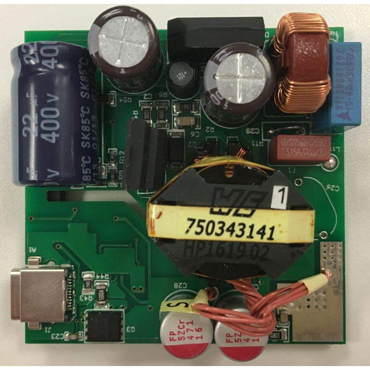

The PMP4489 reference design is a dedicated USB-C PD2.0 DFP 5V/12V 3A output flyback converter featuring the secondary-side regulation UCC28740DR, which provides constant voltage and constant current functionality. This design features less than 75mW standby power consumption (DOE 6 and CoC V5 Level 2 compliant). The secondary voltage and secondary balanced synchronous rectifier UCC24636 achieves high efficiency with maximum SR on-time. The TPS25740 is fully compatible with USB Power Delivery 2.0 providers and Type-C downstream ports (DFP).
characteristic
  • ● High efficiency and good thermal performance
  • ● Compliant with CoC V5 Level 2 2016 standard
  • ● Compatible with USB Power Delivery 2.0 and Type-C
  • ● Eliminates the need for ESD protection circuits on CC1 and CC2
  • ● Small size adapter
